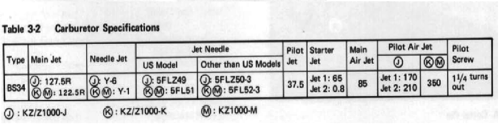

Sorry Dave dont know the answer to youre question. I could not imagine it would run with a 105 main jet. I ream all mine out so it doesnt matter to me whats on the outside and so it may be with the ones you have. But just in case here's the table for jets.
127.5 as standard if its a J and they are J carbs and internals from a UK or European model.
When mine was 1000 and had CV's i used 130 with good success and ultimately 132.5 which was pushing it a bit.
I dont imagine the ST3 would be much bigger than one main jet size up from standard.

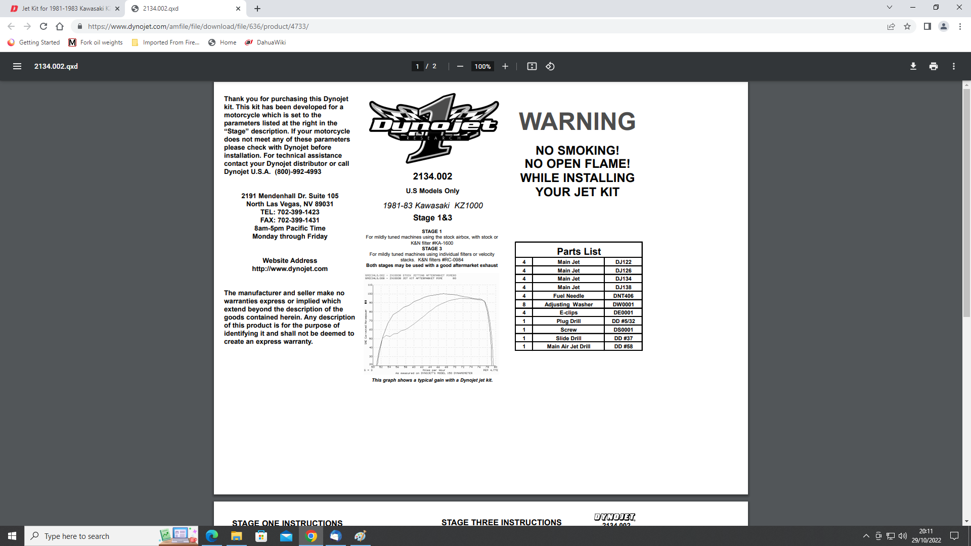

122, 126, 134, and 138 according to the list of parts in the kit.
That looks to me like it was designed to bracket an existing standard main jet which in some cases may still be OK.
