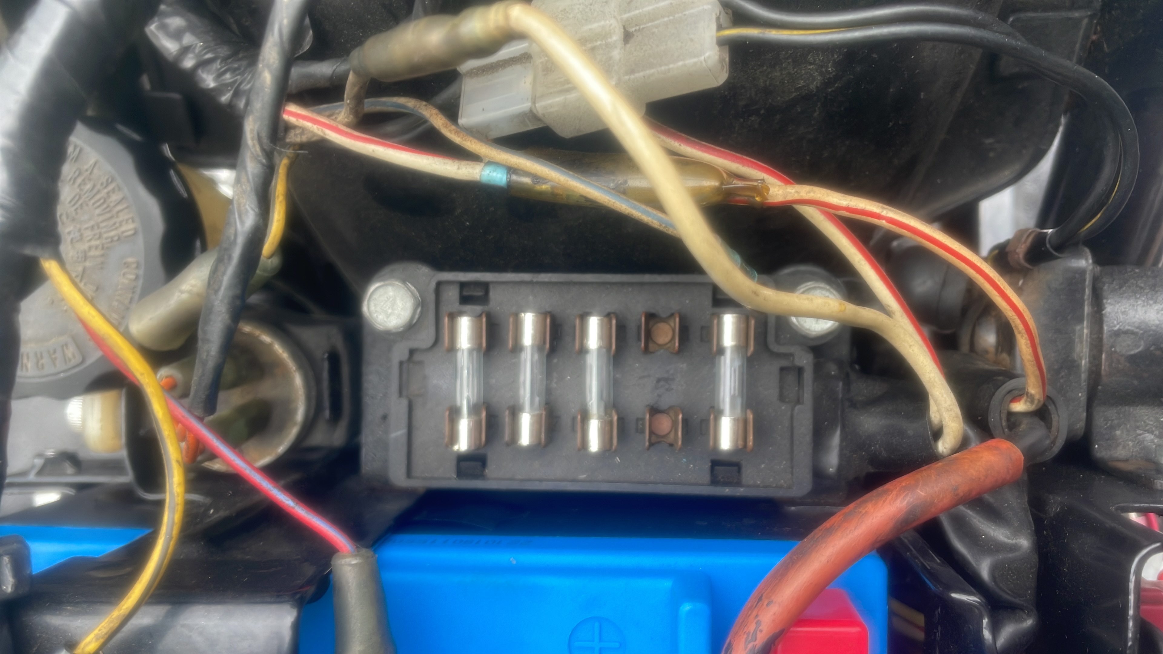

Right !! Problem solved. Was a 10a fuse. All looked ok but when i swapped them around it fired up. Then no lights which previously worked. So new 10a fuse needed & all should be good
