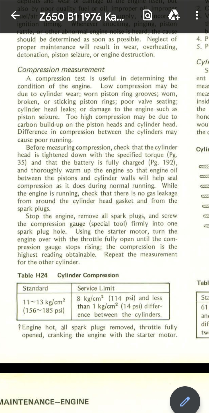

Okay I admit it Ive looked and failed! Where can I find info on what the cylinder pressure/ tolerances should be on a 76 Z650 ~B1.
Took the readings tonight and was pleasantly surprised there was some until I realised I didn’t know what they should be and the Haynes manual is useless on these matters.
