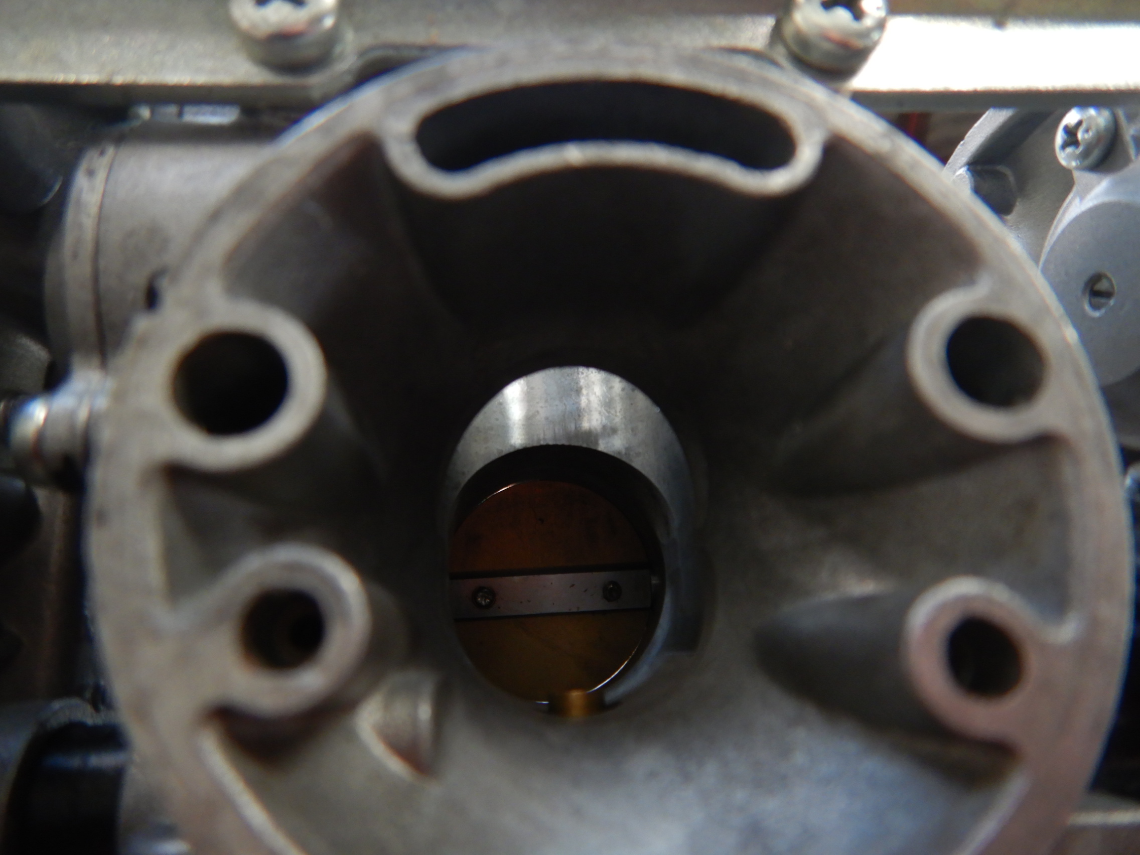

z1bman wrote:yes with the idle screw backed rite of & slack in the cables you should not be able to see any light coming through the butterflies
I over estimated the gap at the top and the bottom. I can barely get the tip of a 0.10 feeler gauge under the butterfly. Although there is a bit of light there is little room under or above any of them. I slackend of the balance screws but the butterfly valves appear to be closed fully. I also lossened the two philips screws on one valve to see if it would seat in better but it didn't budge
What next?

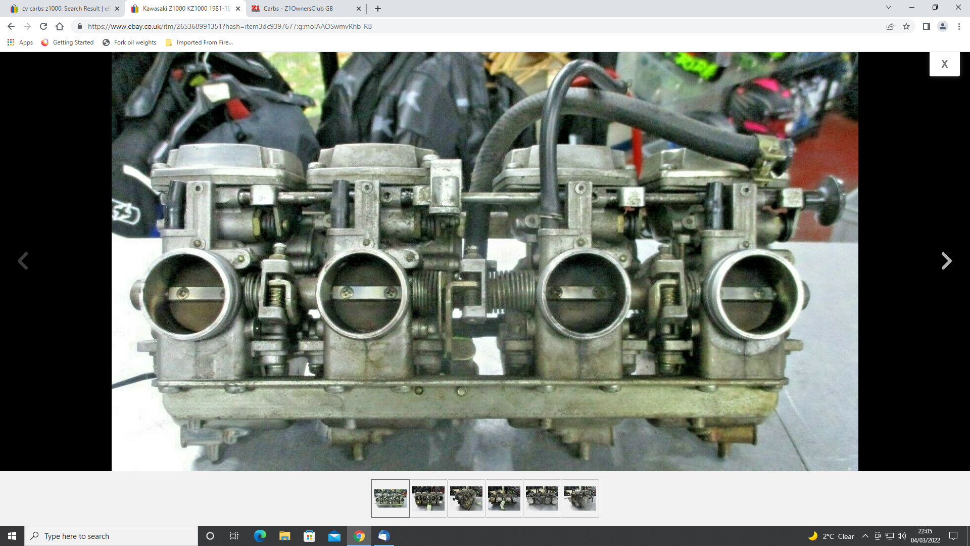

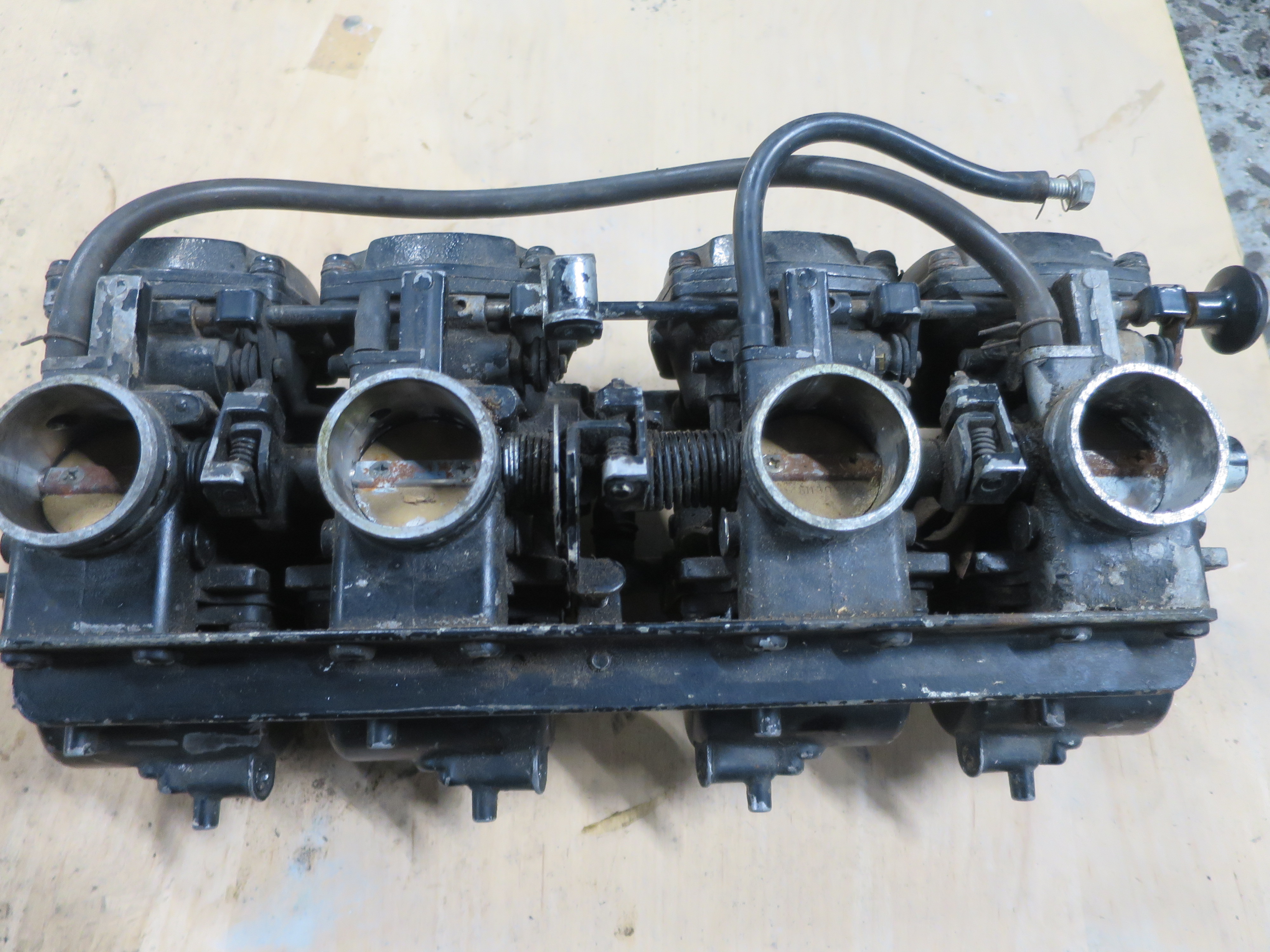

Best i could find as i dont have CV's anymore. These are the same version as yours with the coasting enricheners.
Anything look odd about them or different from yours particularly the resting angle of the butterflys' operating arms when the butterfly valves are fully closed?

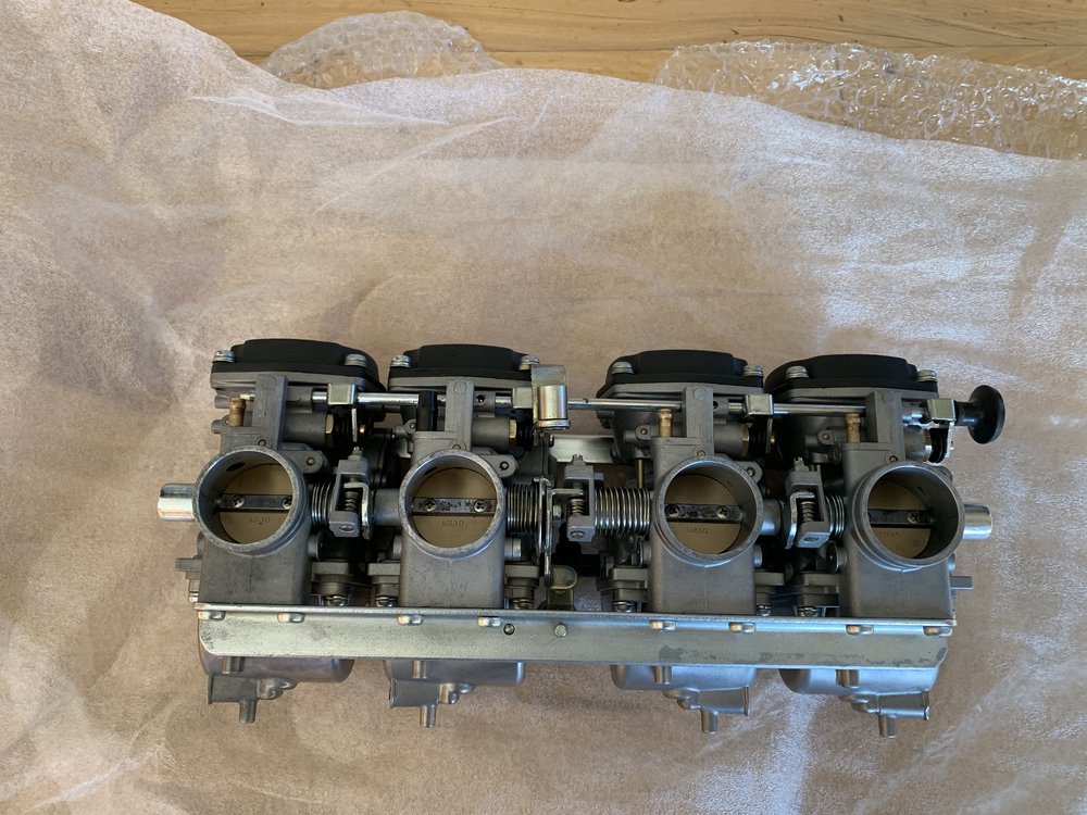

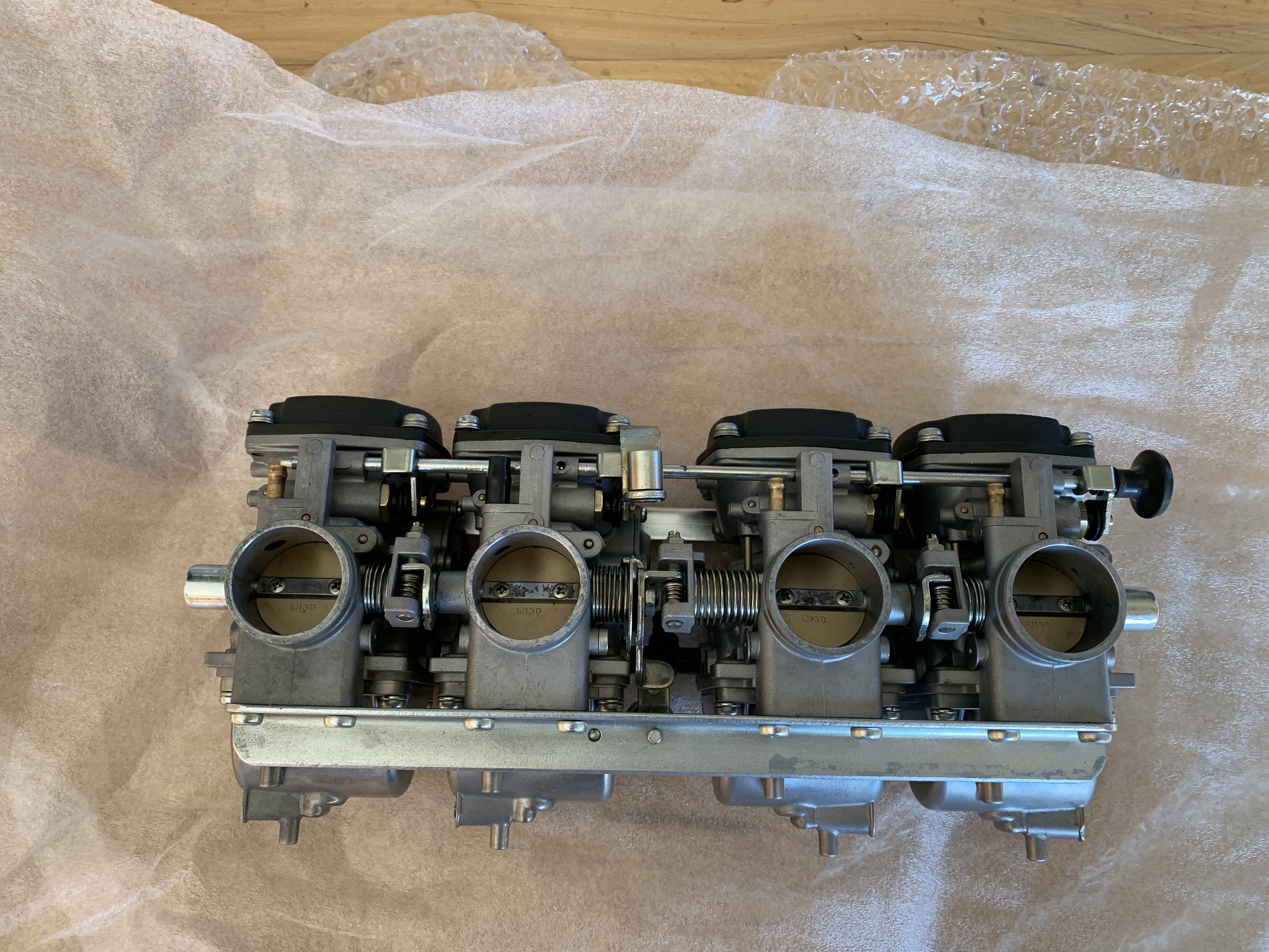

Hi Al,
Here are pictures before and after. I can't see any obvious difference with the picture you posted. However I did note when rumaging to post these that while the circlip is fitted to the second last hole on the needle now, it was on the third last hole before cleaning. I never fettled with carbs before other than idle speed or cleaning after dirt. The high revs and white smoke had me thinking that jetting was way off, but TBH I haven't a clue. While the correct groove would make a difference could it be this obvious? Am I correct in thinking that raising the circlip would drop the needle, reducing fuel??

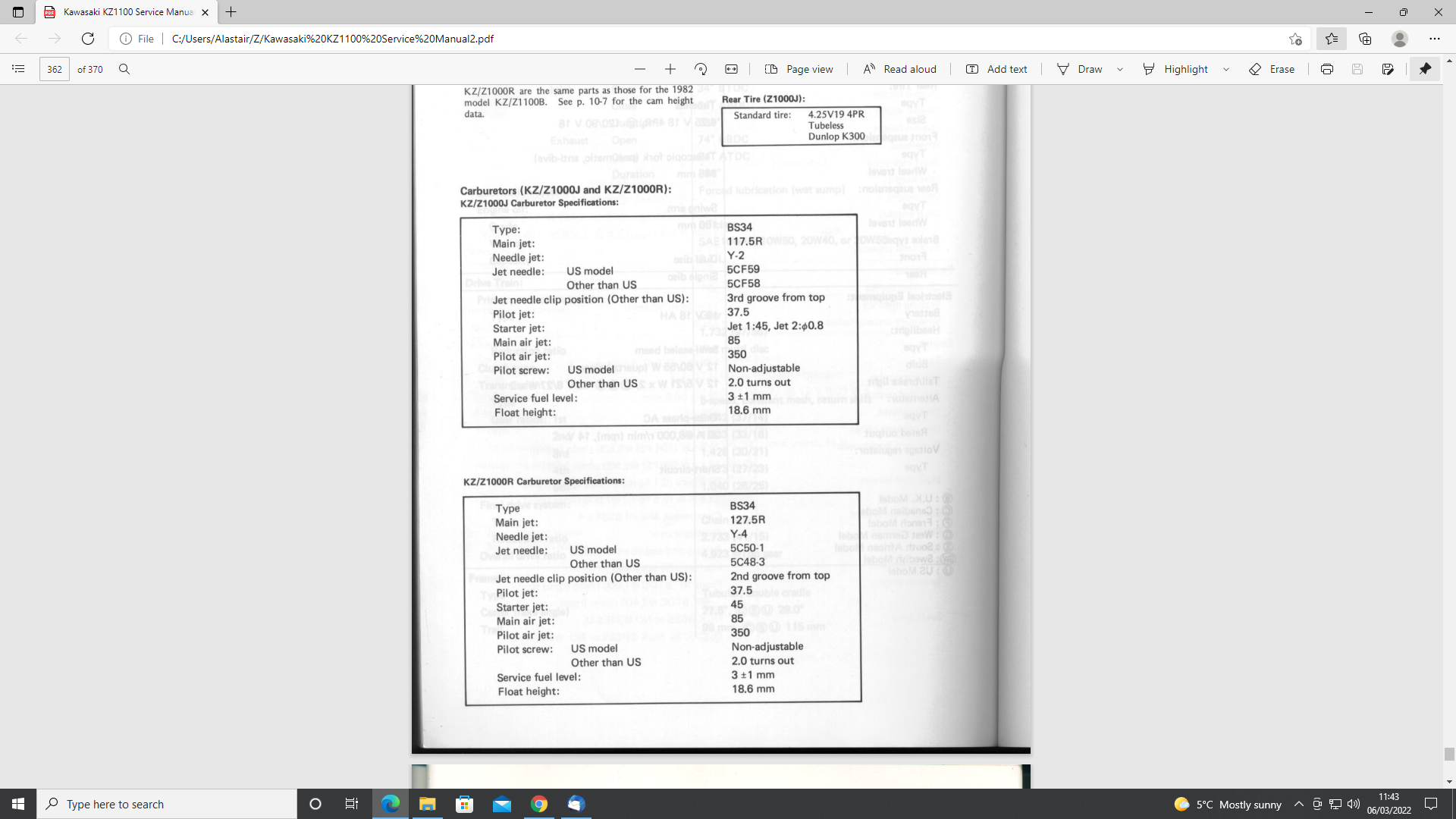

Manual says; circlip on second groove from the top for non USA bikes, but this wont explain youre issues as one clip movement might make a few hundred revs change at best and is a mixture thing not a revs thing at well above idle.

Looking at the last two pics you posted its clear that someone has had a fiddle at some point as the float bowls were on left to right backwards before you sent them away.
It may be an optical illusion but from memory; when you are adjusting the balance screws, i seem to remember getting 'straight on ~ in line' access to the screw slots with a screwdriver from above with the carbs mounted to the head. Yours look to be canted backward and were like it before you sent them away. It suggests that something is not right there but was like it before hand.

There are seven grooves on my needle, The previous setting was third from the bottom, They are now 2 from bottom, If the book says 2 from the top that is four grooves out?

It does appear that the butterflies are not closing fully. Does anyone know if the butterflies should be vertical in the closed position? At present and before I sent them off they were perhaps 10-15 deg off vertical in the closed position and showing light.

I may have alarmed you un-necessarily because i assumed that the jet needles had 5 grooves as mine did. would be worth checking if yours are the correct ones though.
The butterfly's wont close to vertical but they should close completely.
