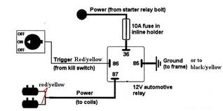

try this ... it has its critics and followers , what do you have to lose

Modifying the coil feed does look tempting at the minute, but I'll persist a little bit longer before I go pulling out the loom...again. The plugs are B8ES, I have read that there are knock off NGK's being sold on the web but I though buying from a motor factors would be a safe bet and as I checked the spark with a champion plug I found on a shelf ( brand new). So it's unlikely to be the plugs but worth a look.
