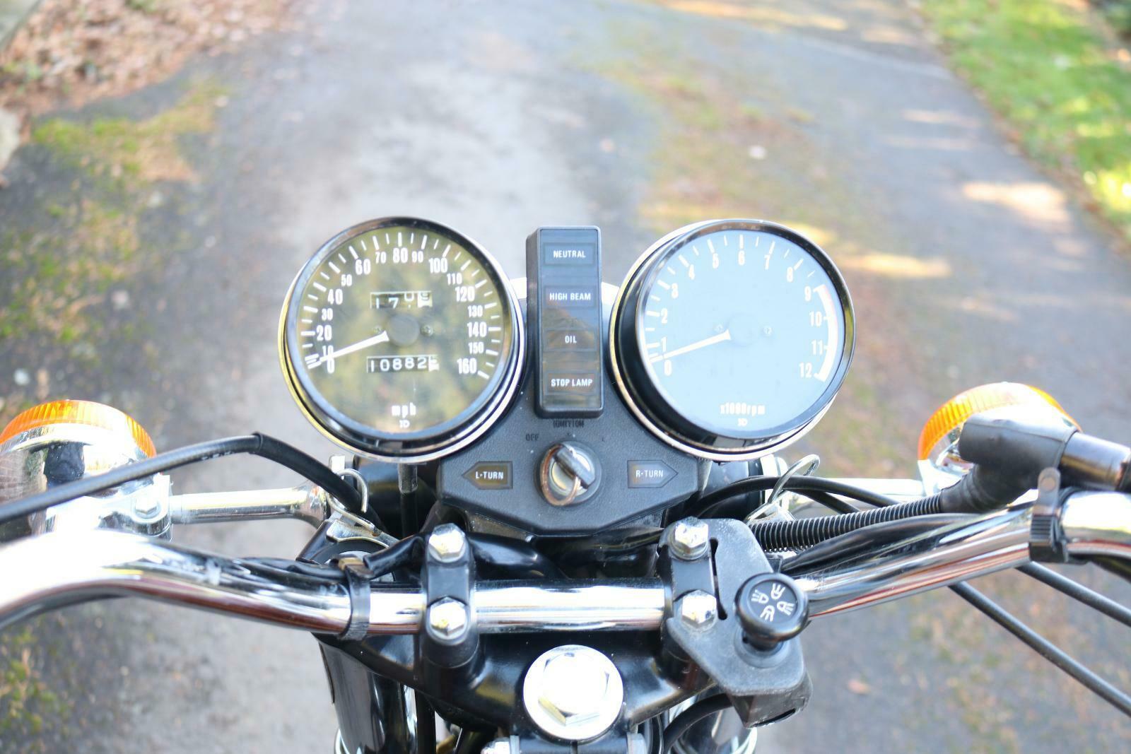

if you mean the actual switch to turn them on

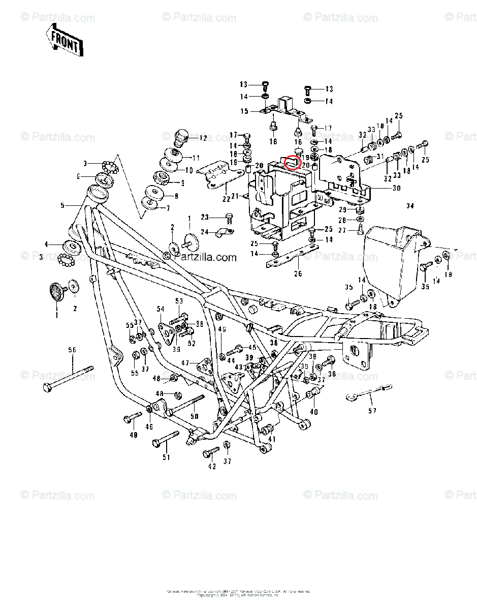

I would say the round rubber support that holds the flasher relay fits over the end of this tang
Gus
"Set the GRINDER on it"
Posts: 4690
Re: Indicator relay switch - KZ900 A4 LTD 1976
#5 PostAuthor: z1bman » Thu Feb 03, 2022 4:31 pm
Gus wrote:I would say the round rubber support that holds the flasher relay fits over the end of this tang
Gus
your bang on there gus

The '76 A4's had two "indicator" relays.
The picture with the circled item on is where the hazard indicator lives & the normal turn indicator relay lives behind the left-hand side panel, just near the seat lock barrel.
