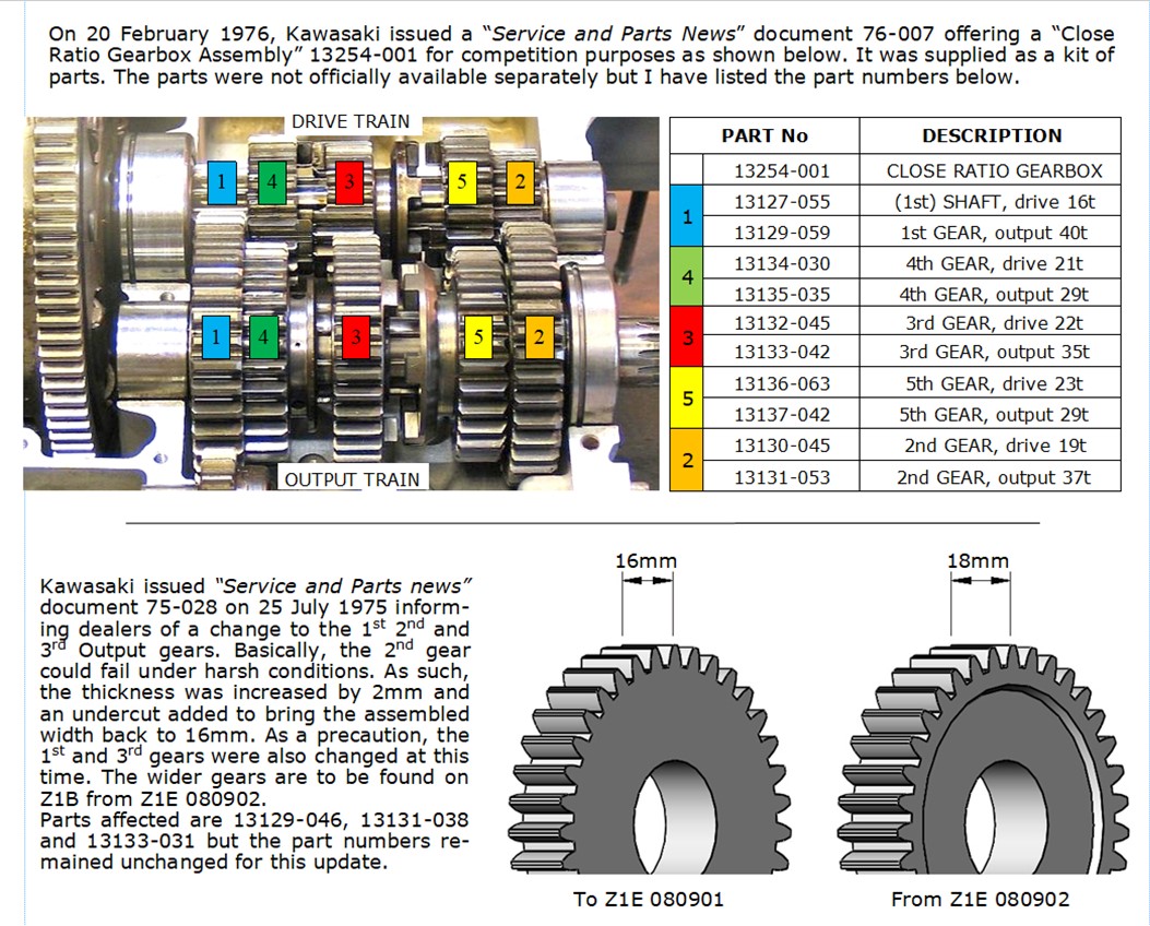

#8 PostAuthor: z2.john » Wed Feb 02, 2022 11:09 am
13131-053 is the 2nd output gear used on the close ratio Z1 gearbox. It is 37 teeth
This might help

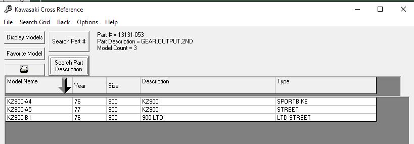

#10 PostAuthor: tim.25 » Wed Feb 02, 2022 4:38 pm
z2.john wrote:13131-053 is the 2nd output gear used on the close ratio Z1 gearbox. It is 37 teeth
This might help
Very helpfull indeed, this explains why Vintage Kawasaki have it listed as Kz900.
Great knowledge, didn't know that
Glad you cleared that confusion up
