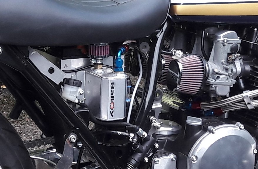

Hi Paul, my experience was the rear mounting for the Z900 is not exactly in the correct place for the Z1B style side panels. I found that out after welding and painting had been completed on the frame so I have improvised with home made brackets as shown in the picture, with a welded solution sometime in the future. The panels are fine and have now done around 2500 miles without coming off. Photo of right hand side arrangement for reference.

Rear mounts on both sides are different and you also have the seat lock on the left hand side.
I ended up removing the lugs on the left hand side panel, making new lugs and refitting them.
