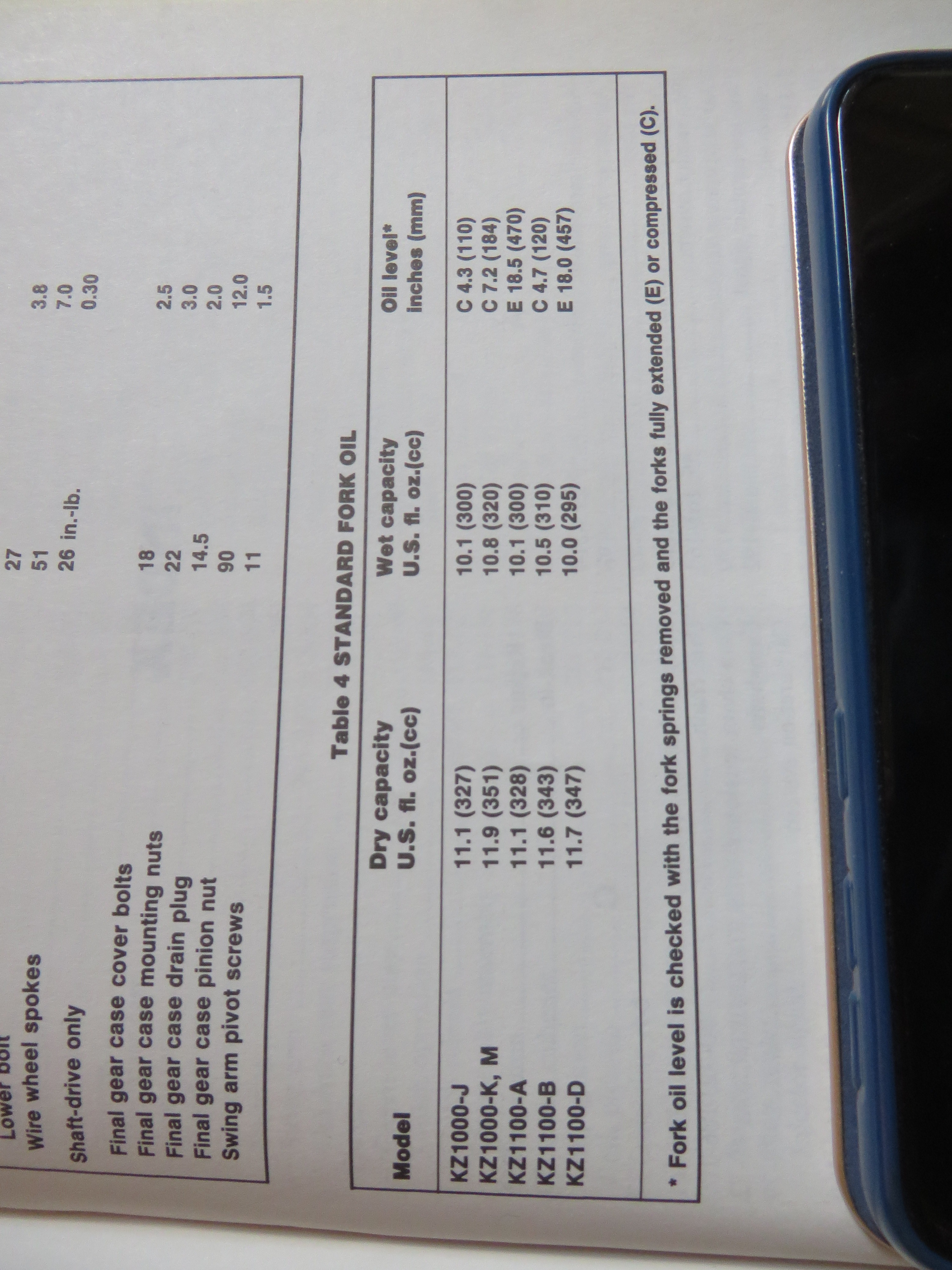

This is the table from the Clymer manual for the model range. It doesn't include the 1100R1 but does list the Unitrak ZX1100 A (KZ1100A) model forks. What is interesting is that it disagrees with the factory manual about the conditions under which the latter is filled with oil. ie. it says; extended here but compressed in the factory manual. Its not unreasonable to assume then that the 1100R1 info in the factory manual may be incorrect.
What is obvious looking at the table is; that those models which should be filled extended have a significantly lower measured oil level for that reason.
This, despite the fact that they all have approx. the same refill quantity, excepting the fact that some are custom models (longer legs) of have extended lower legs (ala Spectre model)
Looks like yours may be hyrdolocked.

I would dis-regard the manual (s) and fill with oil to 120mm air gap with the forks fully compressed and the springs removed regardless of the volume of oil that entails.
This is what others have been doing, partly because filling when extended is misleading due to the rebound spring or springs having an effect on what exactly; fully extended means.
This is likely to mean removing some oil for you, all of which can be done without removing the forks if you have a good way of holding the bike up with a suitable stand.
It might be worth checking the oil seals under the dust covers before you get going. Even if new they may have blown if the pressure went too high!
Once its back on its wheels you can bleed the air pressure out of the valves on the top caps and see how it rides. Tune them in from there if they need more oil or pumping up on the air assist.
