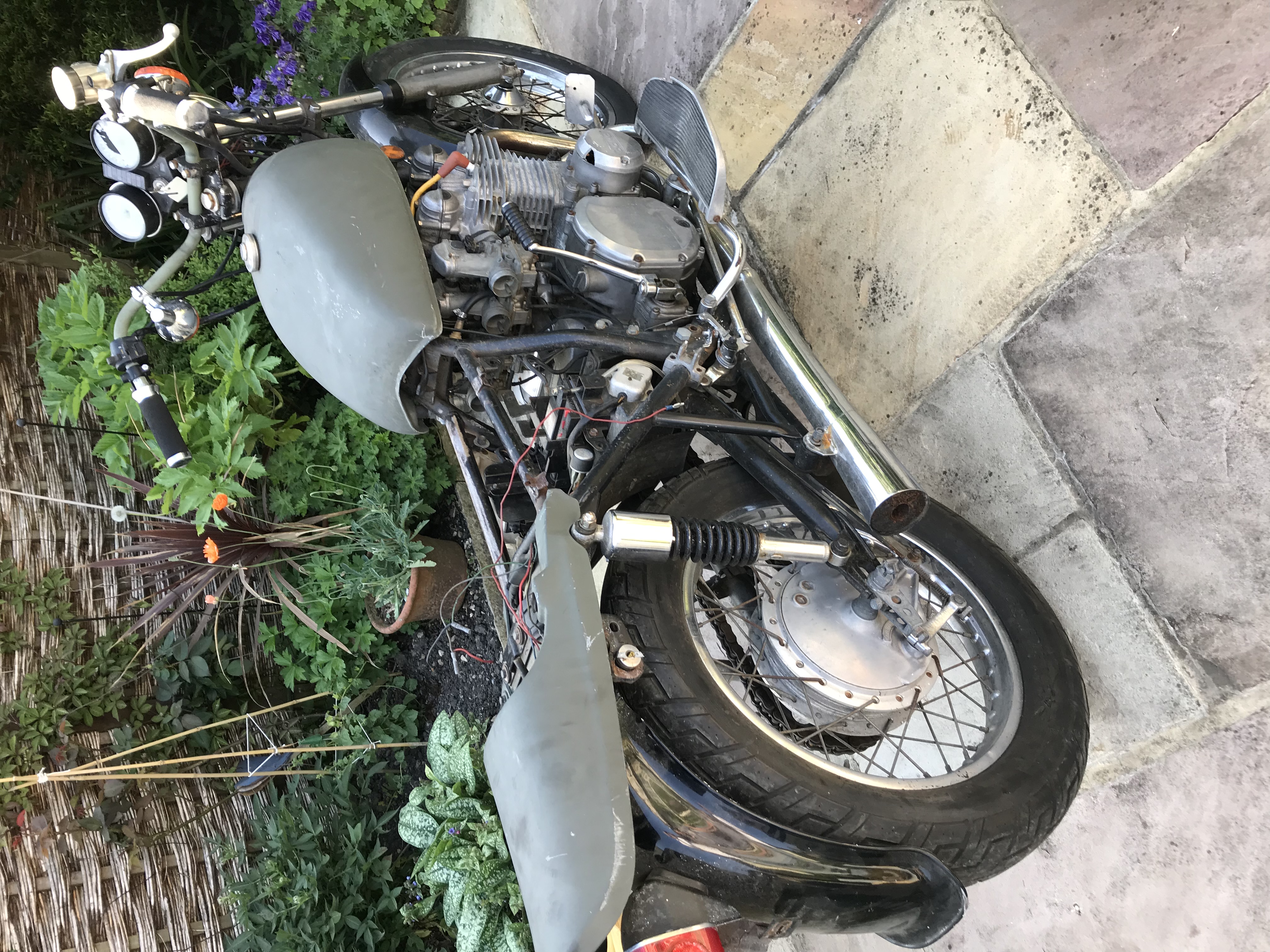

Hi all, I’m fitting a reflector to my long rear mudguard. As there wasn’t one fitted before I don’t know the exact position, I was hoping someone could tell me the hole positions relative to the lower edge of the mudguard.
Thanks hopefully
Nick.

It’s a Kz900c ex chips bike, so it had a painted long rear mudguard with no reflector fitted

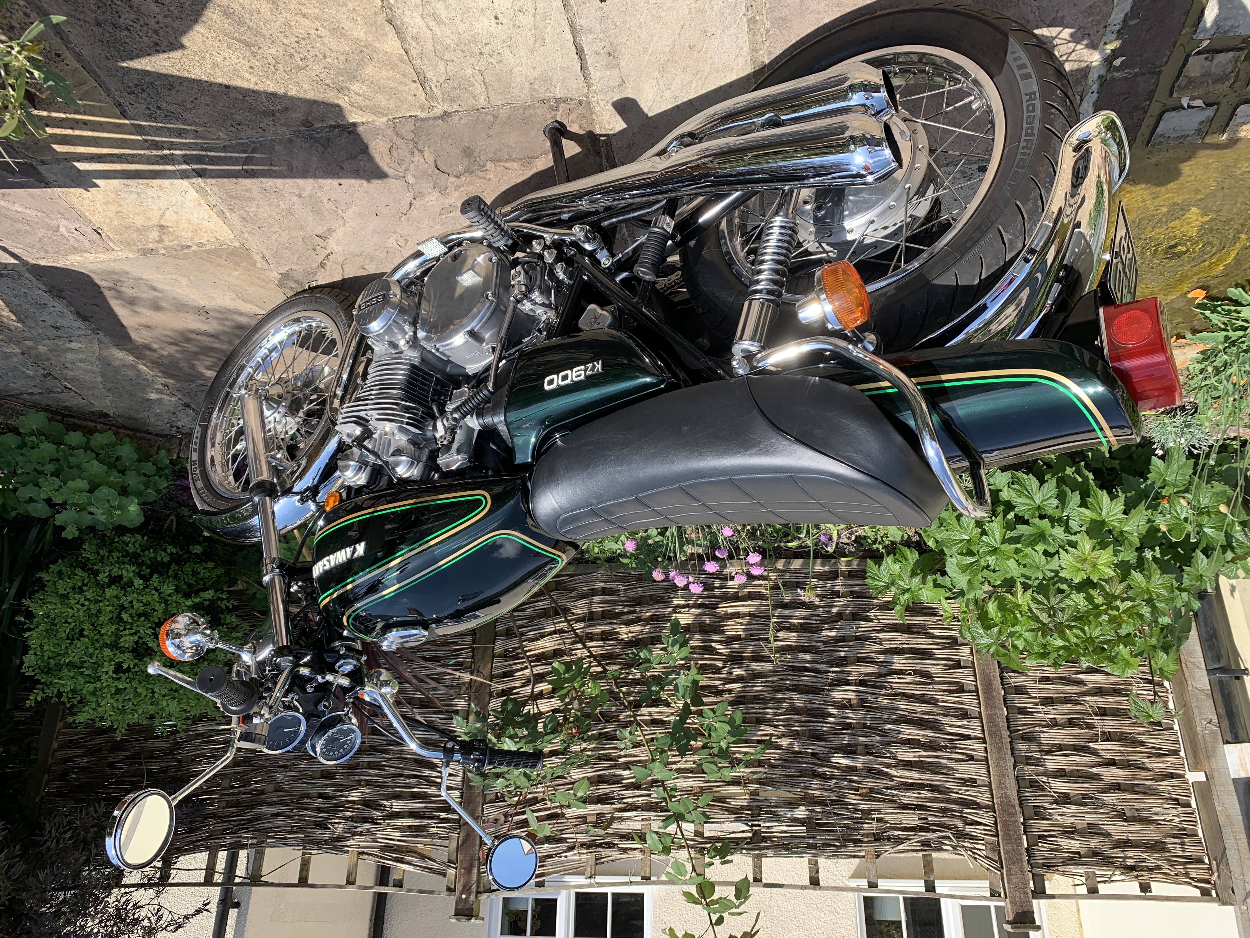

Any help?....

Yes that helps, lovely bike you’ve got there.thanks

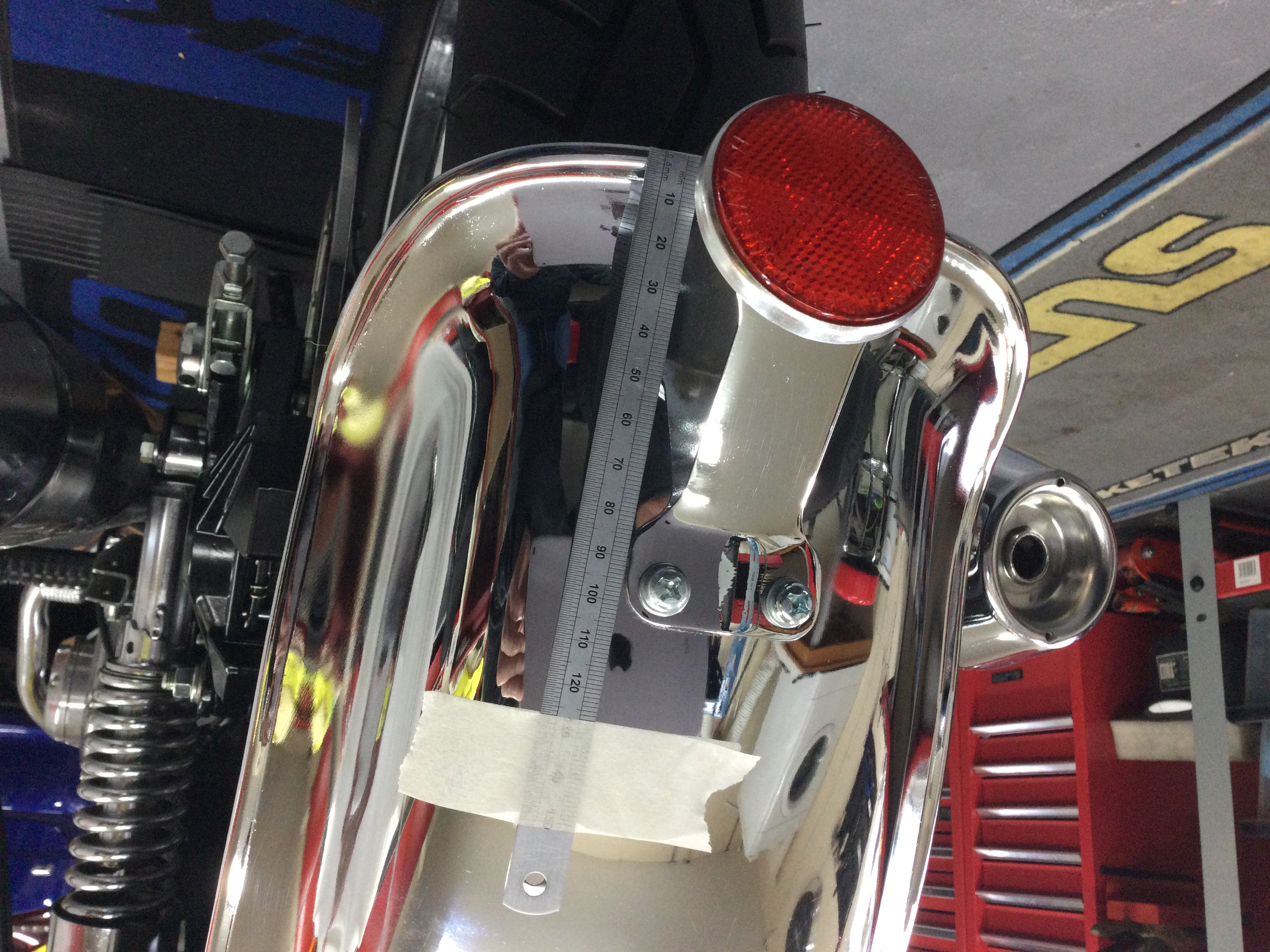

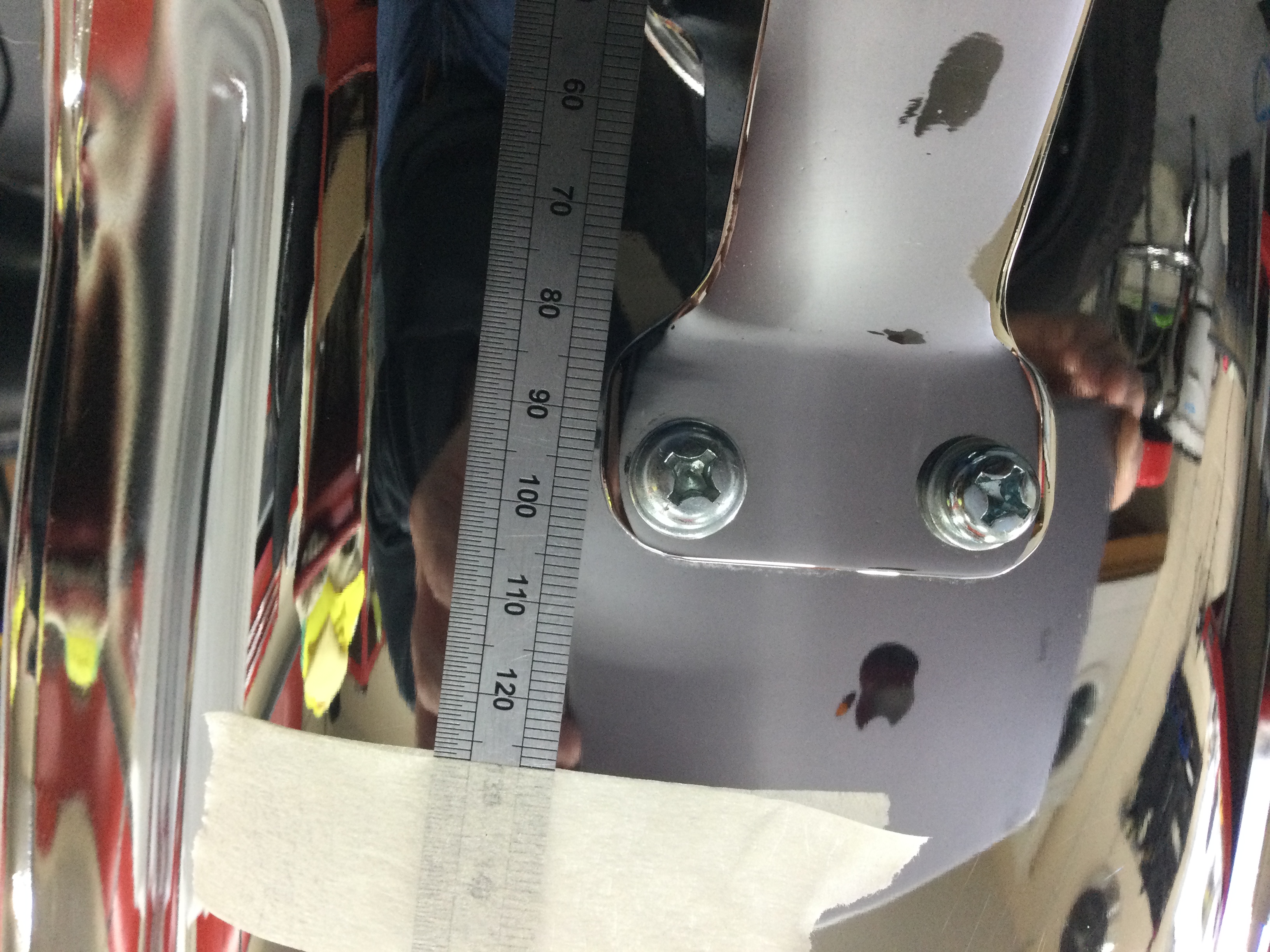

Just measured the reflector bracket on my z1000 long mudguard.
From the bottom lip of the mudguard to the centre of the holes measures approximately 96mm. Hope this helps.
Please see images.

Thanks mjay, that’s exactly what I need.
It’s not an early z1, it’s a ‘76 Kz900c with a wider squared off bottom to match the light shape, so no good for a z1 :rock
