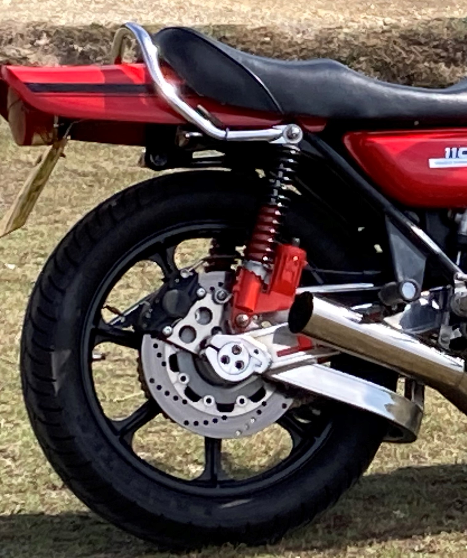

That's a JMC swing arm, have one on my Z1000A2

#4 PostAuthor: ADRIAN H » Wed Dec 09, 2020 3:12 pm
Are the original shocks compatible with it :?:
The shocks fitted on my Z1000A2 are 350mm Marzocchi Stradas (same length and fitting as standard). So the answer is YES.
But you could upgrade to Hagon shocks, KONI's or Ohlins if you wished - just checkthe length and end fittings before you buy.

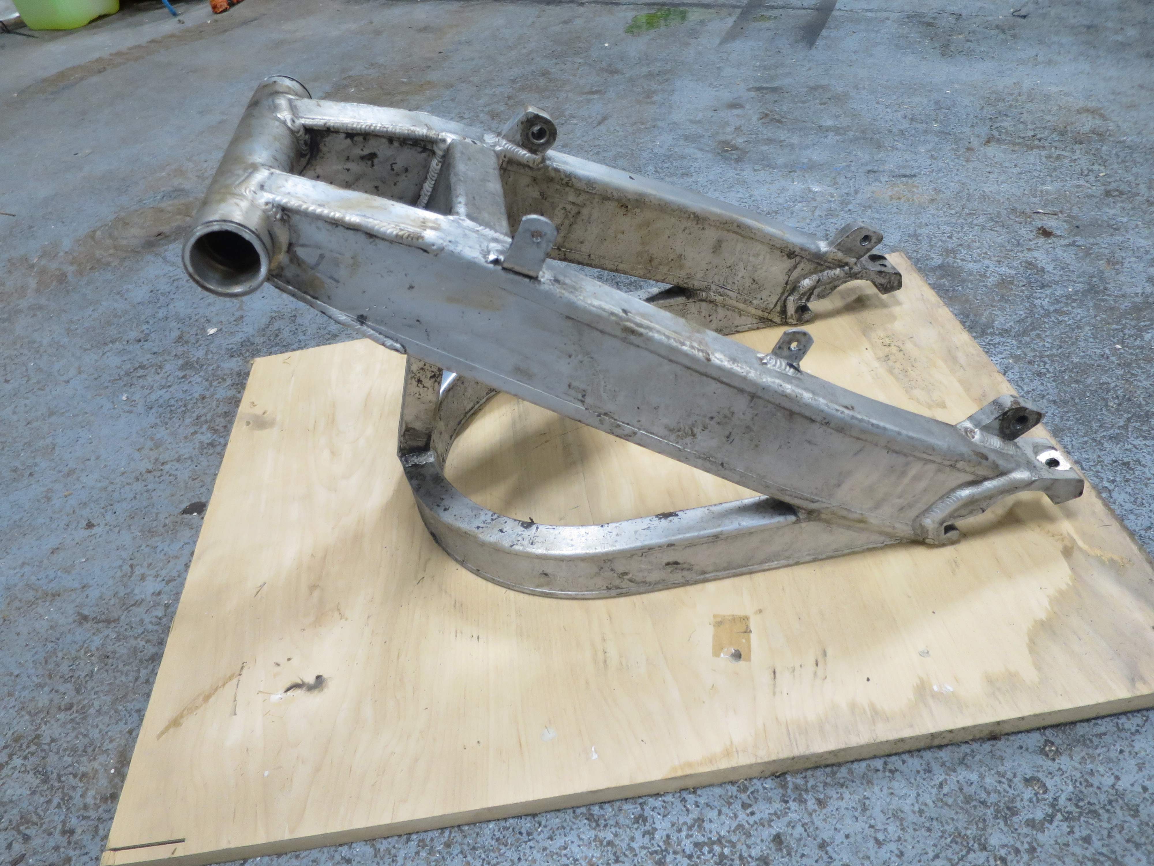

Regarding the Swing arm, I'm get this Vapour blasted along with the casing to tidy it up. I don't expect to be riding on salted roads, but should I treat it with some type of clear coat or (gulp!) send it to be anodized?

#9 PostAuthor: CAT3 » Wed Dec 09, 2020 10:29 pm
If it were me I'd have the arm polished & just keep it polished. It takes more work, but if it's lacqured that can always chip & once water gets under it you'll end up having to polish it anyway ! Espicially if it's not your everyday transport so won't be getting used on salty roads, etc.
The other option would be ceracote, which is supposed to be hard wearing. A lot of people have their engines done with this stuff on an Italian forum I frequent.
I'd avoid anodising as you will most likely get different shades between the alloy box section & the welds, which may well look a bit iffy.
