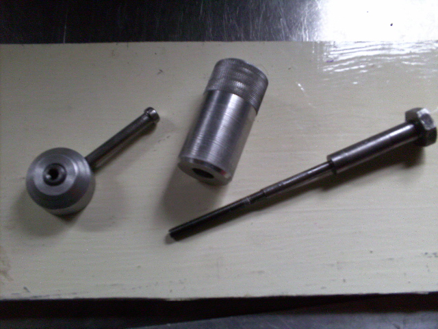

On all but the GPZ1100A Unitrac /Z1100R and some 1100 Spectres that use bathtub heads the valve angles are all the same at 30 degrees.
The Uni motor has a 1 degree steeper exhaust valve.
I personally wouldn't bother faffing with the press for removing the guides as it won't be any better or quicker then drifting them out.
I would however recommend using a self centering draw bar tool that aligns on the seat for fitting new ones like the one I made in the pic.
Much more refined and accurate than drifting them in as they follow the guide bore and the seats rarely need much re-cutting if any to center the valves.

That seems to be an excellent idea for refitting them. I can see some lathing coming soon. As an aircraft trained fellow, belting the crap out of things with a hammer goes against the grain.... That thought has just spurred another idea - I have bought a genuine Kawasaki arbour, but I could machine up an attachment to use with my air hammer for removing the buggers!
I already have an M7 tap; best I buy and M7 die as I guess the puller wants to have the biggest thread that will fit though the guide
