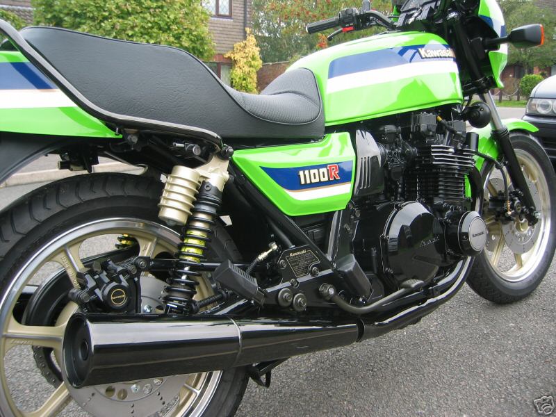

Does anyone know what the bolt nearest the brake pedal secures as per this pic of a standard bike, i found a schematic which shows the original silencer having two mounting holes on its bracket, but it didn't show two sets of bolts securing it.
My ELR with a four into one is missing the forward bolt so I am assuming it is a second securing bolt for the silencer?

Thanks I never looked at that, so the 1100 has two mounting bolts but the 1000 only has one it appears.
my dilemma is I am trying to get a replacement exhaust for the 1100 and the company don't do an exhaust hanger specifically for it, just the 1000R, and I am worried it won't fit at the hanger end!

Bolt positions do look slightly different to the 1000J/R/1100B1/B2 bracket, you could buy a J bracket and paint it black and fit it, they're pretty common and someone on here will probably have one, I gave a pair to RobW as I had no use for them (he's using them btw)

Ive confirmed the company do a J bracket so just going to go for that, hopefully it will be close enough, will post result.

The J bracket is a perfect fit for the Delkevic Z1100R system
