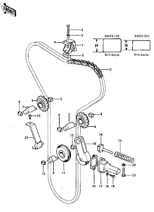

Ok so I decided to drop the sump and cheap out the sludge. Not sure if I’m special but I found this ‘thing’ hanging out with it’s little bits of shrapnel mates. What is it and can I assume it’s not meant to be there [image][image][img][img][/img][/img][/image][/image]

Looks like a piece of cam chain guide to me

Oh dear. What you’ve got there in the bottom part of the cam chain guide that fits in the barrels. Item 22.
It might be left there from a bad rebuild or it might have broken off. Either way, you’re going to want to remove the head and see what you’ve got in your barrels.

So looks like it’s a common fault (one of the only ones) of the Z1 and Z1A.
So my question now is, what is the easiest way to replace the chain guide? Do I have to strip the engine down or is there a shortcut?
