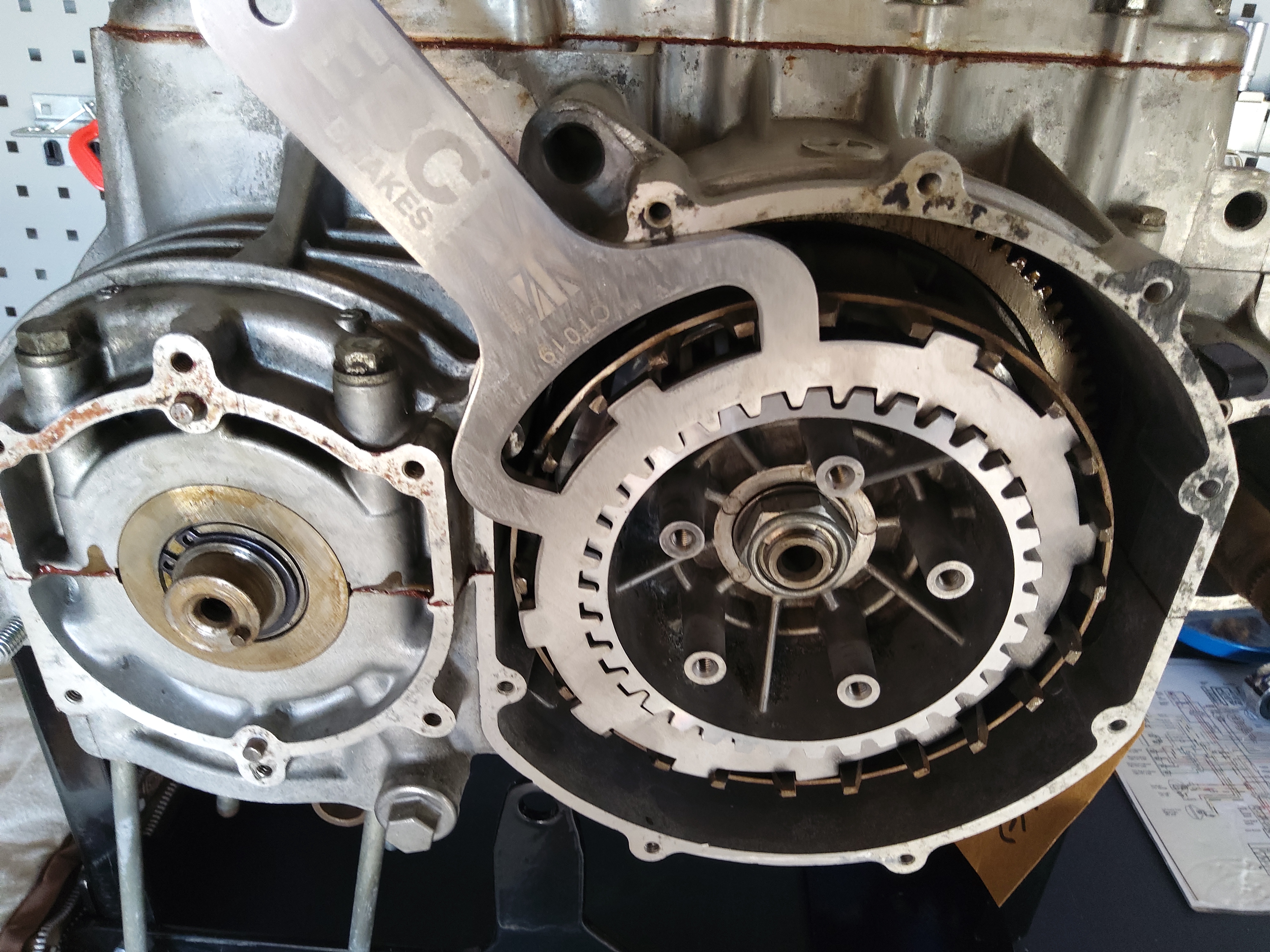

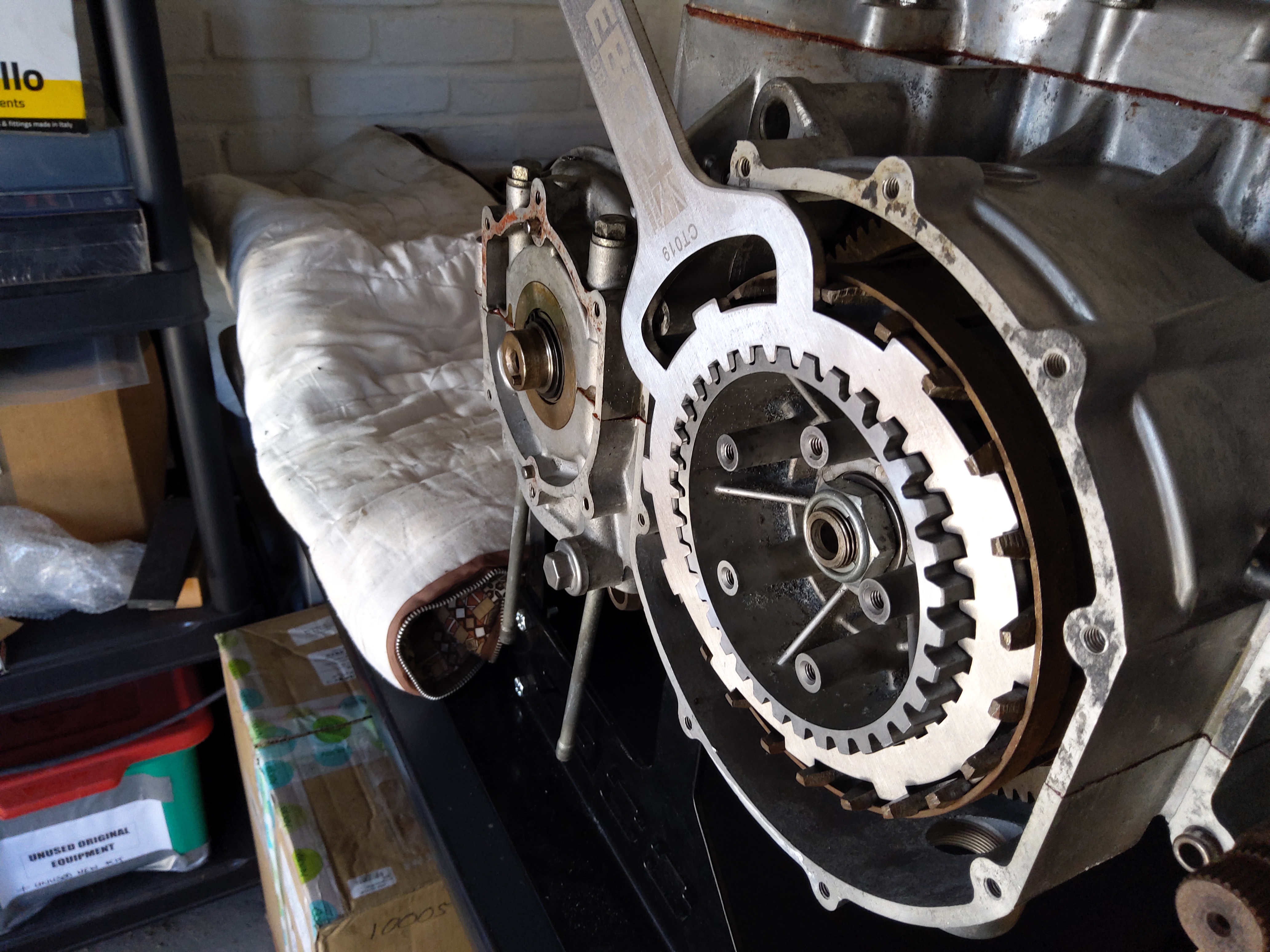

Bought an EBC CT019 clutch holding tool off ebay (biker-fix) a couple of months ago. It was advertised as fitting Z1/Z1-A/Z1-B. I have checked EBC's own website and they quote the same, that it is the recommended tool for the Z1's.
Just starting on the engine rebuild and when I came to the clutch found it doesn't fit due to the fact that the basket is depressed into the casing but the tool is completely flat (see pics). Am I being a numpty here and is there a correct way to use this tool that I haven't figured out or has anyone used the same tool and found a way around it being too flat!
Would really appreciate any advice as it's stopped me dead in my tracks. I'm also going to contact EBC to ask them how they reckon it fits.

I thought about the dog leg route, but it is pretty substantial, looks like hardened steel and is 5.3mm thick.
As for the other tool on ebay, I thought the EBC one looked more substantial at the time. Pity it didn't fit.
I'll get one from Z-Power as their's is only 19.99 and they owe me a free postage.

#7 PostAuthor: steve452 » Tue Jul 21, 2020 9:43 am
Have tried it with most of the EBC tool wedged in and the handle abutted against the edge of the auto-advance housing/crankcase join with a rag wedged in. It worked as far as preventing the clutch basket moving but would the bloody locknut move! Tried heating it up for more than 5 minutes with 2kw heat gun and used a hand impact driver but would not budge a fraction. Next route is to buy an air impact wrench and try that otherwise it''s a cutting job. Anybody got any better ideas for releasing the nut considering it's been in place for about 43 years?

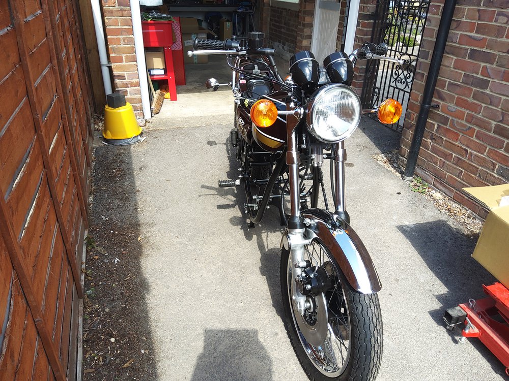

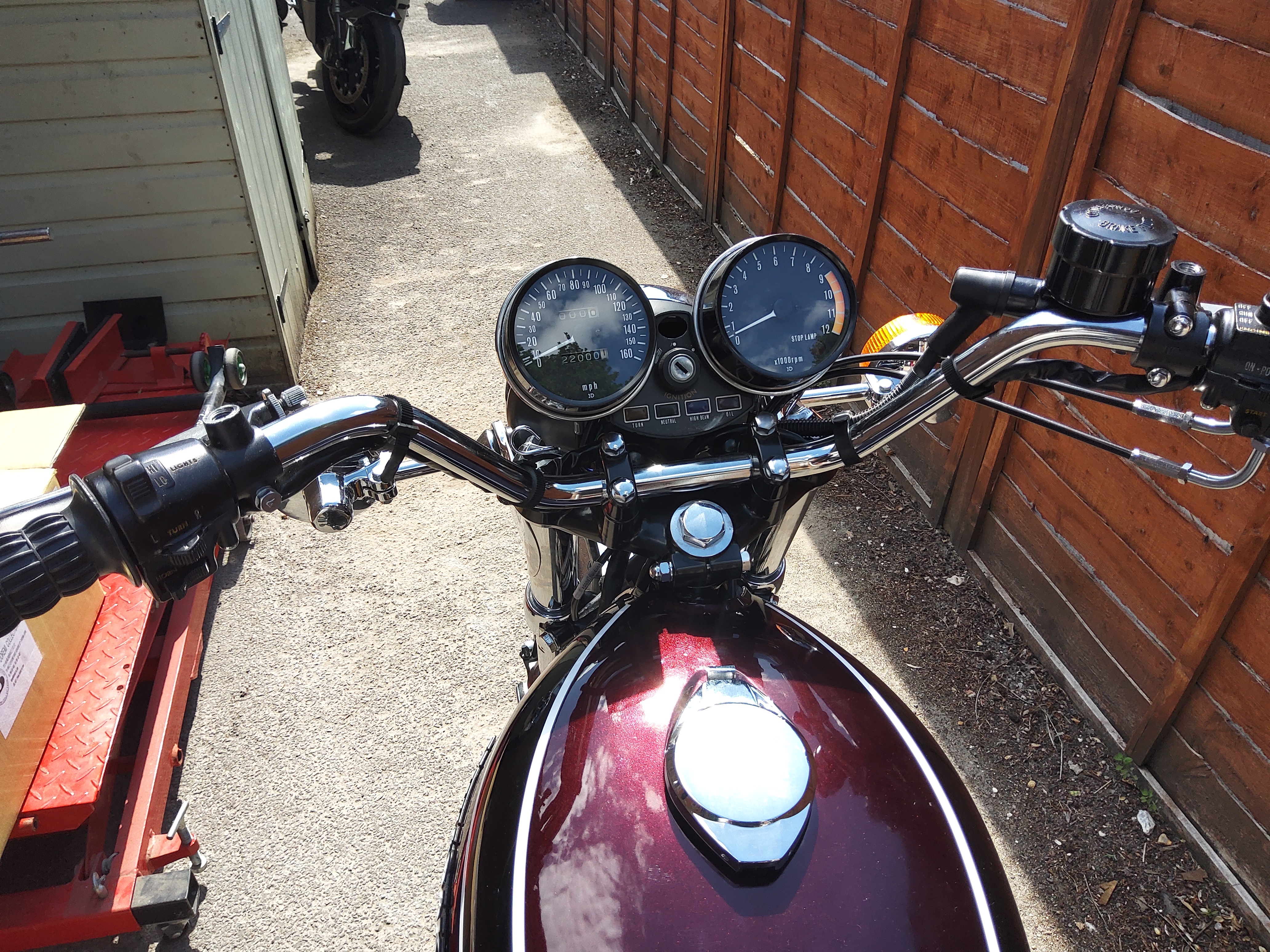

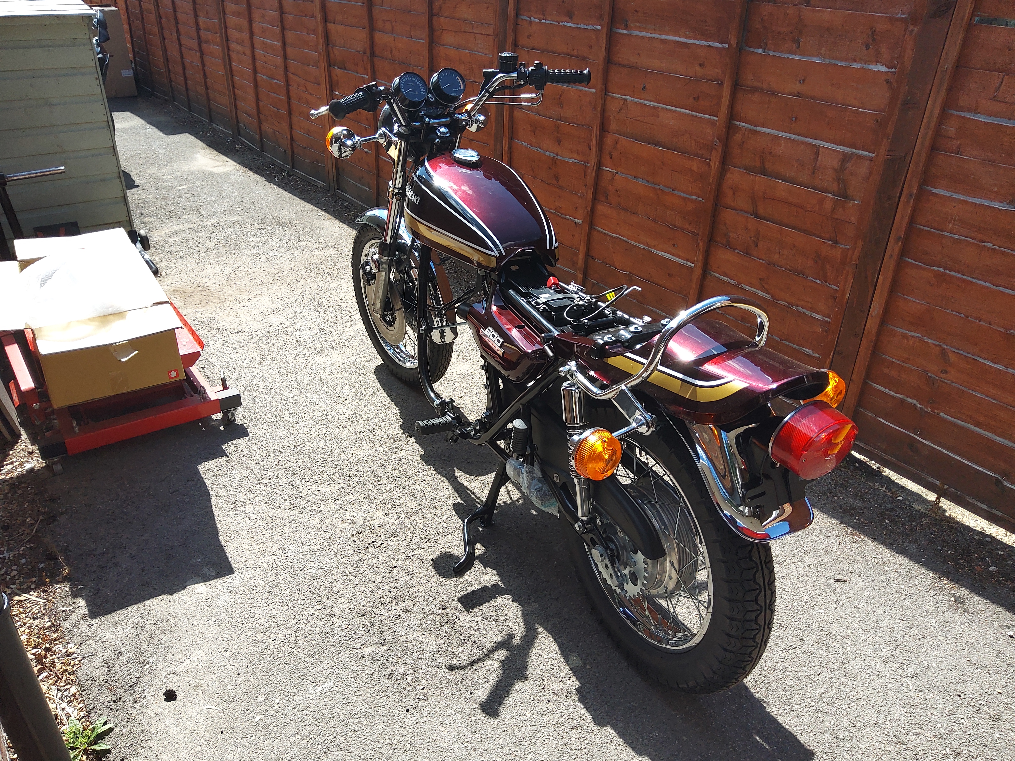

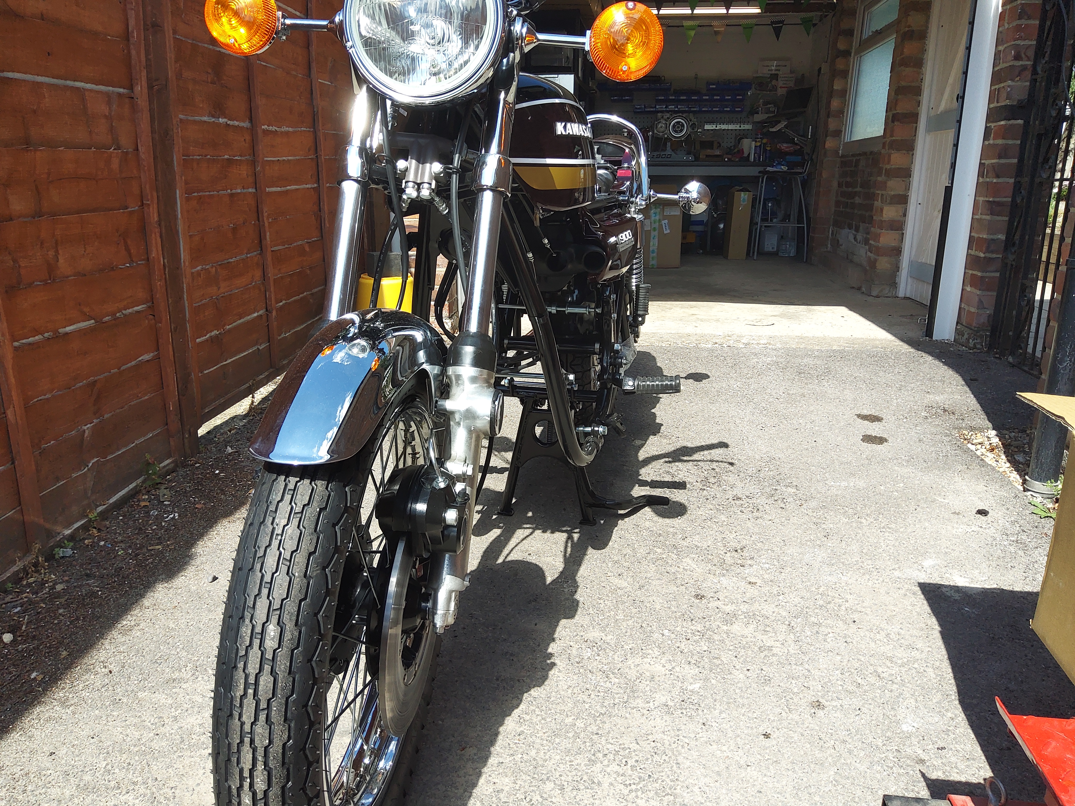

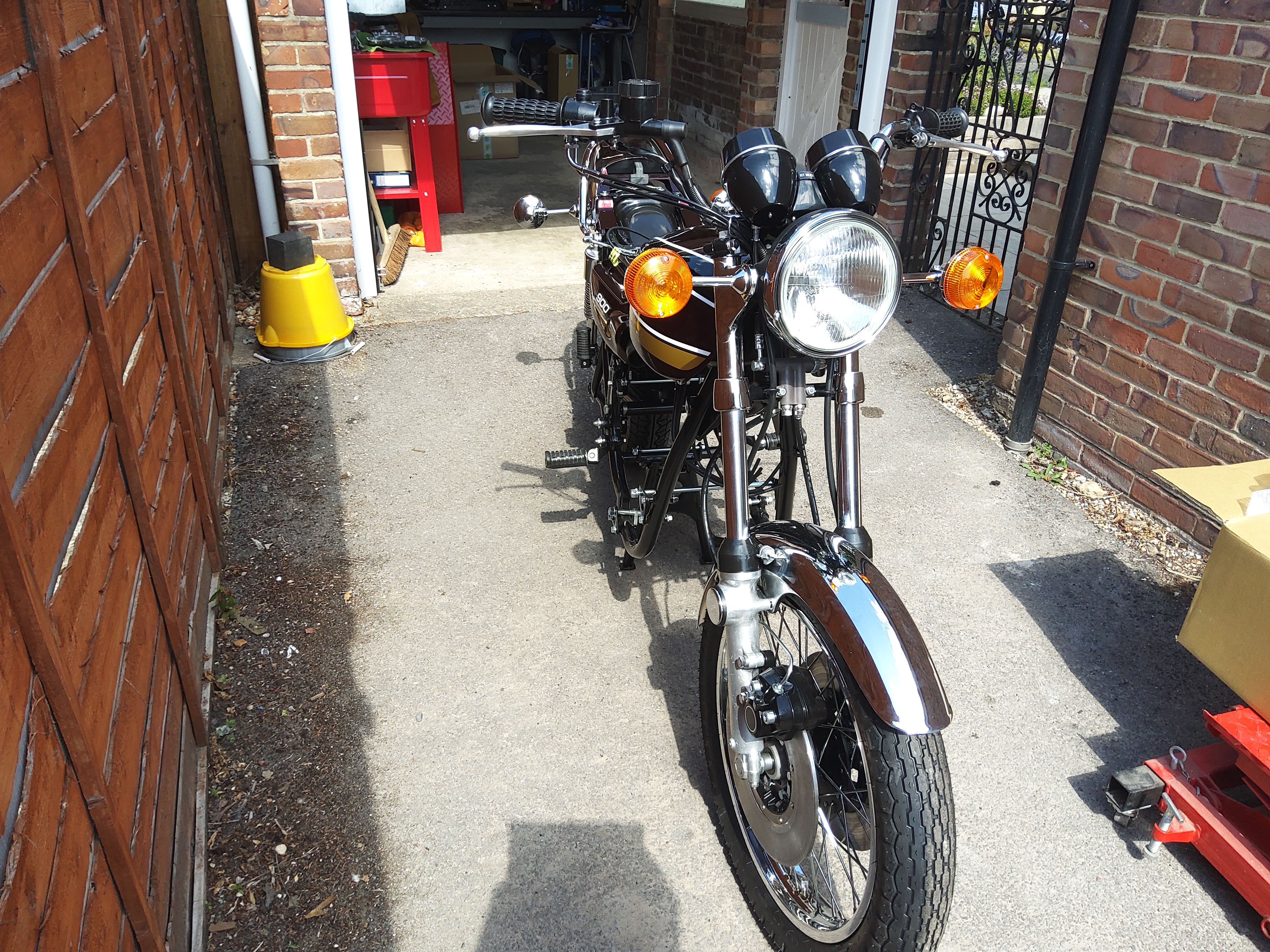

Many thanks re splitting the cases. Will forge ahead with that. Thanks for the sump pan advice as well although I'd already posted the previous comment before reading your reply. Just for your amusement I've attached some pics of the progress so far, a rolling chassis. Seat still with refurbishers.
Z1-B, 360bhp ZX1000NGF
Posts: 1404
Re: EBC Clutch Removal Tool
#13 PostAuthor: Bill P » Tue Jul 21, 2020 5:32 pm
Very nice indeed :)
