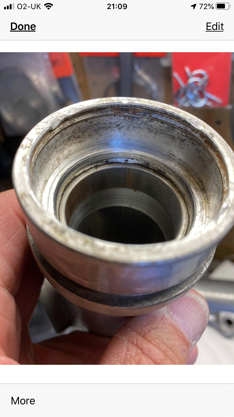

I have an odd one here. Has anyone ever seen this type of bearing
bush being used in standard Z1000-A2 fork bottoms.
It 40 OD X 36 ID X 10 mm H and is not a split bearing.
If so does anyone know where I can source them from?
Cheers Mike

Seen these before and believe they are not available.

Try searching online using bush dimensions rather than bike model or part number. I found lower bushes at pyramid parts that fit a gpz1100b like that.

Thanks for info,
Z1Bman, spot in.
