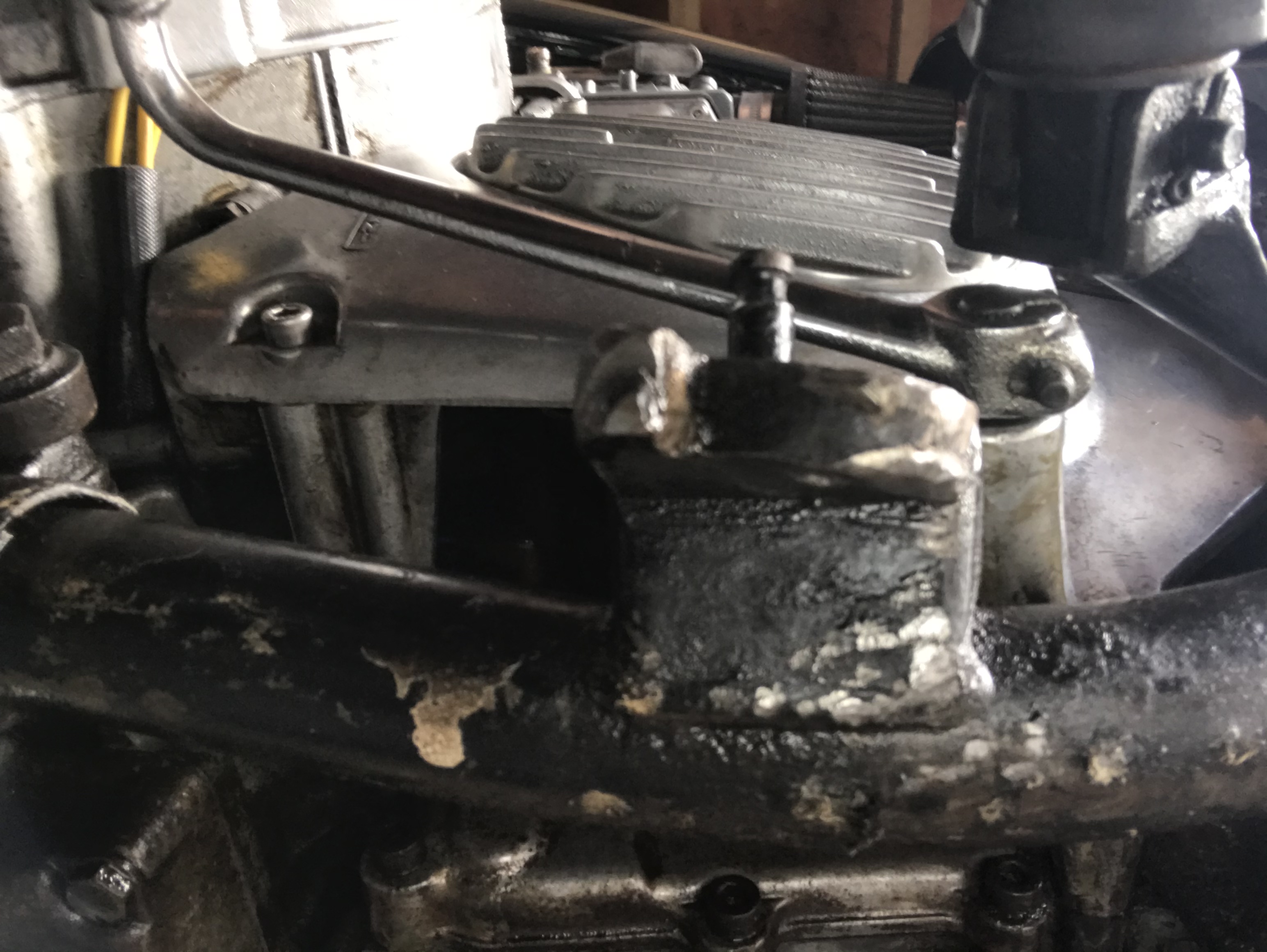

#8 PostAuthor: Arctic Fox » Sat Jul 04, 2020 5:43 pm
So, the saga continues...
Are side stands normally this bent? As you can see mine now doesn't come up onto the rubber rest, it did, so how do I adjust it? Any ideas as I'm sure this issue has been seen before.

Re: Fitting 4x4 Exhaust
#9 PostAuthor: Adrianbrooksbank » Tue Jul 07, 2020 6:47 pm
Just looked at mine,it is straight and goes up to the exhaust but still does not touch rubber properly and never has,mine has Z1B exhausts on Z900A4 but the original ones were genuine A4 and we're still the same probably due to accident at some time probably,this is a replacement standard side stand which is exactly the same .Hope this helps

#10 PostAuthor: Arctic Fox » Sun Jul 12, 2020 11:57 am
Took the stand off yesterday and the mount appears to have a curve in it. I suspect this is not normal? Any ideas on straightening it as it’s a bit of a lump of metal!

#11 PostAuthor: z1bman » Sun Jul 12, 2020 5:57 pm
the welded mount bracket is bent as a result of previous owners sitting on the bike with the side stand down

#12 PostAuthor: Arctic Fox » Wed Jul 15, 2020 4:24 pm
Wouldn't that pull it out rather than push it in? I suspect it was dropped and sidestand got pushed up as the bend is to the back.
That aside, anyone have any ideas on how to straighten it without having the bike stripped?

#13 PostAuthor: z1bman » Wed Jul 15, 2020 8:01 pm
it could be the exhaust hanger has been pushed in if its been down the road how much gap have you got between the exhaust & the wheel spindle ? the chain looks awfully close to the frame

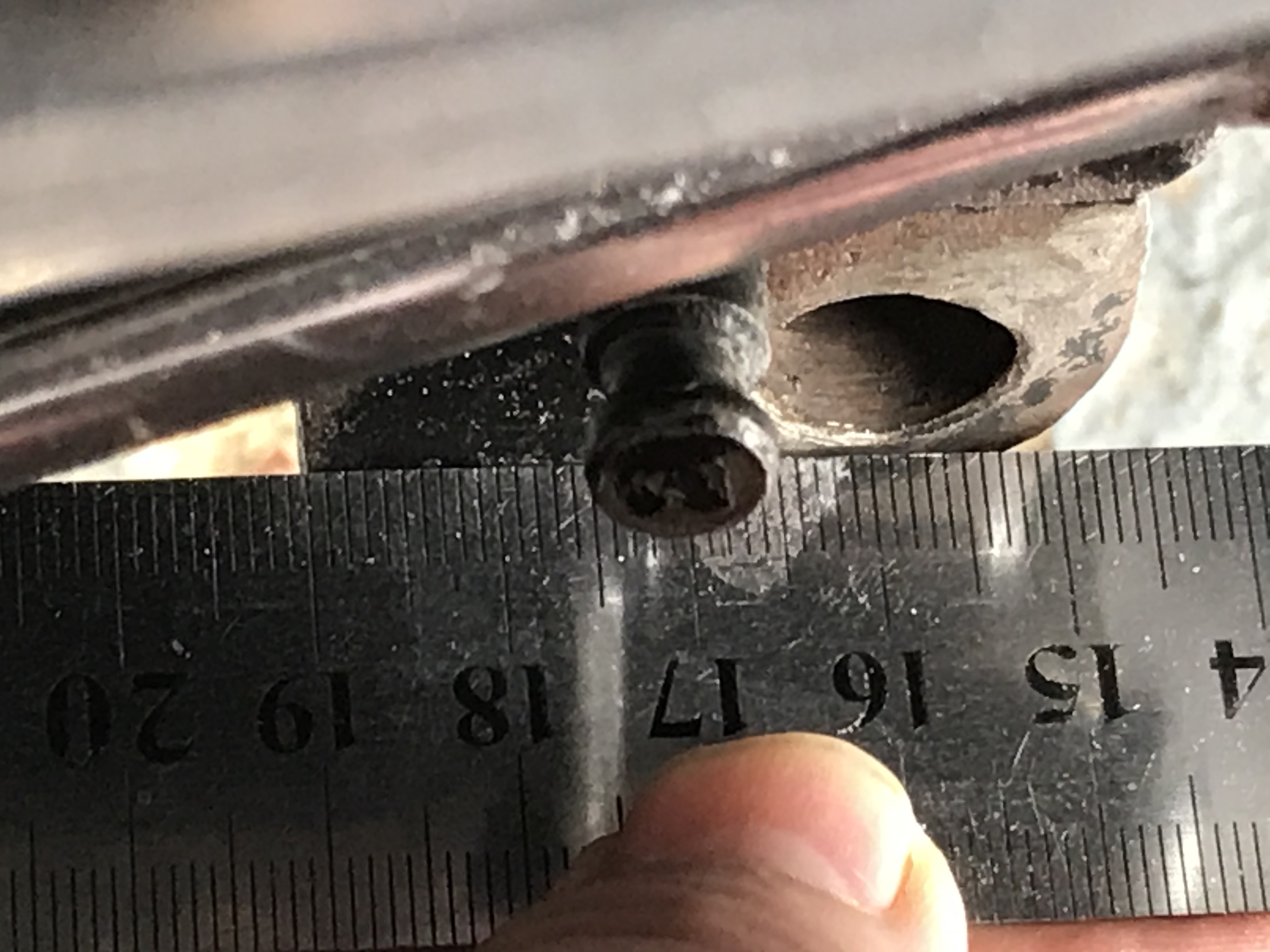

#14 PostAuthor: Arctic Fox » Thu Jul 16, 2020 10:57 am
Clearance on the Metmachex swing arm is tight on both sides, it appears equidistant. But puling it out would further cause problem as the exhaust would pust the stand out further.
Anyone know the dimension the frame should be between mounts? Mine seems to be 310mm from outside one mount to the the other (bit difficult to measure exactly with the wheel in place), and reasonably similar in profile both sides (by eye anyway).

#15 PostAuthor: Arctic Fox » Sun Jul 19, 2020 9:16 pm
Thanks to 2 gents at the H cafe today I had a look at 2 Zeds and both had the bracket pointing more outward, so I need figure how to bend it outward. Advice so far, heat and a big hammer!
