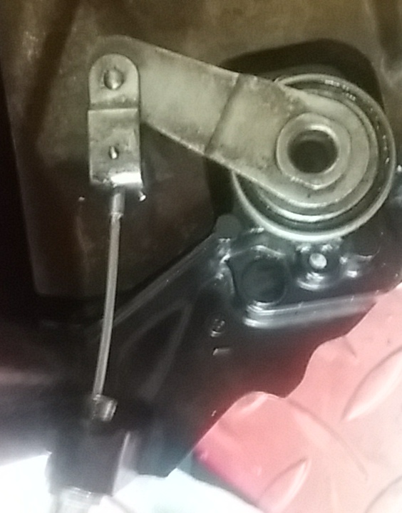

Having a few conflicting issues with this one, so could do with some guidance. The factory manual mentions a ball bearing for a b2 but there is no picture or obvious part number in the parts manual.
The engine is a 1981 b1, it has the newer ramp and roller clutch release mechanism and a new pushrod.
I put an 8mm ball bearing at the clutch end where the push goes and it jammed solid, i had also tried a 6mm ball bearing and the is obviously too small ( 8mm as its the same as early pushrod/6mm as recommended)
I have adjusted the cable turning the screw anticlockwise and i have to adjust the mid cable adjuster to its max, even with this the clutch is just disengaging causing the wheel to drag. I have taken the clutch plates out and oiled them up as well.
Any help would really be appreciated

there is NO steel ball between the clutch and the push rod like in the old Zeds.
Are you sure you have the correct push rod ? Is it not too short ? It doesn't matter what type of clutch release mechanism you have, they both use the same push rod. Before you ask, I don't know the lenght of the rod. I forgot to measure it, sorry...
It's a pain in the a... to adjust the clutch. I know...
Just take out the steel ball, make sure the push rod is fully in the axle so that it touches the clutch.
Take the clutch release mechanism apart, put grease in it, mount it correctly and adjust it. If you have all the correct parts it should work.
Make sure the clutch cable sits correct in the chain cover, screw in all the adjusters so that you have the full lenght of the cable and mount the release mechanism so that the cable holder points down. When you pull the clutch lever the release mechanism turns counterclockwise and comes out of the chain cover, pushing in the rod and disengaging the clutch.
I hope my explanation is clear and that it helps you.
Good luck!

Hi Phillipe, I removed the ball bearing as soon as i tried it out. The push rod is the correct one as i used the part number on the manual, although a superceeded part number, its the correct length.
I am tweaking the adjustment and its slow going but I think I am making progress.

Ok update time. Finally sorted it. The gpz does not have a ball bearing fitted. Tried with one and it jams up the clutch. Also spoke to Chris Tombleson and he said nope doesnt have one. Stripped the clutch down and saw the hub was worn by the plates. I had a better condition spare and cleaned up any wear marks, fitted it and adjusted. Works well now. Not sure why the difference between similar bikes, but apart from that picture there is no mention of a ball bearing or a picture of it in the manual. Parts or workshop.
