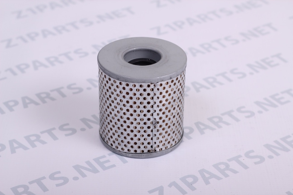

Bought my 900 via a third party as a part started kz900c to A4. I ordered a hf401 filter (paper type) from dave, however when removing the old filter it is the taller metal canister type. Which leads me to wonder if the engine is not prehaps the original, the barrels are marked 903, the engine number begins Z1E12513 (apologies i am at work and looking at a pic i have which does not depict the full number)

all the z1/z900/ z1000a models use the metal perforated oil filter

thanks Guys , I must have been sent the wrong filter phew :??
