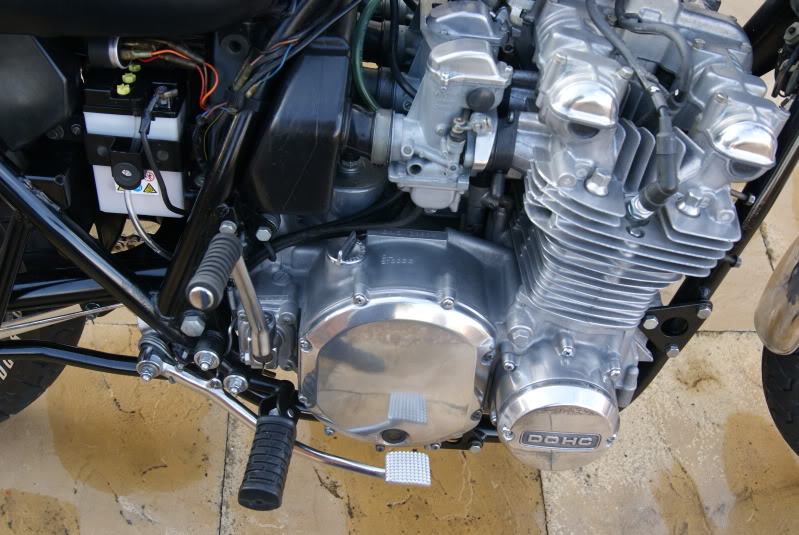

Hello - don't laugh.......but I need advice on how to remove the battery from my 1976, z900. It looks like it's encased in a metal jacket and I have no clue how to remove it without undoing a load of bolts.
Can somebody please advise best practice for this? I've searched Ytube - no help there. I don't have a Clymer etc. Only just got the bike.

Re: Replace Battery
Posted: Sat Apr 27, 2019 2:09 pm
Author: Big Fluff
Just in case you're not taking the piss :lol:
    Firstly remove the RH side panel and lift the seat up for access.
    Next remove the fixing and disconnect the earth terminal on the battery.
    Next remove the fixing securing the hinged bracket, then partially slide the battery out.
    Disconnect the vent pipe (if fitted), remove the fixing and disconnect the positive terminal on the battery.
Job done.

Eventually got this done - that picture was very useful thank you. My battery was in a plastic box, unlike the one in the pic.
