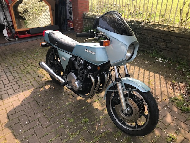

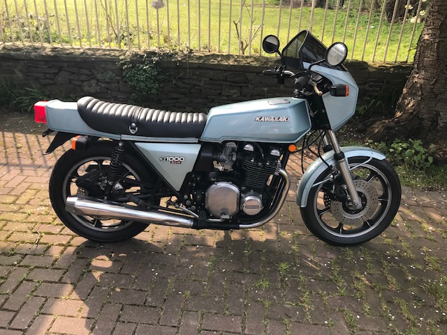

Z1R delivered, all ok. Quite pleased as i but in some fresh fuel and she started first time. Idles and revs fine, checked everything over and all is good.
I need to get an MOT for the registration, and whilst checking the lights noticed some strange. When i put on the headlight the front indicators also come on!, they stay on and also flash when selected!.
Before i start cutting wires, is this normal for US spec bikes, and also would it be an MOT failure here in UK. To avoid cutting wires and to speed up registration I guess i could get a daytime MOT???.
Also are there any other things in particular i need to change, eg. do i need to replace the headlight?
Rob

#3 PostAuthor: chrisu » Tue Apr 23, 2019 12:18 pm
rpeters wrote:IMG_1337.jpgIMG_1336.jpg
Rob
That is normal for USA bikes. Is a left hand drive headlight you can just use black tape to pass.
