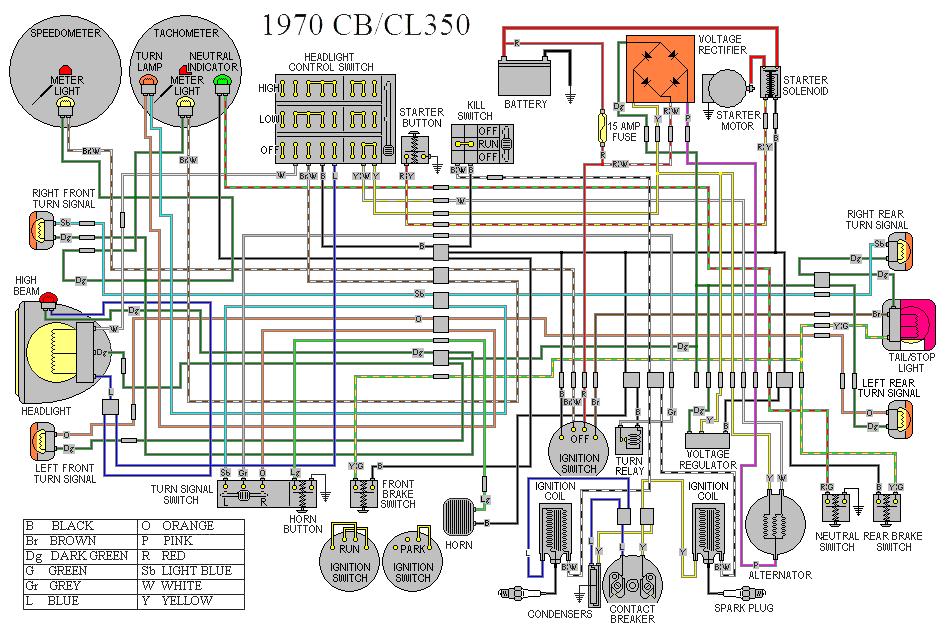

Guyz ,working on the wiring on a Hodna cl350,the standard reg/rect is shot,have got hold of a new unit have worked out i need to link white and yellow from alternator to give extra output,the unit has yellow,pink,green and red,red i reckon is to batt +ve,green to the frame -ve,yellow and pink alternator ac inputs,either was round...can anyone confirm before i fire her up? Ta Paul J

I asume you have done this already ......... should this be in the bottom shed big lad ??
Honda CB_CL350.JPG (156.21 KiB) Viewed 2569 times

Yep seen that diagram Keith,feel free to move the post if needed,its the colour codes on the combined reg/rect i am looking for .

Bang on chap,thanks
