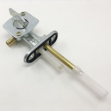

Ok,Im ready to give up.Tank has been cleaned and tap rebuilt,I dont know how many times. Inline filter fitted and 4x new sets of float needles and seats fitted.
Fuel still pissing out all over the place when the bike is parked up. All will be well for 2,3,4 weeks,then it just lets go.Im so frustrated with it. Fed up.
Anyway.Im looking for an alternative fuel tap. A manual (non vacuum)one. On/Off/Reserve. bolt holes are 44mm heart to heart. Cant afford a Pingel, looking for another japanese model. Anybody got an idea of something that might fit??

Have a look at the fuel tap for the Z650 - might sound odd, but have a look
I wanted the same on my Z1000 - simple on/off/res tap, with 2 bolts (can't remember spacing measurement) - found that the z650 tap uses the same bolt spacing and is about 1/2 the price of the z1000 vacuum

Thanks for the tip,becker. Ill have a look at that Any particular model/year or are they all the same?

That looks like a vacuum tap.

I thought all taps with bolt holes were vacumn taps, obviously mistaken - looks like it is specific for LTD, CSR and police models.
Suspect your best bet will be American suppliers like - Z1parts, Z1 Enterprises or US Ebay.
Kawasaki 51023-1039 TAP-ASSY,FUEL fits the following models and components:-

This is listed at moment - https://www.ebay.co.uk/itm/kawasaki-750 ... Sw-RhaX43T. But part no 51023-1375 - is for Kawasaki KZ1000 Police 2002 - 2005, (Says bolt spacing 34mm ? )

My Z1000J tap did the same as your CSR one, replaced it with a Pingle, which has given me a load more problems.

51023-057 is non vaccuum used on Z650 B1 and C1

Absolutely not looking for a direct replacement.Looking to get rid of the vacuum and go manual. Hoping that a manual with bolts is available. I was planning to head up to my local breakers this afternoon.Hes got a CSR650 listed for parts but thats on your list Adrian so its probably a vacuum tap as well. Ill take my tap up and see what he has that might work.

51023-0047 is non vaccuum and still available from Kawasaki £42.95 + VAT and postage.

Got any idea on the bolt hole spacing on that one?

davido wrote:Got any idea on the bolt hole spacing on that one?
about 35mm hole centres

i dont think you would have a good enough flow of fuel with this type of tap as they are only fitted to the smaller bikes with single or twin carbs ?
