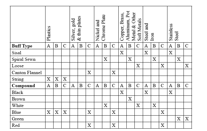

Got myself some polishing mops of various sizes to fit on elec drill and to use on the metal/Alum/Chrome bits - Comes with green and white bars of compound - Understand these have different abrasive strengths etc but has anyone on here used these bars and which colours are best ? :roll:

Cheers Warren - so are the shiny bits a mix of Stainless, aluminium chrome or what ? Thanks.

According to that chart, green is for stainless which is tough stuff so assume green is fairly abrasive. I would stick to the white unless you have some corrosion to polish out.
