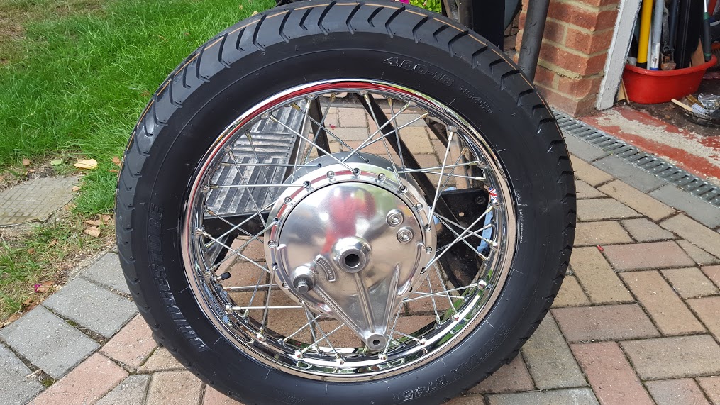

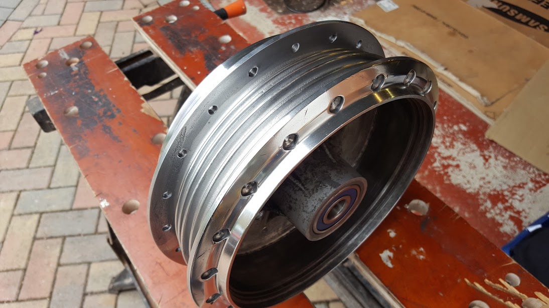

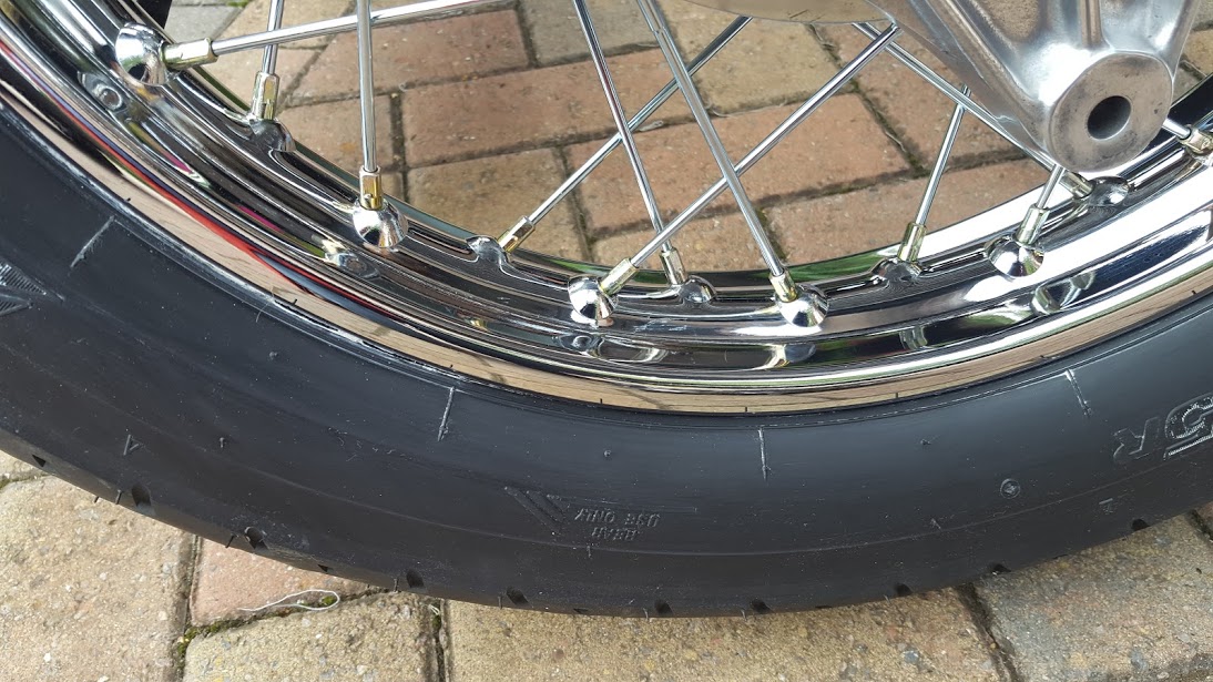

I replaced the spokes in the rear wheel of my Z900. I used a set of spokes from Z power which match the originals inc the nipples. Once I'd stripped the wheel, i cleaned up the rear hub with a scotch brite wheel. It came up like new. I polished the outer rim and brake plate but obviously this is personal preference.
I laced the wheel up with out tightening the spokes then had it trued up by a "wheel man ". Looks pretty good now I think. (although I did use a new rim as well). This was my first time at having a go at re spoking a wheel. `Just take your time and have a cup of tea if it goes wrong and come back to it.
