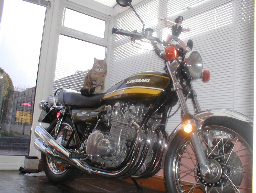

Re: Any advice please for first start in a very long time.
I think the cat has sat on it more than me

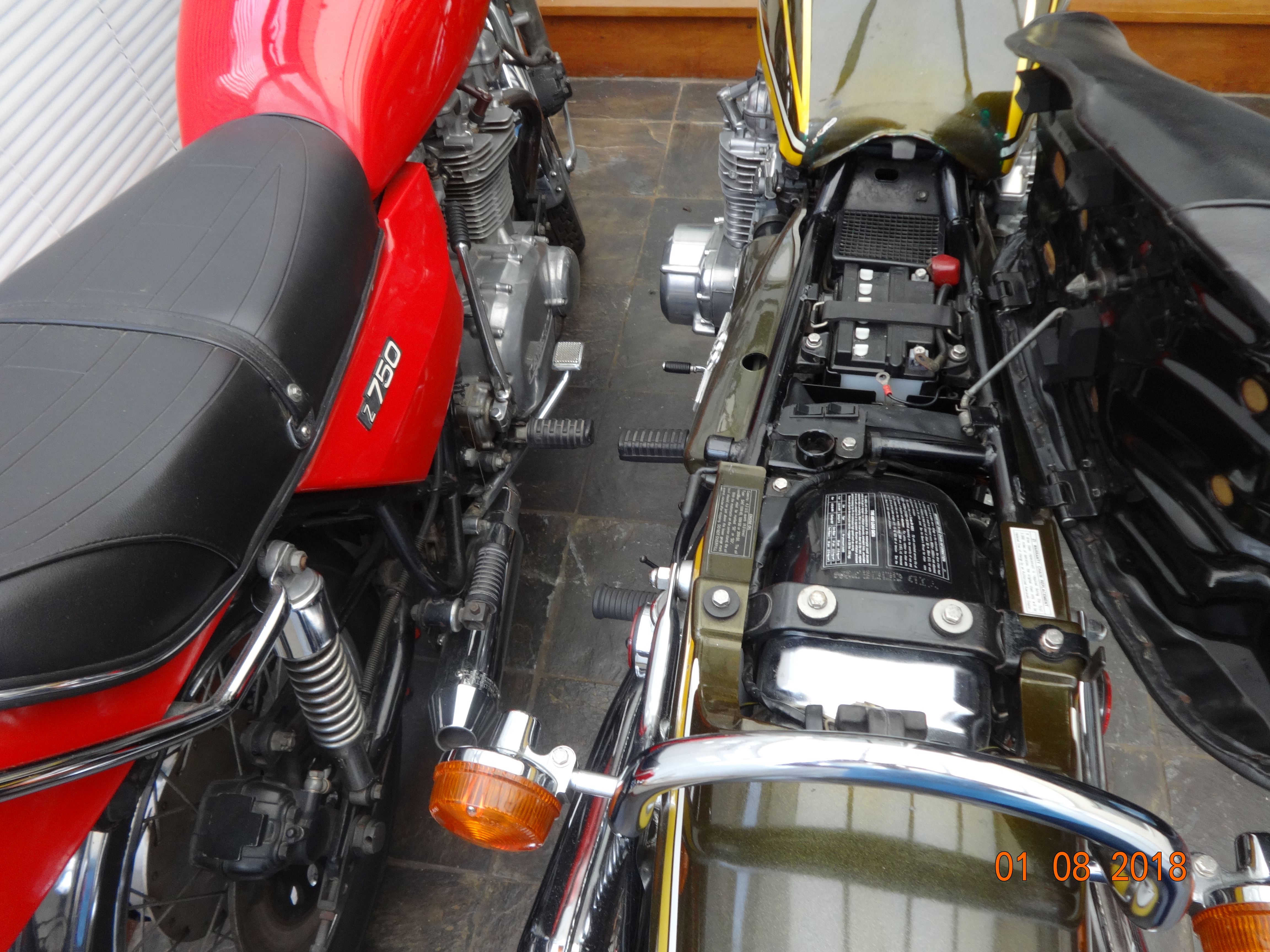

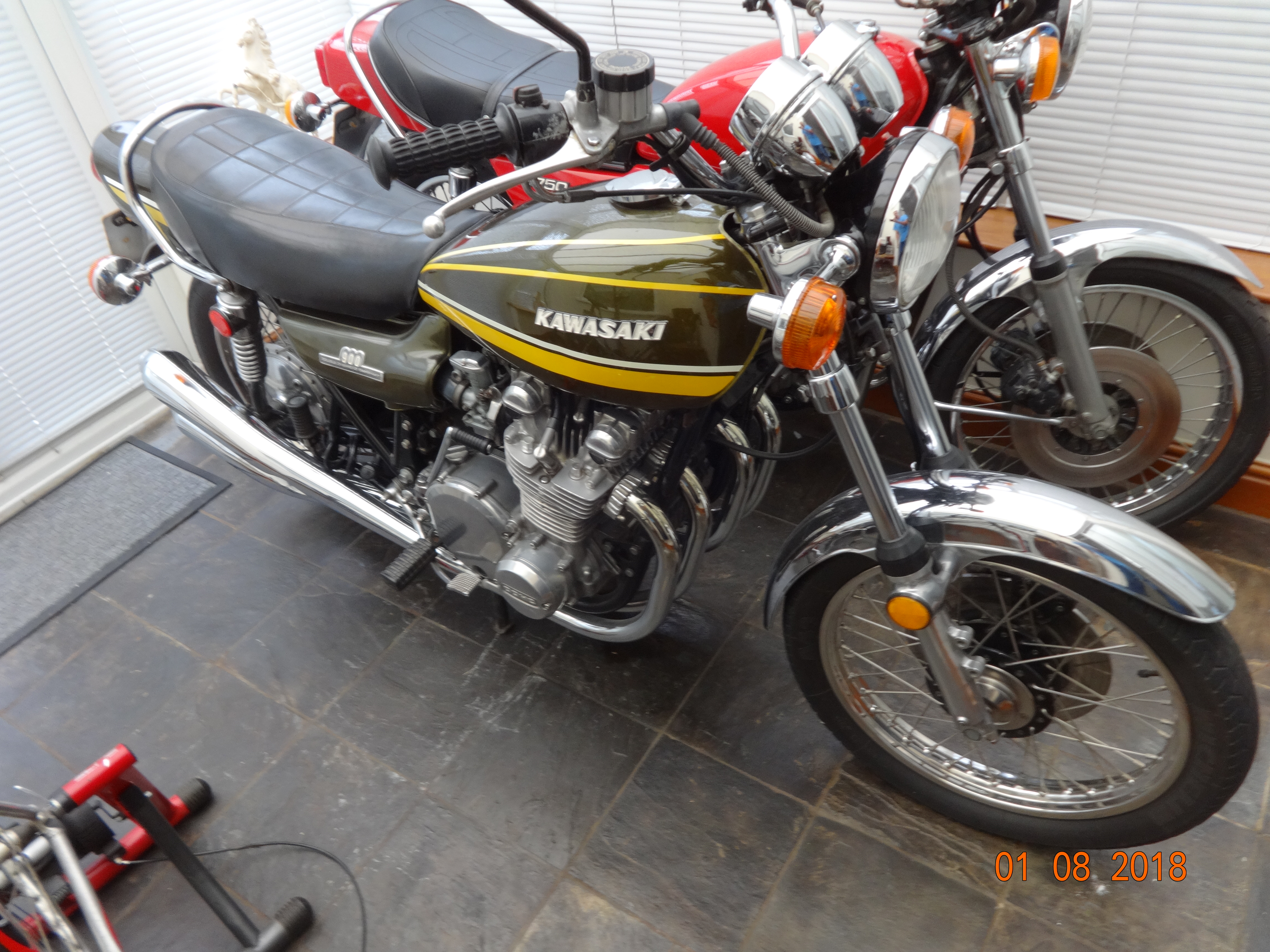

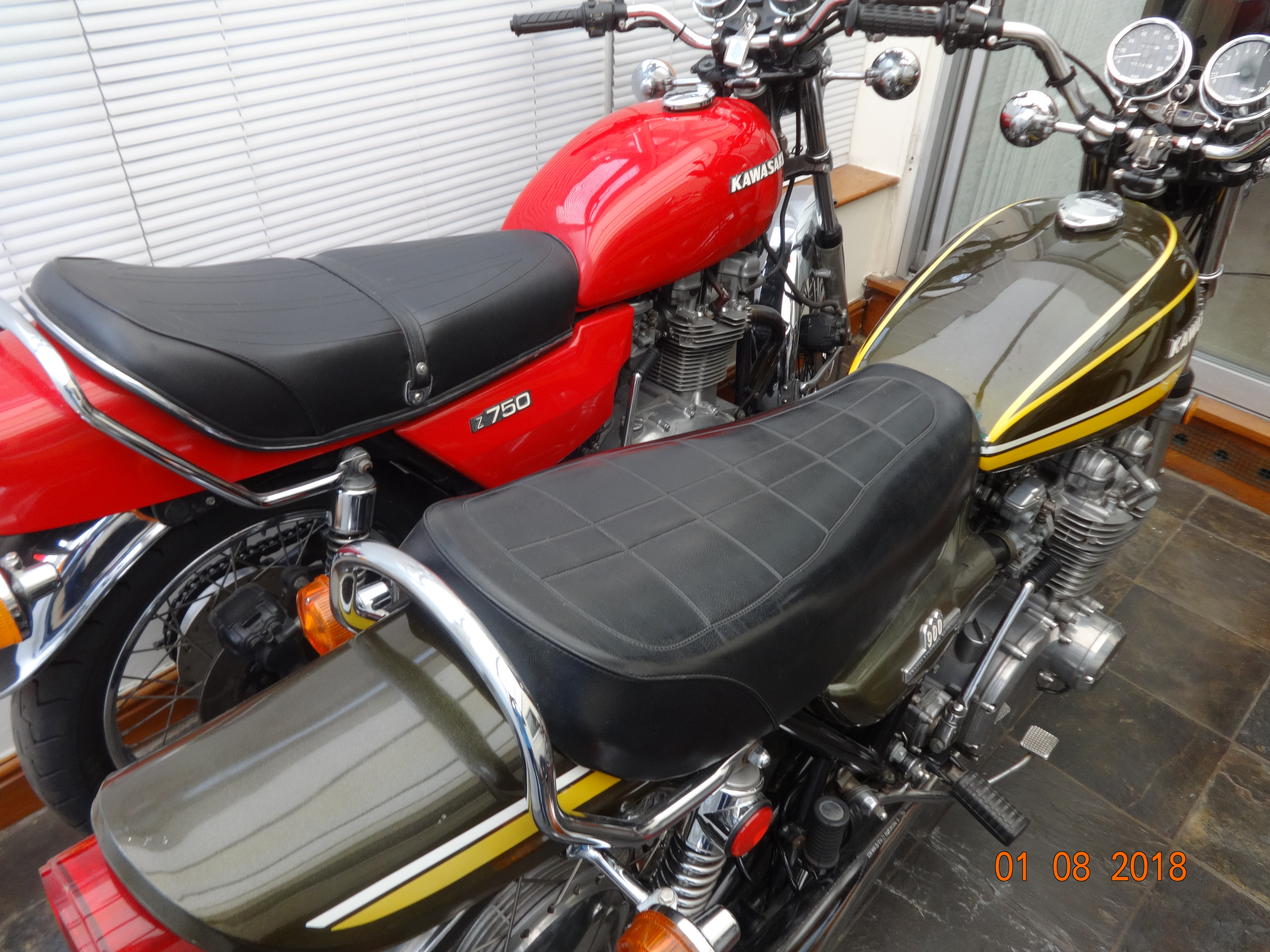

I never got road to starting the Z1 from the original topic, still sitting there and another summer is now obviously going to pass.. I would appreciate a bit more advice please as considering selling them both now as don't think I will ever get round to doing anything to either bike. What I would like to know is would I get a better return if both bikes are fully road worthy or a bit of a swing and a roundabout? Both good but not started in a long time, 2010 for the z1 and 1999 for the red bike. Both will require a full recommissioning , including brake repairs, tyres etc, and z1 has a bit of an oil leak. The red one is a non standard 750 twin b1/b3 cobble. Added couple of photos (hopefully) to give an idea..
