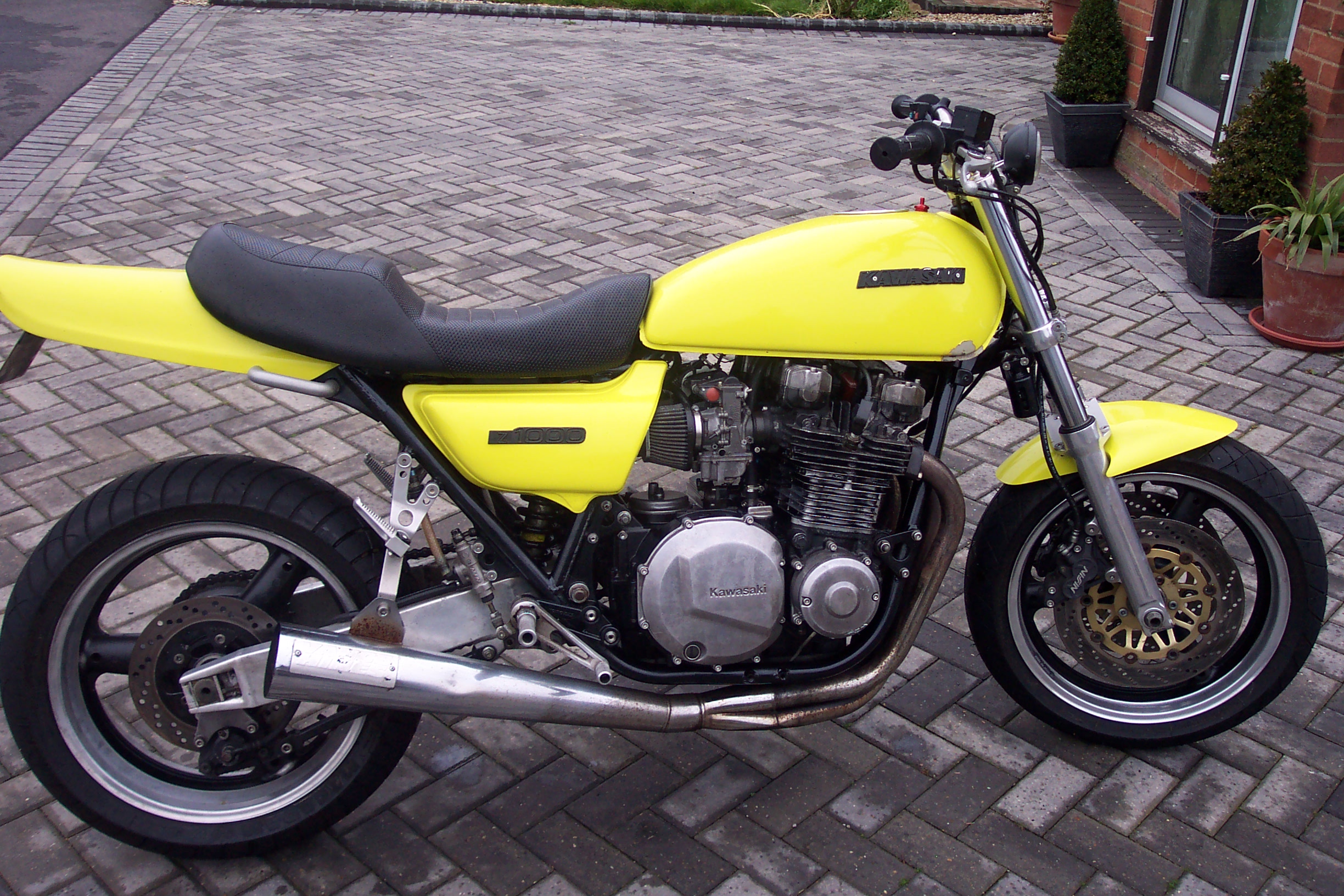

#6 PostAuthor: Gus » Mon Nov 13, 2017 6:30 pm
Done rather a long time ago.
From memory the front and rear top mounts are a straight fit.
We welded another tube across the front with ears on to fit the lower mount.
And I "think" we welded ears on to the swing arm cross tube for the rear lower mount
Gus

#7 PostAuthor: Julian_Boolean » Mon Nov 13, 2017 9:02 pm
There isn't a lower rear engine mount on a GPZ1100 engine (or any J engine), the front lower is an additional one to the older engines, front mountings are rubber, rear is solid

Julian_Boolean wrote:There isn't a lower rear engine mount on a GPZ1100 engine (or any J engine), the front lower is an additional one to the older engines, front mountings are rubber, rear is solid
That proves how long ago it was done and the last time I looked at it :roll: :lol:
