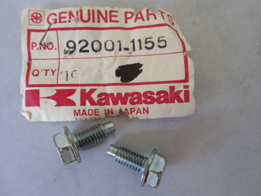

#10 PostAuthor: z1bman » Thu Nov 02, 2017 12:35 pm
this is the bolt for the automatic tensioner

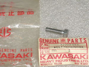

#11 PostAuthor: z1bman » Thu Nov 02, 2017 12:39 pm
this is what you should have for the a1 manual tensioner

#12 PostAuthor: ChrisB » Thu Nov 02, 2017 6:53 pm
yep, that's what i 'should' have. What i've got is a 30-45mm allen headed M6 bolt!
Re: Cam cahin tensioner removal
#13 PostAuthor: Philippe » Fri Nov 03, 2017 8:20 am
Hi Chris
when nobody changed the tensioner in the past, your's should not be an automatic but a manually operated one.
When it's a manual operated tensioner, the lenght of the bolt doesn't matter, only the point should be a little sharper.
Try to figure that out.
