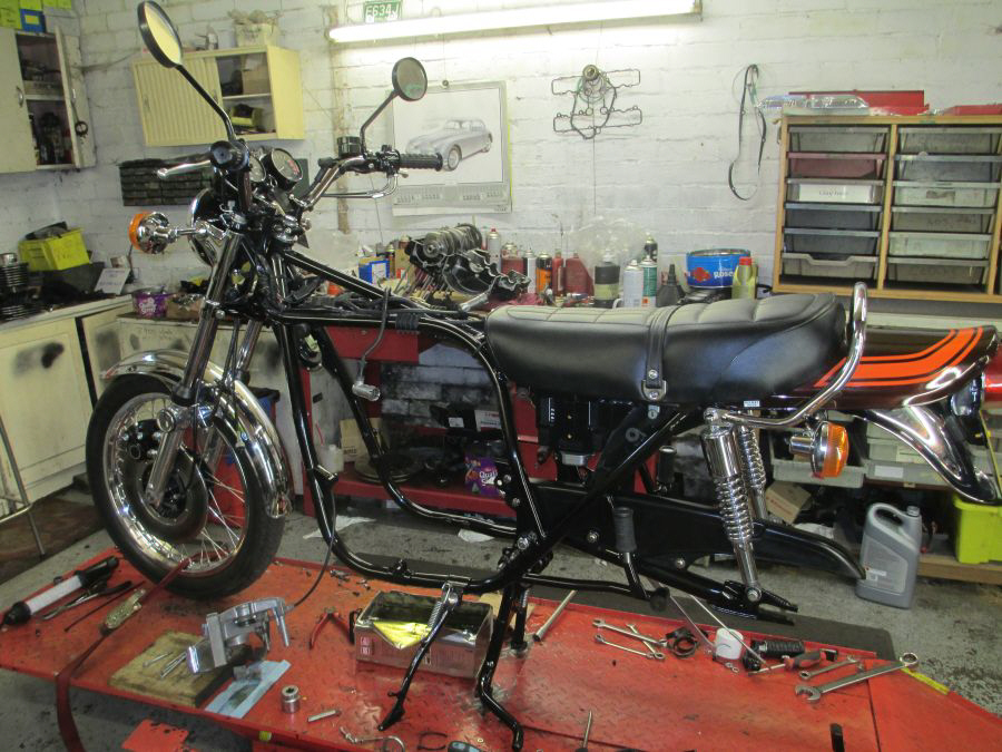

the top hat rubbers fit into the frame not the exhaust

there are not any rubber mounts on the exhaust . only the bolt goes through those holes the mountings are fitted to the frame

you can see in this photo where the top hat rubbers fit into the frame

Re: exhaust rubbers
yep there fitted and good to go, the issue I have the exhaust mount holes. I may be panicking here about allowance for fitting on the ovality. god I feel like right a plum now.
