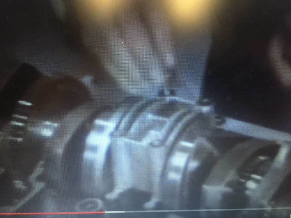

Hi all - I am about to start my motor build and for some bizarre reason I only had 3 main bearing end cap bolts with my Z1000 a1. I don't seem to be able to find a part number for the bolt. If anyone has either a spare bolt or a part number I would be really grateful.
I lifted the pic from a U Tube video apologies for the quality.

Thanks Drew - I have had a good look at the parts diagrams but cant spot the main bearing cap and bolts. Must be missing something.

Your right, it doesn't show either the end caps or bolts on z1000 a1 parts manual that I have, or at least not obviously.
The 650 manuals I have do show em but doesn't give a thread or length.
Possibly not much help but these are the 650 numbers but it doesn't say what the difference between the two are. 92001-175 BOLT,CONNECTING ROD 8, 92001-1793 BOLT,CONNECTING ROD 8

If its the ones i think it is i have one,45mm long from the captive washer pm me and send me a self addressed stamped jiffy and its yours..Paul J

Thanks guys - I'm glad it's not just me.
I have measured the bolts that I have and they are -
80.5mm end to end
M8 x 1.25 with a 12mm cap (spanner size) and a heavy duty Hi-torque flange / fixed washer.

Just looked at z power parts book for the thou ,92003-092 bolt,hex head 6x45 same bolt holds cam cover on?

Sorry its the pic ,its the main bearing you are after!

part no 92003-107 bolt flanged 8x72 in stock at cradley
https://www.google.co.uk/search?q=92003 ... 1382006329
https://www.cmsnl.com/products/bolt-hex ... eXlIltSx0w
measurement is taken from the end of the thread to the underside of the flanged head
