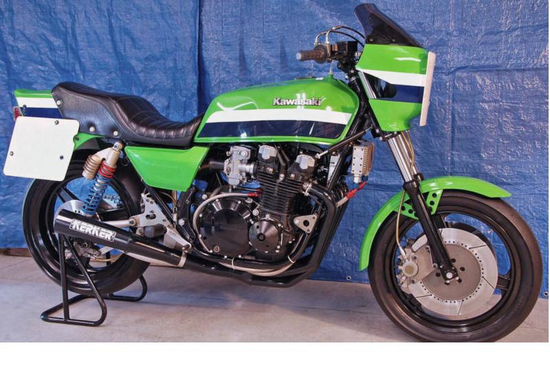

Author: KWACKERZ1
Al has but Rob has'nt on the picture above.
His swing arm gsxr slabby is 530mm
Also the orignal Lawson bikes did not have that done, but they did run less offset.
Copy of S11100r.JPG (81.54 KiB) Viewed 6258 times

I've had a look at some pictures of a standard J and the rear wheel looks to be about the same place as mine, so the offset of the forks may be the culprit here.
I'd still like to know how long a standard J one is if anyone has one, need to measure my swingarm for comparison, and probably something more important to think about than Z1000J handling.
