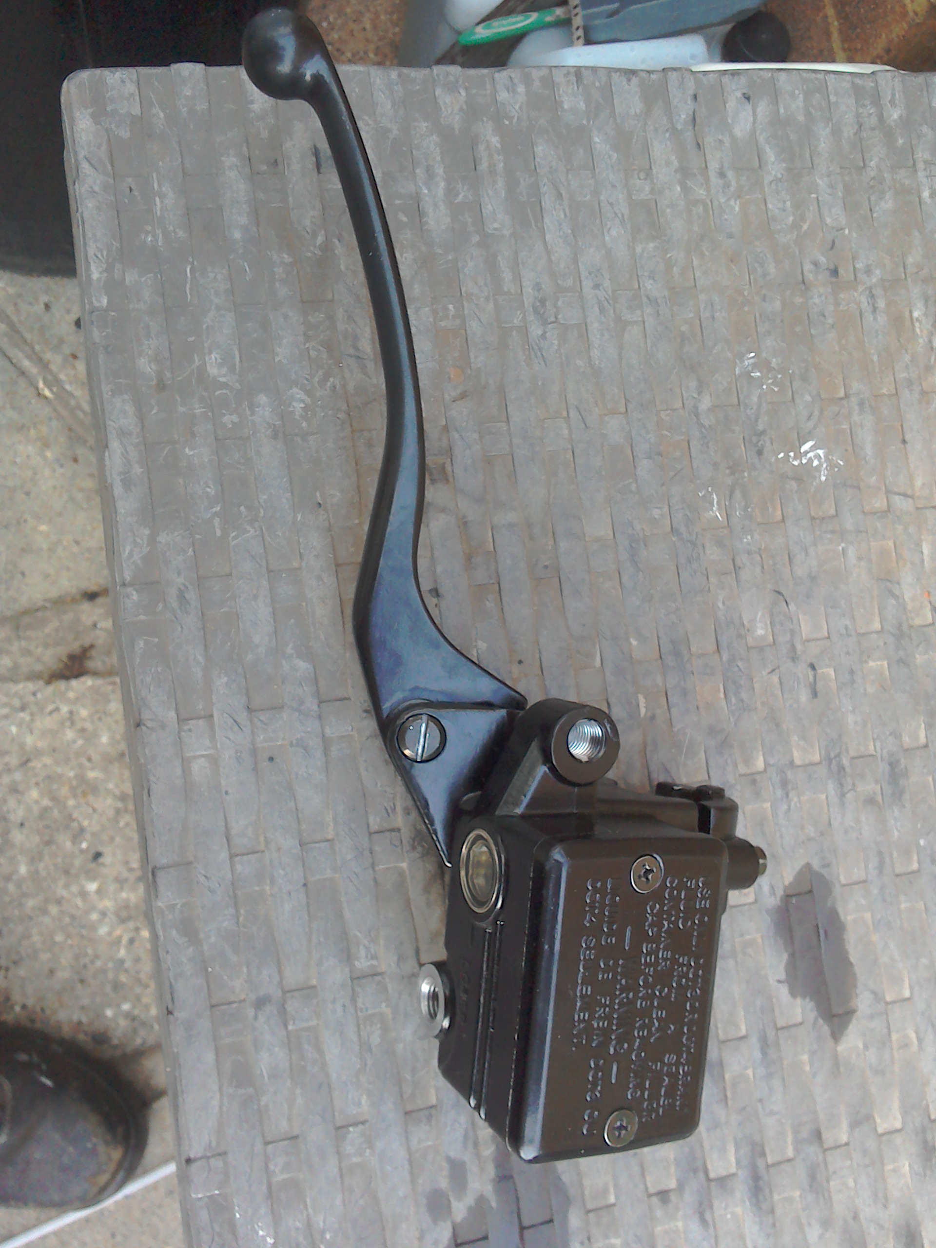

I checked the front brake to find nothing there at all lever went all the way to the bar with no resistance give it a few pumps and it was back again left it for 12 hours same issue no way am I going to ride while it's doing that will have a go at bleeding the master at the weekend also now have a short blanking bolt so I can test the master on its own hopefully will get this issue sorted.

#21 PostAuthor: Mrg » Sat Aug 31, 2024 7:54 pm
Blanked of the master and bleed it on its own and still couldn't get any pressure would explain why nothing worked so much for my new master cylinder :down

#22 PostAuthor: kev edwards » Sun Sep 01, 2024 6:03 am
You may have a foreign body inside the master cylinder or a problem with the seal, strip it down clean and inspect You may just cure it.

#24 PostAuthor: gray » Sun Sep 01, 2024 4:54 pm
At the bottom of the master cylinder fluid chamber there are 2 holes - 1 larger 2mm-ish and 1 tiny one. If the tiny one is blocked that's maybe your problem , preventing air bubbles from venting . Use a single wire bristle from a wire brush to check it

#25 PostAuthor: Mrg » Sun Sep 01, 2024 5:43 pm
Pull it apart cleaned out and rebuilt this is not an original master just one of those £30 eBay jobs to be honest I think it's shot fluid went a light shade of black and had constant bubbles when it was just the master bleeding think I've worn it out just trying to bleed it.

#26 PostAuthor: BAFF1960 » Mon Sep 02, 2024 8:11 am
I wouldn't recommend cheap pattern ( possibly nasty ) primary braking components, I'd rather go with an original / second hand Kawasaki part and service it or even adapting another models unit to suit.

#27 PostAuthor: gray » Wed Sep 04, 2024 7:45 pm
looks like GPZ 900 pattern. Try John Browse for a genuine second hand one , then either fit a master cylinder rebuild kit yourself for peace of mind or send it to that company who rebuild master cylinders ( they advertise in Classic Motorcycle Mechanics) who will clean, paint and rebuild it . Might be £100+ , but for brakes that's money well spent. They made a good job of my master cylinder
