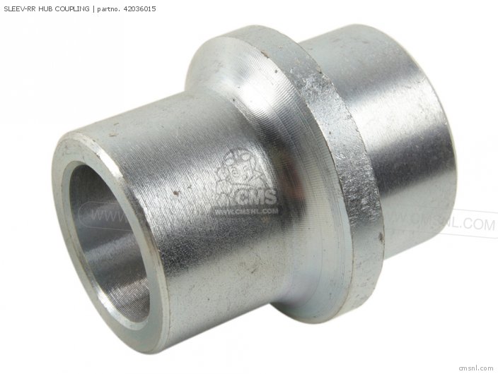

Re: Z900 rear wheel fitment (yet more issues)
This spacer fits on the inside of the sprocket carrier

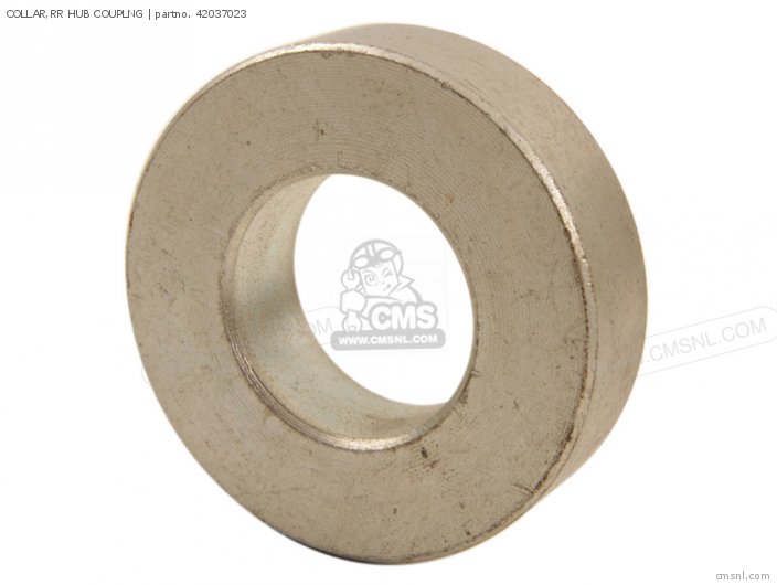

This spacer fits into the oil seal on the outside of the sprocket carrier

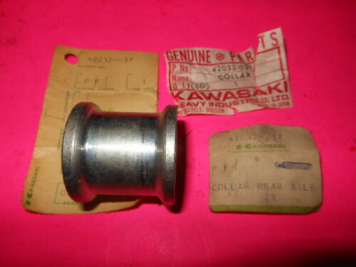

This spacer goes between the brake plate & the chain adjuster

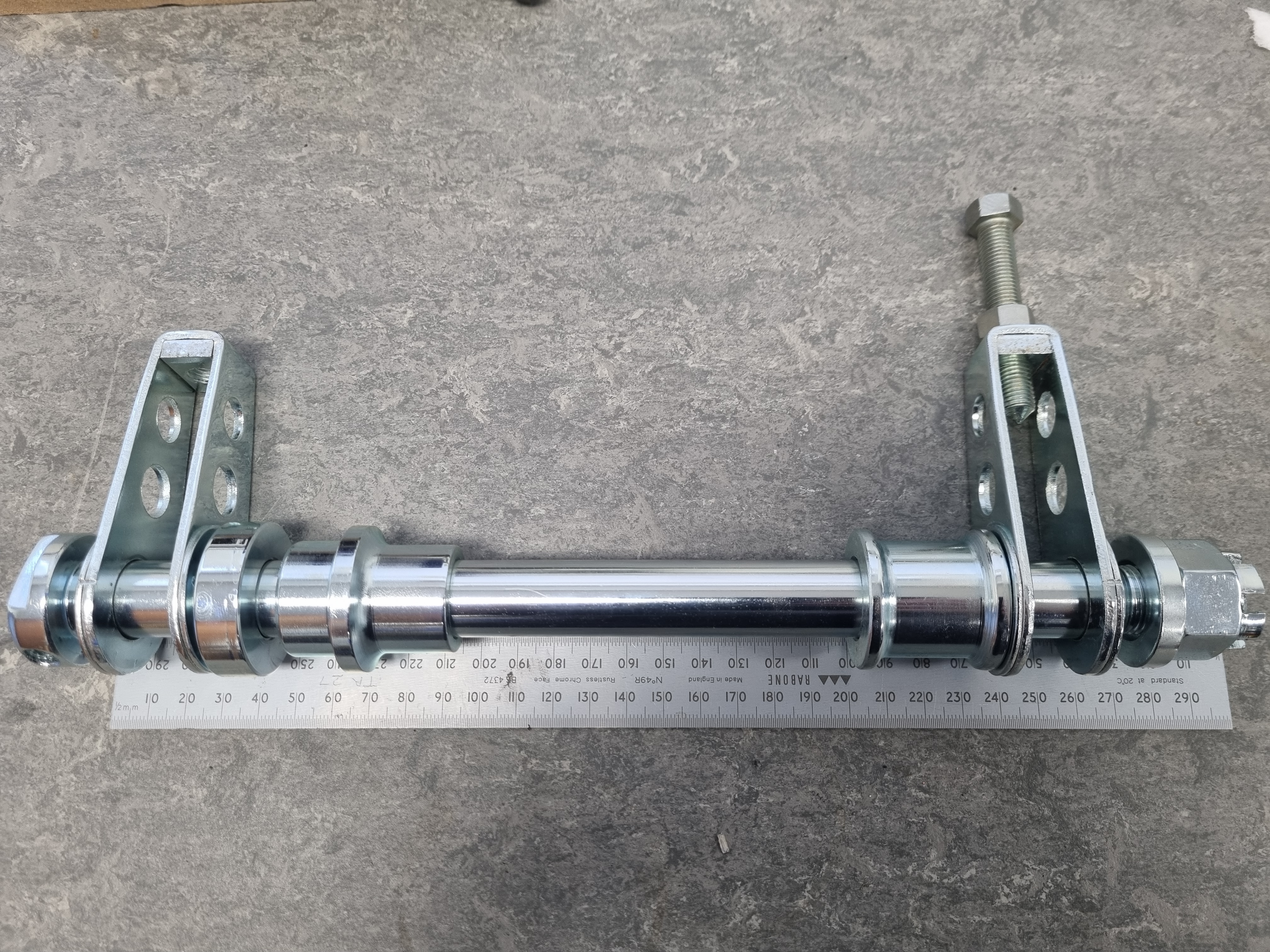

Hello Graham,
I'm sorry if this is a little late but the photo below shows the rear axle assembly for my A4. The axle length is 262mm from the shoulder to where the thread starts.
Thanks for the reply, wished my axle looked as good as yours, that looks brand new!, could you possibly measure the spacer sizes too, as was trying to determine what if anything is wrong with my parts.
My axle has exactly the same parts as yours but for some reason 2hen fully tightened doesnt clamp up tightly, therefore assume either axle wrong length, or spacers different thickness.
Many Thanks

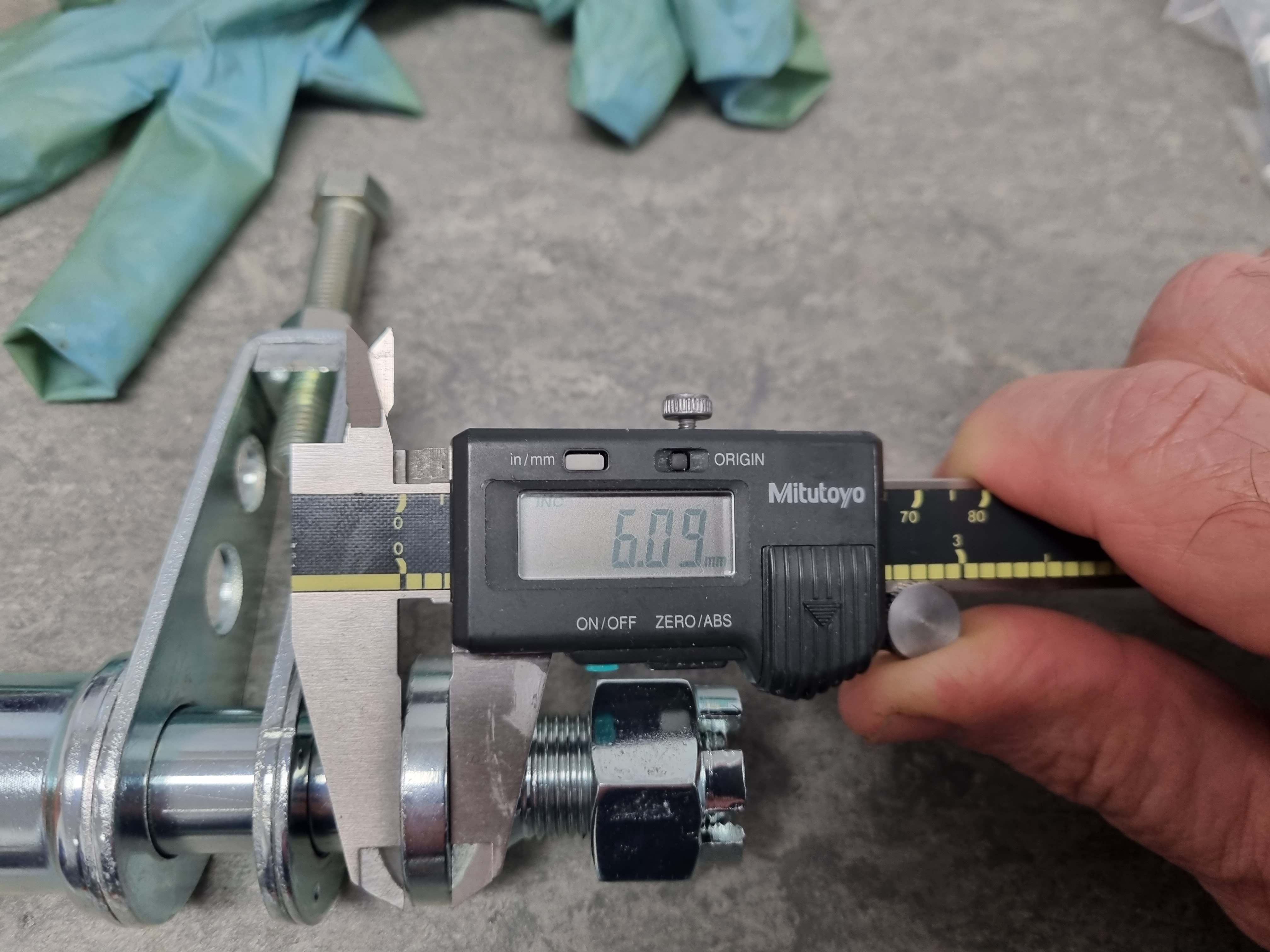

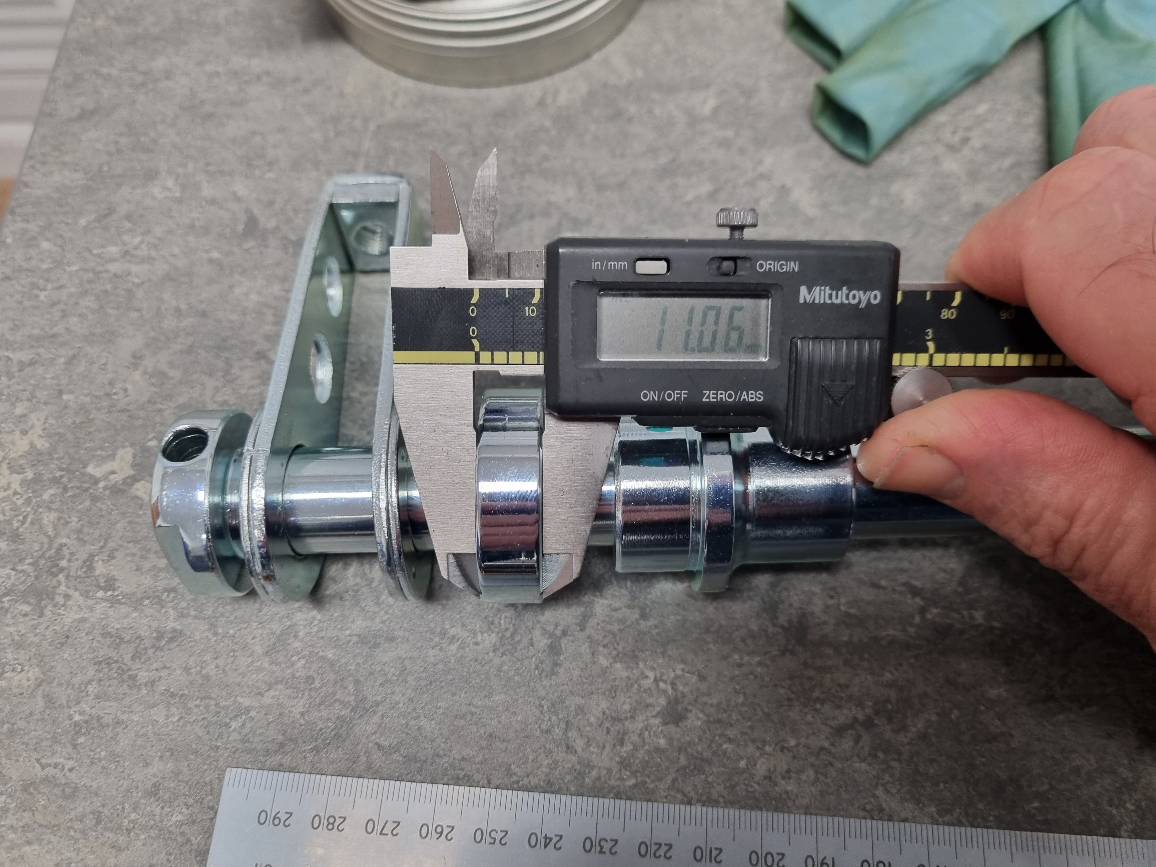

Hello Graham,
Please see the photos below. The thinner space is 6mm and the thicker washer is 11mm. I'm not sure if they may have selected different spacers on the production line to allow for manufacturing tolerances on the other parts e.g. swingarm dropouts etc
Thanks Sean, thats exactly what i was after and makes sense, it could also be the reason mine now doesnt tighten up properly. If 1 or more parts have been replaced at some point.
