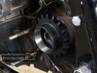

This is an offset with bearing nose fitted.
A 52mm 6304 bearing slips in after it's bolted up.
The bearing has a groove and clip on it's outer to stop the bearing going in too far or floating about.

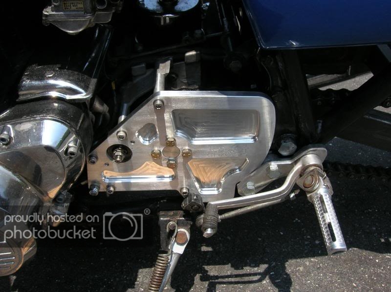

This is an outrigger support that you will need which you can make or buy from D&G etc.
The four bolts hold an ally stub which simply slots into the centre of the bearing which is usually 20mm.
It also holds the clutch mech and supports the gearchange shaft.
This is a pic of the inside of the outrigger plate clearly showing support stub with the sprocket and bearing slotted on.

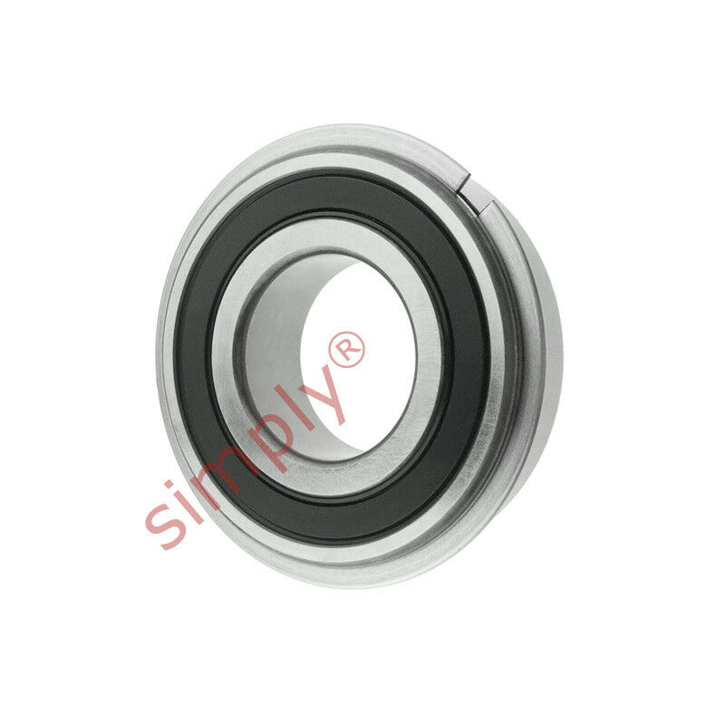

Unless you are planning loads of power you don't really need this and although running any offset will naturally put extra load on the output shaft bearing and shorten its life this is probably negligible on a stock or mildly tuned motor.
Here is the bearing and an ebay link to the cheapest.
https://www.ebay.co.uk/itm/Major-Brande ... SwSn1cRn4x
