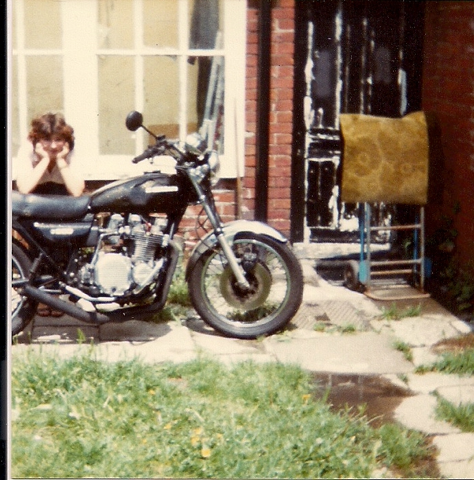

Just had to put a photo of my first Z900A4 - with a PIPER... I bought it for £60 brand new and promptly hacksawed the end off, flush to the mounting point!

That's pretty much the same length as the Delkevic.
