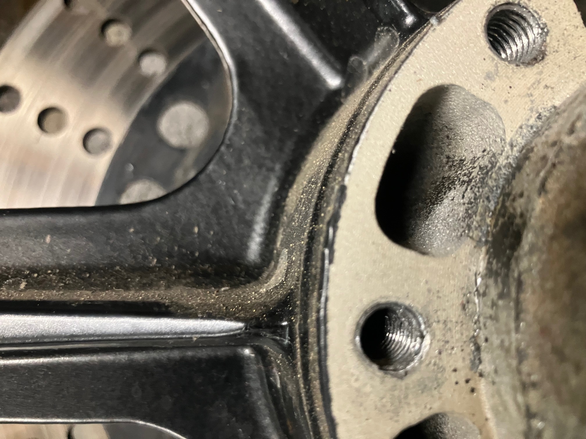

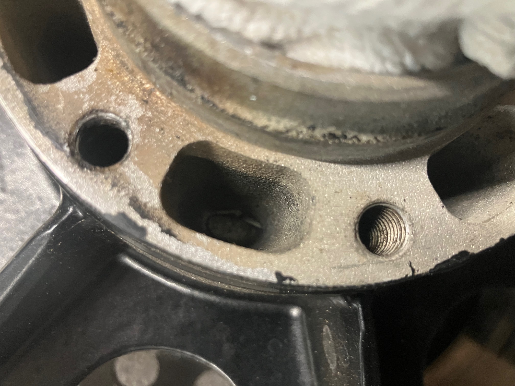

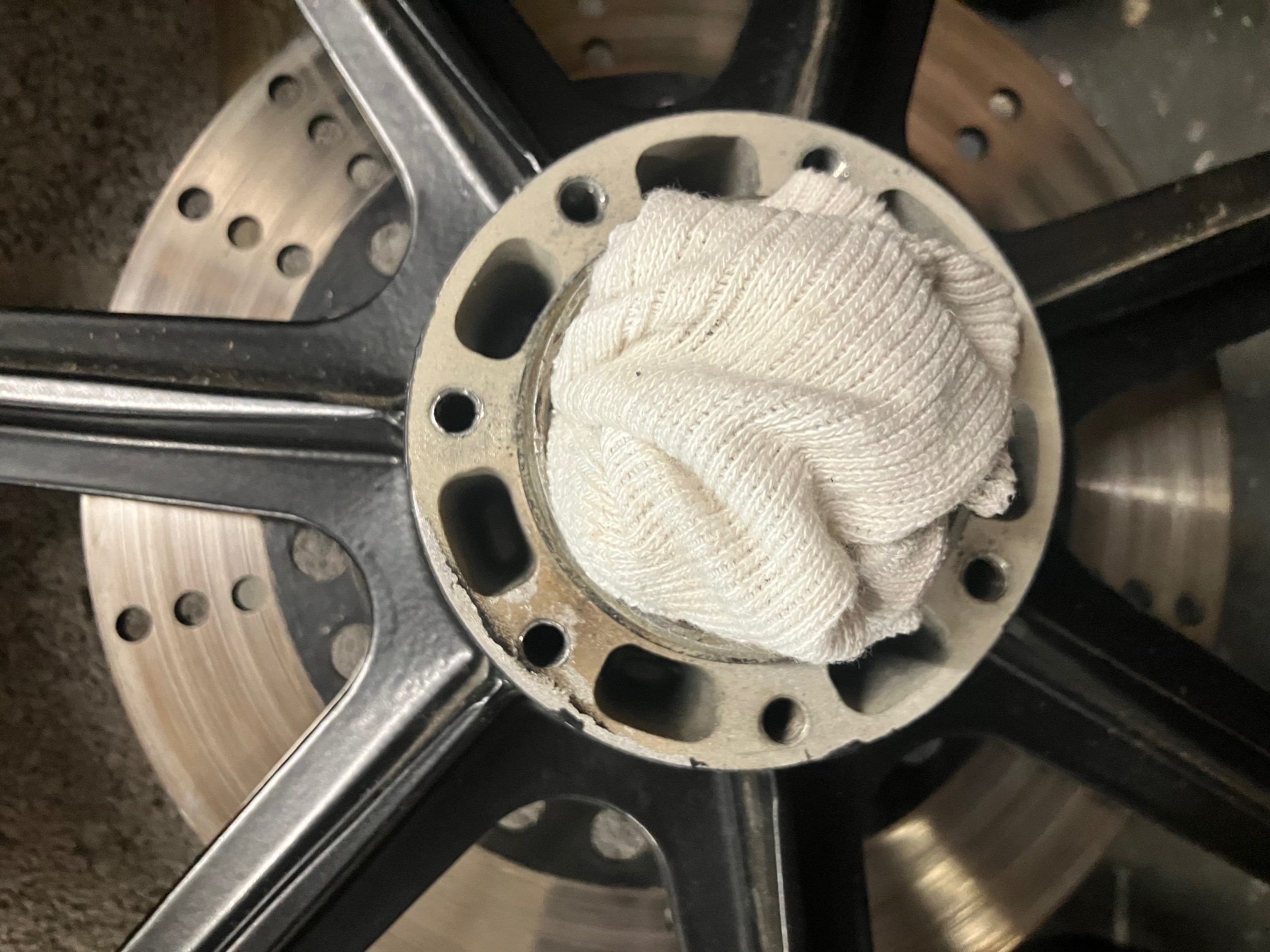

#6 PostAuthor: Vendetta761 » Tue Aug 19, 2025 1:24 pm
So front wheel off, disc rotor off and this is what lies beneath: a couple of spots bits/bleeds, maybe 1mm,1.5mm thick but obviously extra to the surface. I will get these off and also take disk to friendly engineers to check if/how it is warped but looks good on my engineers ruler and straight edge but I am no professional.

#8 PostAuthor: Z1streetfighter71 » Tue Aug 19, 2025 1:48 pm
This could be the culprit but not certainly. It is more of a reason than a warped disk but better to eliminate both possibilities.
