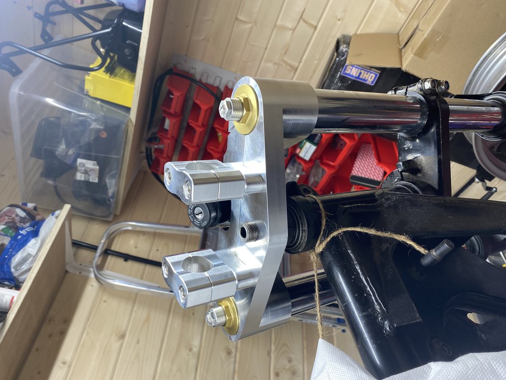

#14 PostAuthor: stusco » Wed Sep 03, 2025 6:34 am
FER wrote:Rapide Engineering , Trinty Gask , Auchterarder . 01764 683853 . They made the plates for the brakes on the front of our 1000R2 , std forks , Eliminator wheel , 320mm floating discs and Nissin 4 pot calipers . I am taking the front end from my klr650 up over the winter to get a plate made to for a brake upgrade .
fer
Dropped my front end off on Monday
