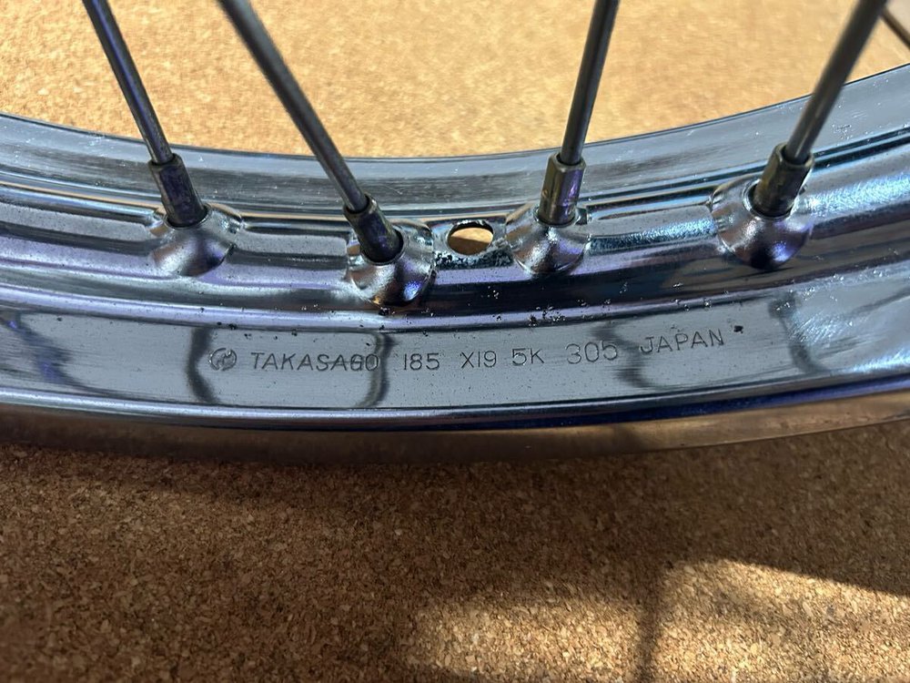

Its possible but there may be others that can confirm. There were 305 and 306 rims being produced in 75 for early the Z900, below is a front rim for what i expect is a very early bike.

#5 PostAuthor: davo63 » Sun Jun 08, 2025 5:15 pm
That's the date code on my front 5k 305. I'm about to have the rims re-chromed, which is not cheap and wanted to make sure they are original fitment for that boke.

#6 PostAuthor: davo63 » Sun Jun 08, 2025 5:21 pm
Sorry got that wrong it's 5H 305.

#7 PostAuthor: Z1streetfighter71 » Sun Jun 08, 2025 5:43 pm
305 is a 19" front for z900 and z1000 and 306 is a 18" rear for the same bikes, so an early Z900 "rear" would be lets say 5H 306

#8 PostAuthor: davo63 » Sun Jun 08, 2025 6:00 pm
Great , by my reckoning the bike came originally with these rims
