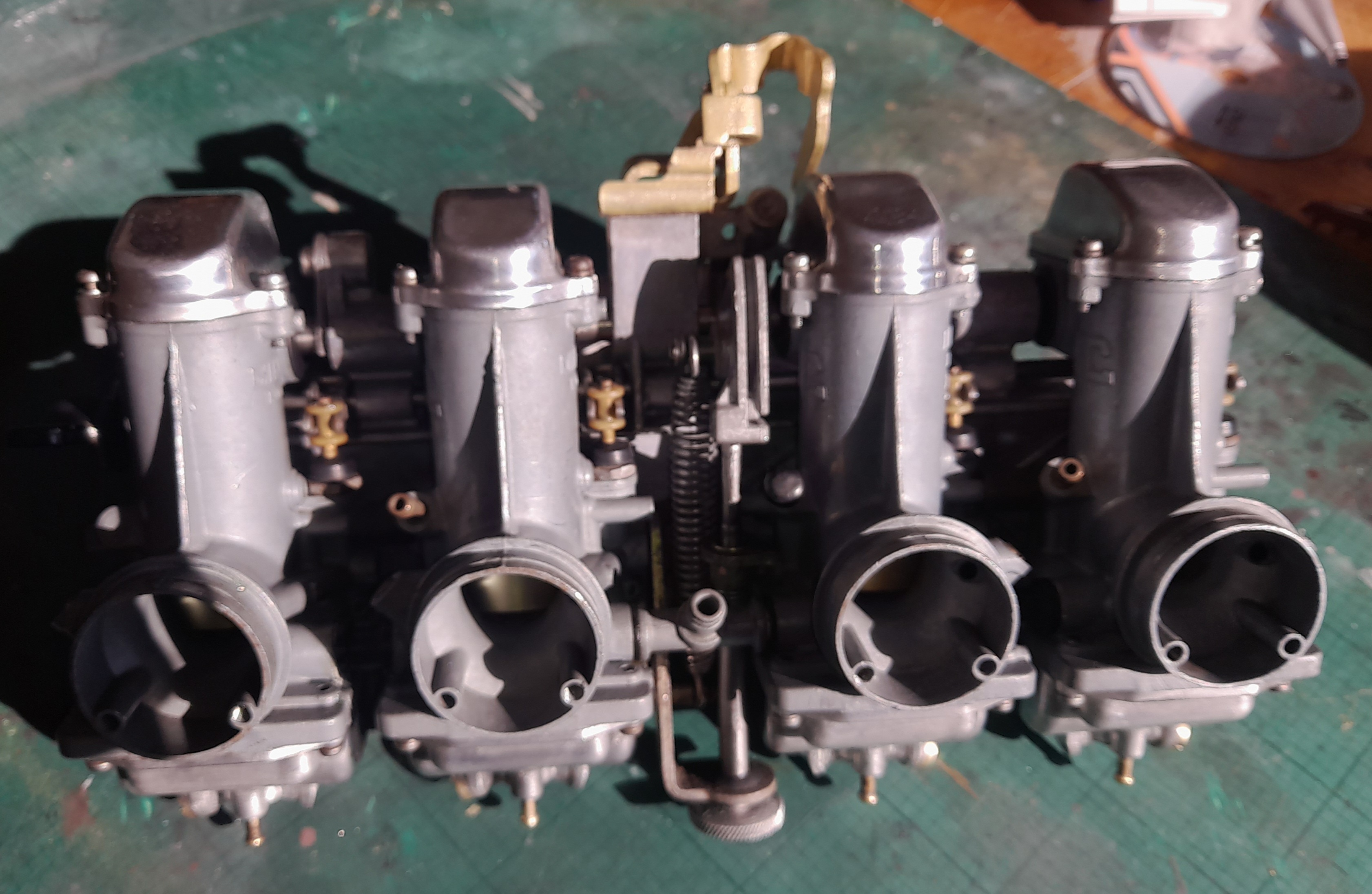

Hi guys. Just brought a 76 Z1 and trying to figure out what carbs these are originally from please? Thanks in advance.

If you wanna swop em out for some vm26ss which were standard for a 76 let me know.

A 76 is a z900 but those side covers are off a 75 Z1b, the carbs are Mikuni Smooth Bore 33mm.
https://www.ebay.co.uk/itm/325998677521

Thanks for the replies.
I thought that they might be smoothbores, result.!!
