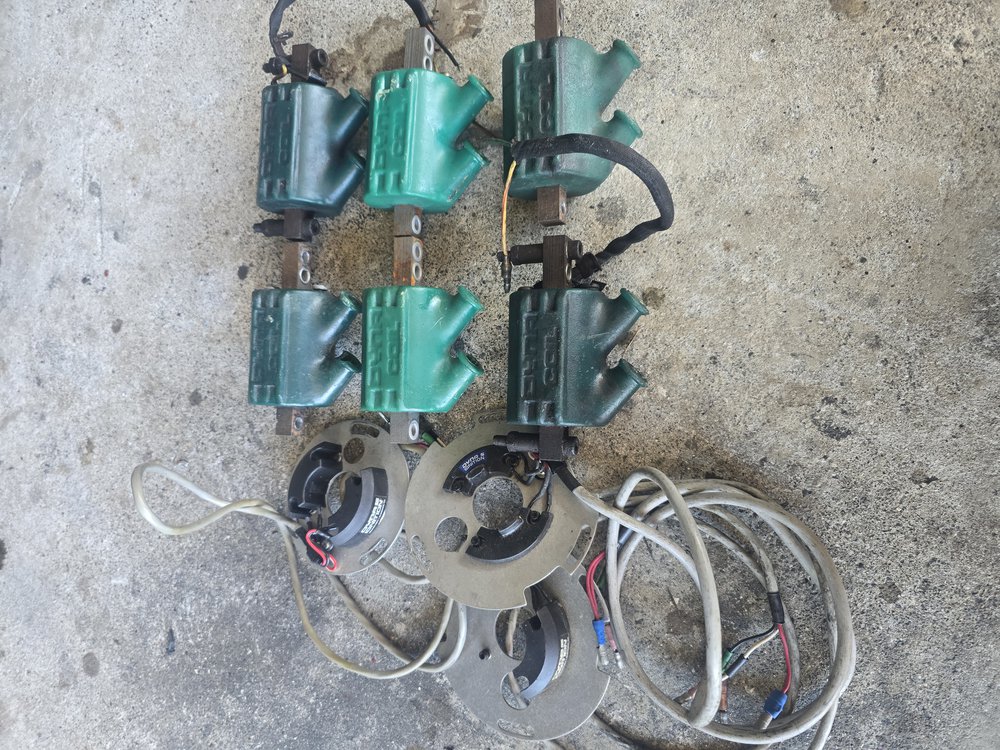

Here's a picture of a load of dead ones and I only have 3 bikes, steer clear I say.. oh two of them are still running Dyna ignition but
now with standard coils, it took all those dead ones to make them work!
