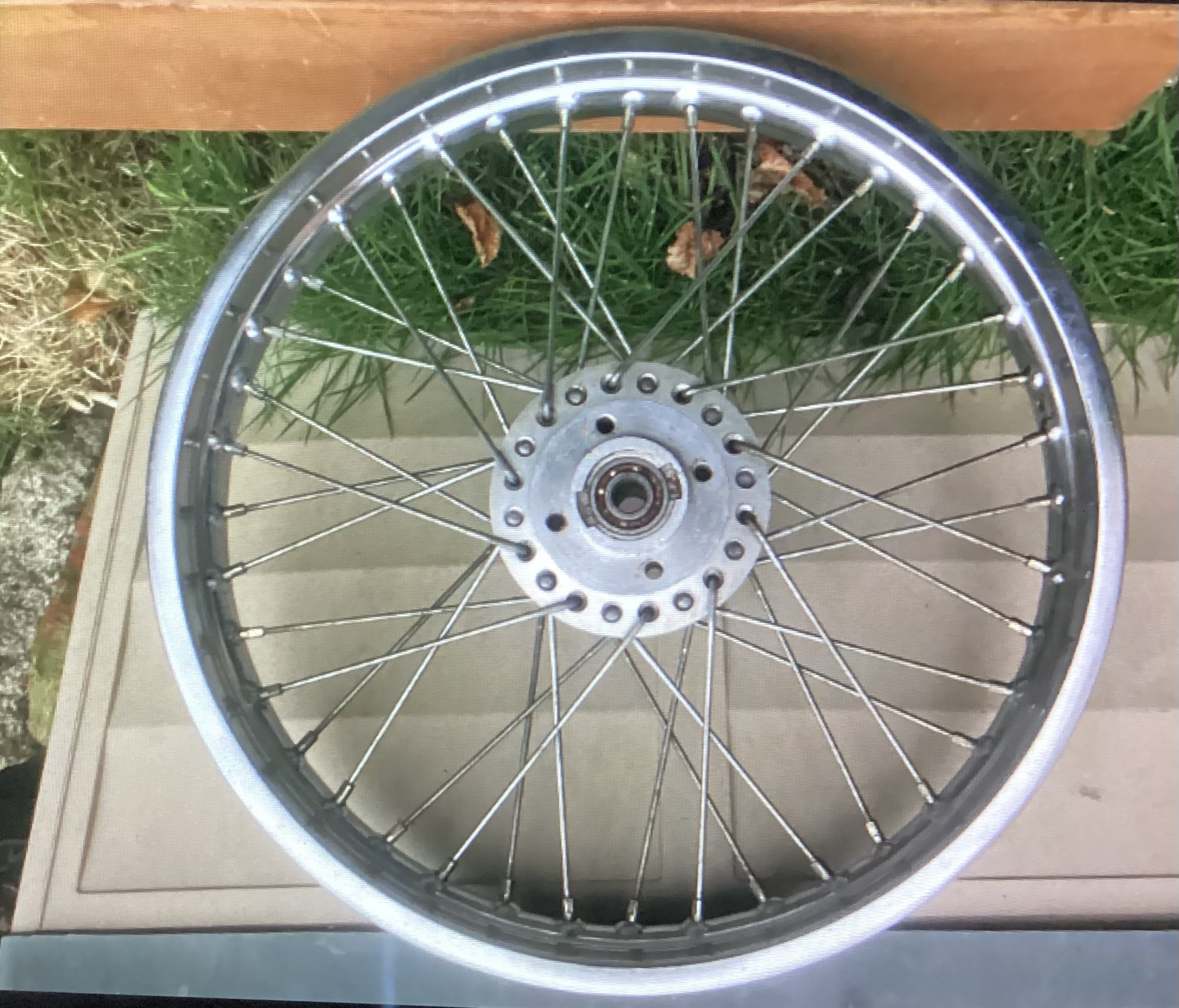

Pic. of built up wheel

DeadZedDave wrote:IMG_0539.jpeg
Is this an 18" rim Dave? What im looking to do is build a cafe racer form an 82 KZ750 twin Csr and a bunch of spares that are of no practical use to anyone right now. I want to run 18 front and back ( two 18 rear rims ) with matched tyres. Id like to get the frame, bodywork and running gear on by the end of the year and work on the engine over the winter.

Yes ! Thats an 18" front I used on my own Z1000 together with a standard 18" rear. Downside is its only a 1.85 which limits tyre size a bit. I ran the bike on it for a year or so back in the day though. Its actually just a KH400 wheel
As for using a rear rim on the front, I'm no wheel builder so I can't comment definitively, however, the standard 1000A1/750B rear hub has a much bigger diameter in the drive side compared to the front hub diameter and so far as I know this will have an effect on the spoke angles, which MIGHT BE significant for a chrome plated rim. Years ago I paid an old experienced wheel builder to lace up some alloy rims on some random hubs and afterwards he told me he had needed to re-drill all of the spoke holes in the rim to "correct" for the spoke angles - I think he said something about oversized spoke nipples too. At the time I wasn't too bothered - it was cheap as chips..... I doubt it would be these days though and if it needs done THIS way it'd best be sorted before you re-chrome the rim ! It would be good if someone else could confirm they've put an 18" rear on a front hub before ..... !
Sounds like a nice project though
Be good to see how you get on. You could always search out a KH400 front wheel and use that if you can make do with a 100/90 x 18 up front ( in theory eve this tyre is oversize on a 1.85 but it worked for me )
Good luck with the project ! (sorry my own wheel is not for sale !)
Dave

DeadZedDave wrote:Yes ! Thats an 18" front I used on my own Z1000 together with a standard 18" rear. Downside is its only a 1.85 which limits tyre size a bit. I ran the bike on it for a year or so back in the day though. Its actually just a KH400 wheel![]()
As for using a rear rim on the front, I'm no wheel builder so I can't comment definitively, however, the standard 1000A1/750B rear hub has a much bigger diameter in the drive side compared to the front hub diameter and so far as I know this will have an effect on the spoke angles, which MIGHT BE significant for a chrome plated rim. Years ago I paid an old experienced wheel builder to lace up some alloy rims on some random hubs and afterwards he told me he had needed to re-drill all of the spoke holes in the rim to "correct" for the spoke angles - I think he said something about oversized spoke nipples too. At the time I wasn't too bothered - it was cheap as chips..... I doubt it would be these days though and if it needs done THIS way it'd best be sorted before you re-chrome the rim ! It would be good if someone else could confirm they've put an 18" rear on a front hub before ..... !![]()
Sounds like a nice project thoughBe good to see how you get on. You could always search out a KH400 front wheel and use that if you can make do with a 100/90 x 18 up front ( in theory eve this tyre is oversize on a 1.85 but it worked for me )
Dave
Hmm.. didnt think of that, might have to butt up the nipples first then spokes. Iv done a visual there and there does seem to be angle differences. I could buy an aluminum set but that defeats the spare parts recycle and i have a DID 18 set but they are 2.15 and 1.85 and that messes up the matched tyre thing.. Rims are rusted chrome right now and will be black so thats not a concern. Lots to think about and thanks for all the info!
