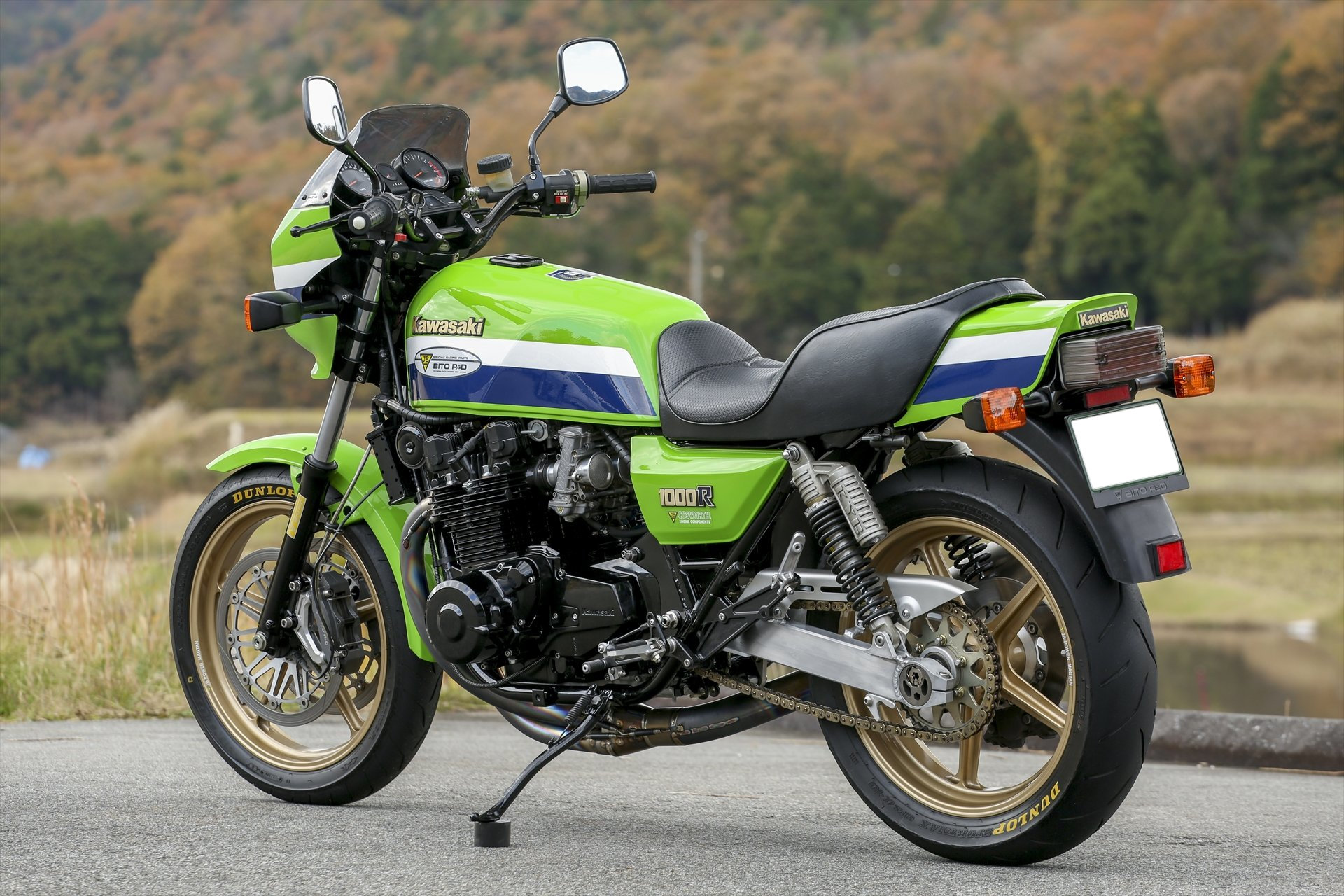

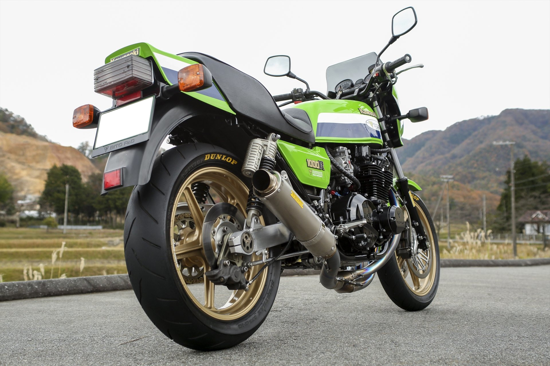

Rear indicators mount on the tail light bracket.

#3 PostAuthor: ADRIAN H » Fri Jan 10, 2025 5:52 pm
Pictures of the rear end, of a Z1000R - same mount on Z1100R

Rear indicator mounting method as already shown, same on all.
