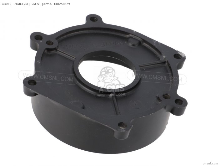

If it's this you are after, then it's specific to the b1 or b2, CMSL have two for sale.
Rob
Re: pickup housing
Cover, Engine, Rh, F.bla Kz1100b2 Gpz 1982 Usa Canada
fits:
Kawasaki
product number:
140251279
CMS product number:
KA0004.7881
GBP 222.04 ,incl. 20% VAT
fits:
Kawasaki
product number:
140251279
CMS product number:
KA0004.7881

Re: pickup housing
Hi Rob
Thanks very much for taking the trouble to reply with that info ,
Sorry to say my post was a badly worded and a bit misleading,
What i really would like to know is are they `Physically` the same ,
ie could i use a z1000j or z1100 casing
as there are lots about would be better for me because they are alloy finish not black and would be less work to make match the rest of my outer cases that are all polished alloy.
Very sorry for misleading you and i greatly appreciate you taking the time to help .
Regards
Mick
Regards
Mick
Re: pickup housing
They do both fit, however it depends what electronics you want to put in there, definitely dyna s doesn't fit as the b1/2 case is deeper.
However, looking at the part numbers for the standard pickups,they are the same across all of the later 1000 and 1100 models.
Rob
Rob
