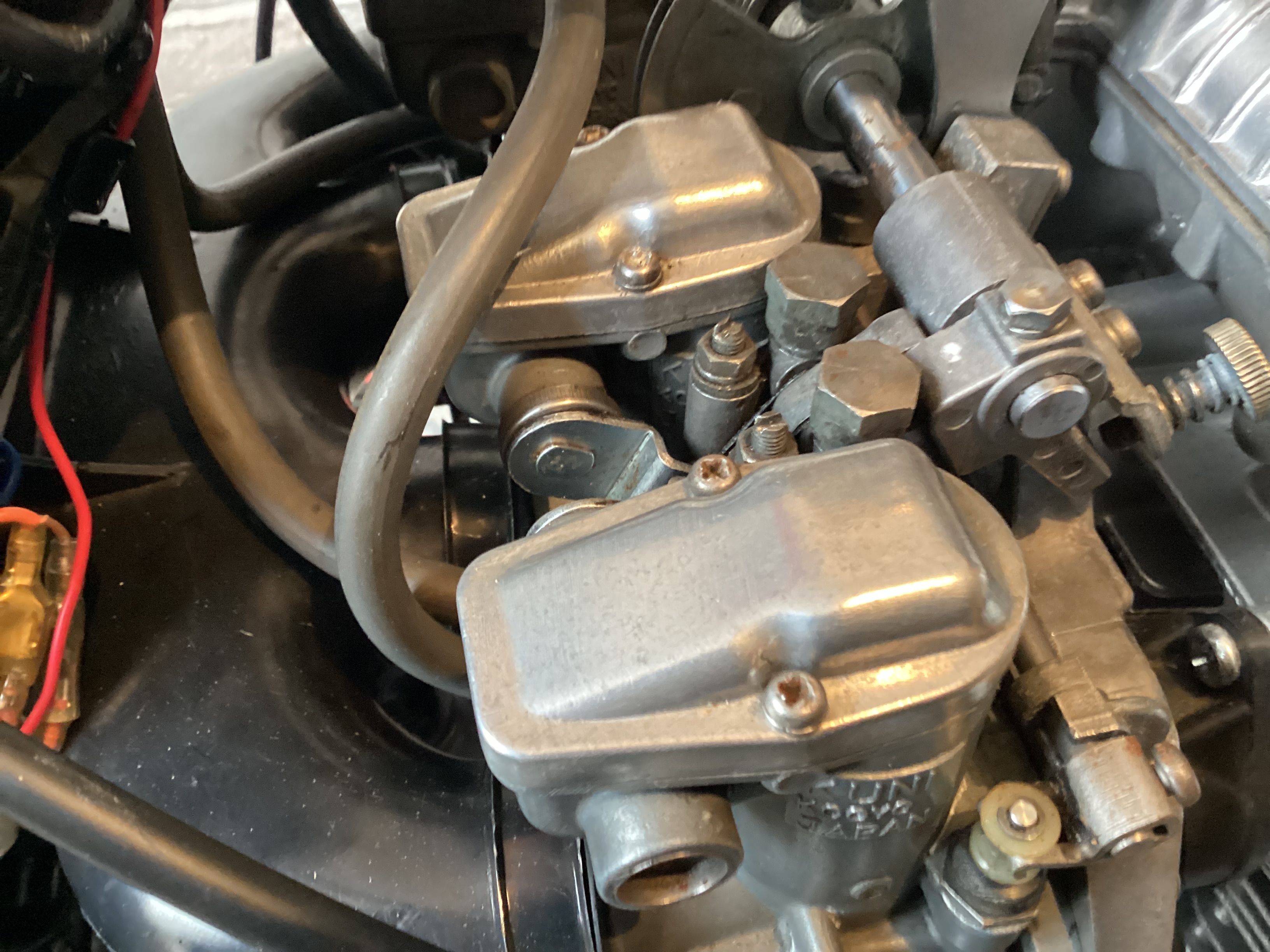

Hi trying to balance my carb with a Morgan carb balancer the problem is the large tickover adjusting screw is out in fact it’s not touching and my tickover is too high and I can’t turn it down what have I done wrong.
Should I have set them up off the bike first.
[attachment=0]IMG_0960.jpeg[/attachment]

You likely have one or more individual slide adjusters set too high .

I didn’t set them up before I put them on the bike maybe I need to remove them and do that. By slide adjusters I assume you mean the slotted screw with the lock nut on which I think I am right in thinking that’s what you adjust to balance the carbs unlike the later ones where you take the tops off this is a 75 Z1B.

Yes to the slide adjusters with lock nuts which are accessible without removing the carb tops and as can be seen in your pic the ones on #3 and #4 carbs are quite far apart regarding thread travel when there shouldn't really be more than half a turn or so difference unless there is something else throwing the vac readings out such as a manifold air leak etc.

put the vacuum balancer on it and see which cylinder has the least vacuum- that will be the carb slide that's too open ( and hence needing its adjuster adjusted)

Only early versions of the Z1 VM28SC carbs had a register carb which was number 2.
These have a plain cap instead of the screw and nut.
Later ones all had adjusters which yours should have.

All sorted now thanks for the help
