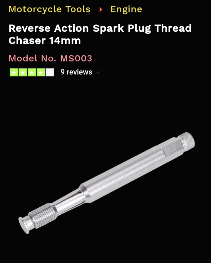

#3 PostAuthor: warren3200gt » Wed Nov 20, 2024 4:14 pm
This is what you want. Cleans the shit out as you unscrew it. [qu

#4 PostAuthor: Sparky63 » Wed Nov 20, 2024 11:04 pm
Thanks Warren, was about to buy one then realised that there was a helicoil in the plug hole that had partially removed itself as the plug was unscrewed.
