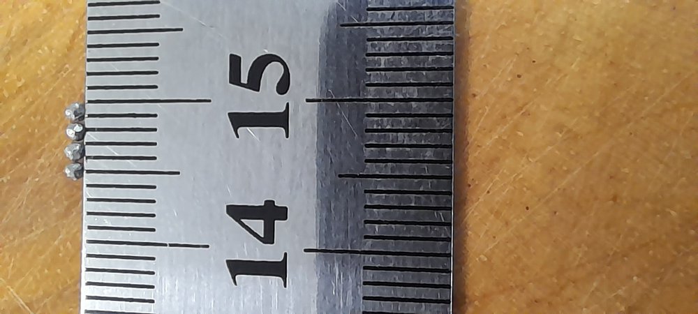

I drained my carbs off today and 4 alloy balls came out of number 1 bowl, never seen this before, they are around 1mm across and surfaces are quite rough, the carbs are 28mm pumpers that I put on around 2 years ago, they were sonic cleaned and flushed with solvent cleaner and followed with petrol then blown dry with air, they are not steel like the plugs for the drillings, was wondering if they are from the manufacturing process, these carbs had hardly seen any use and have no wear marks even.

Are they magnetic? (alloy/steel)

warren3200gt wrote:Are they magnetic? (alloy/steel)
First thing I tried was to put a magnet to them.

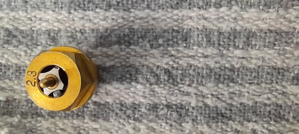

No octane boosters in tank, it's a tank I bought and had painted so completely cleaned and vacuumed out prior to paint, how would they get by the float valve, will put that theory to test this week as I have float valves in my parts bin.

This rules out coming from the tank, no way are thse passing through float valve.

are they defo alloy ? grab one with a pair of pliers and see if it crushes easy, ive seen things like this form from bits of grit and role about picking up material and forming a ball. it also happens in tubeless tyres.

Hard Road wrote:are they defo alloy ? grab one with a pair of pliers and see if it crushes easy, ive seen things like this form from bits of grit and role about picking up material and forming a ball. it also happens in tubeless tyres.
First thing i done followed by heating to see if it was lead.

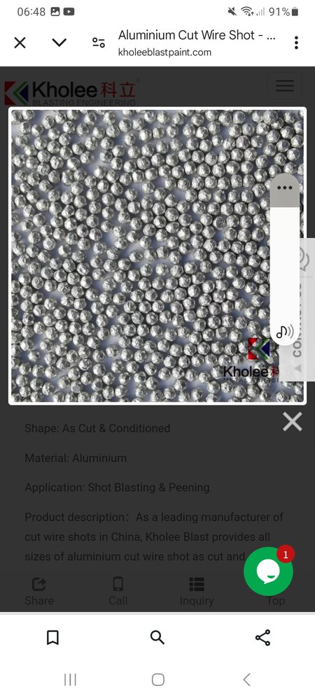

After lots of looking my conclusion is they have been in there since fettling in the original foundry, conditioned cut wire shot.

They could not have came from the petrol tank as would not get past the tap or float valves into the float bowls.
Also no way in for them through the intake side of the carb so I agree with you, must have been there from new !
