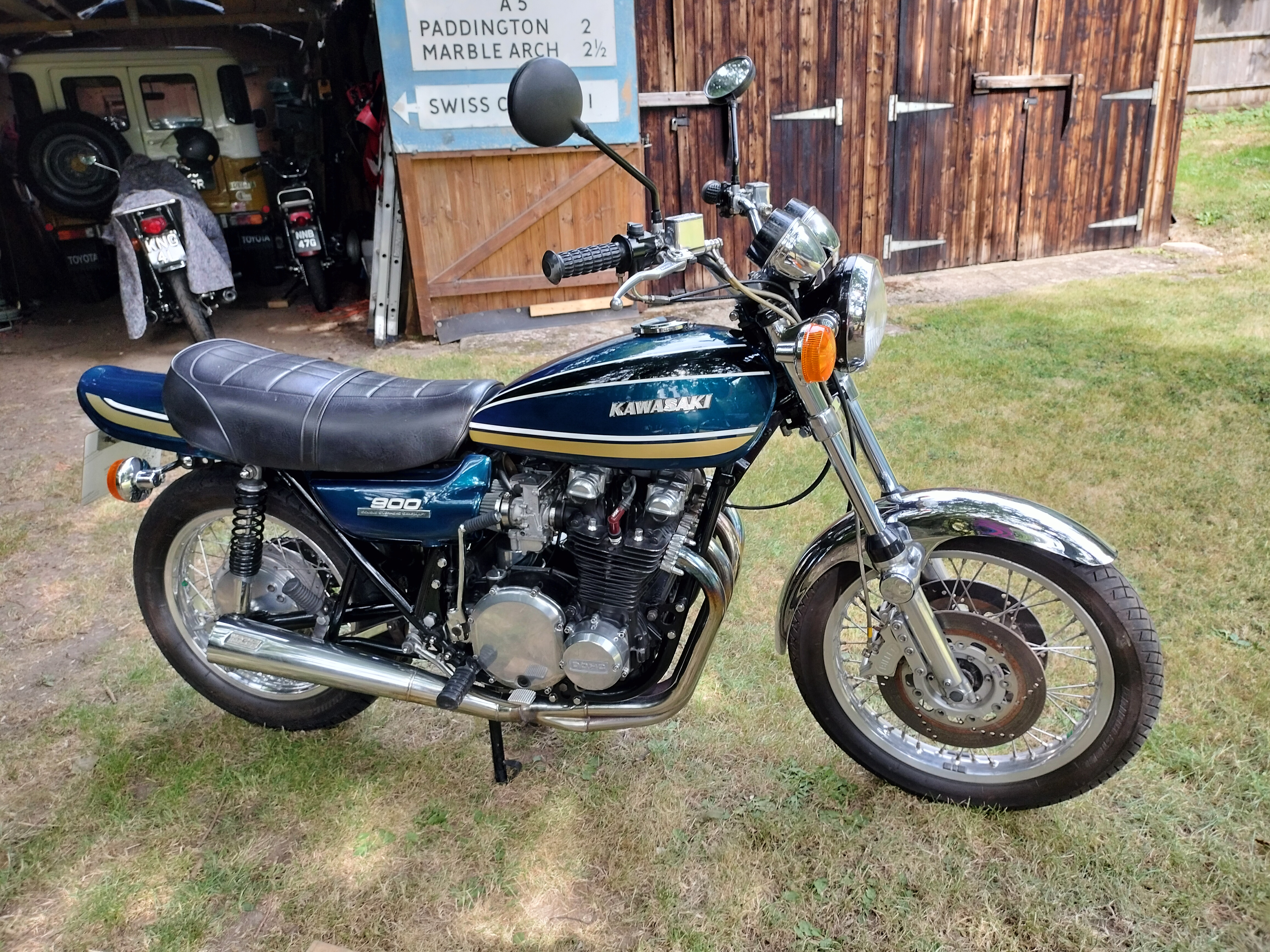

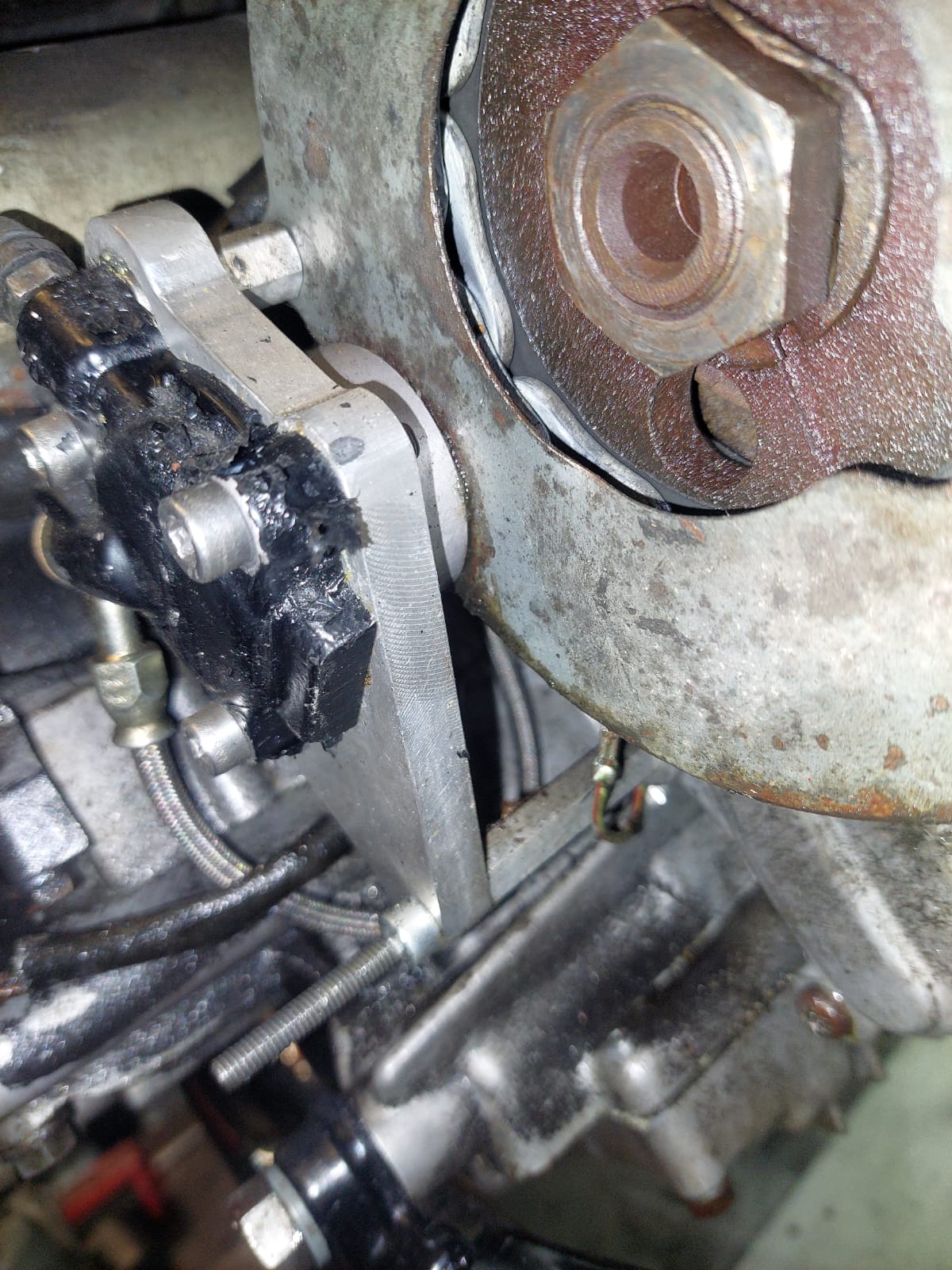

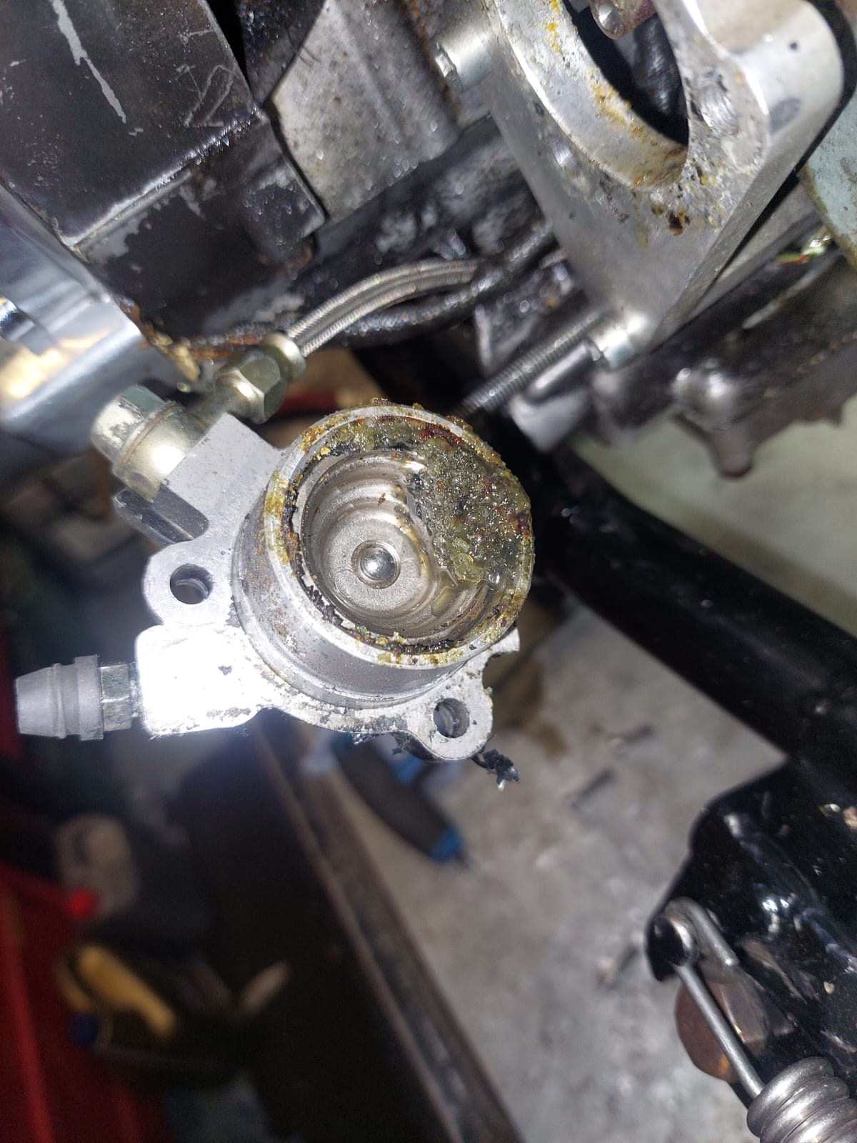

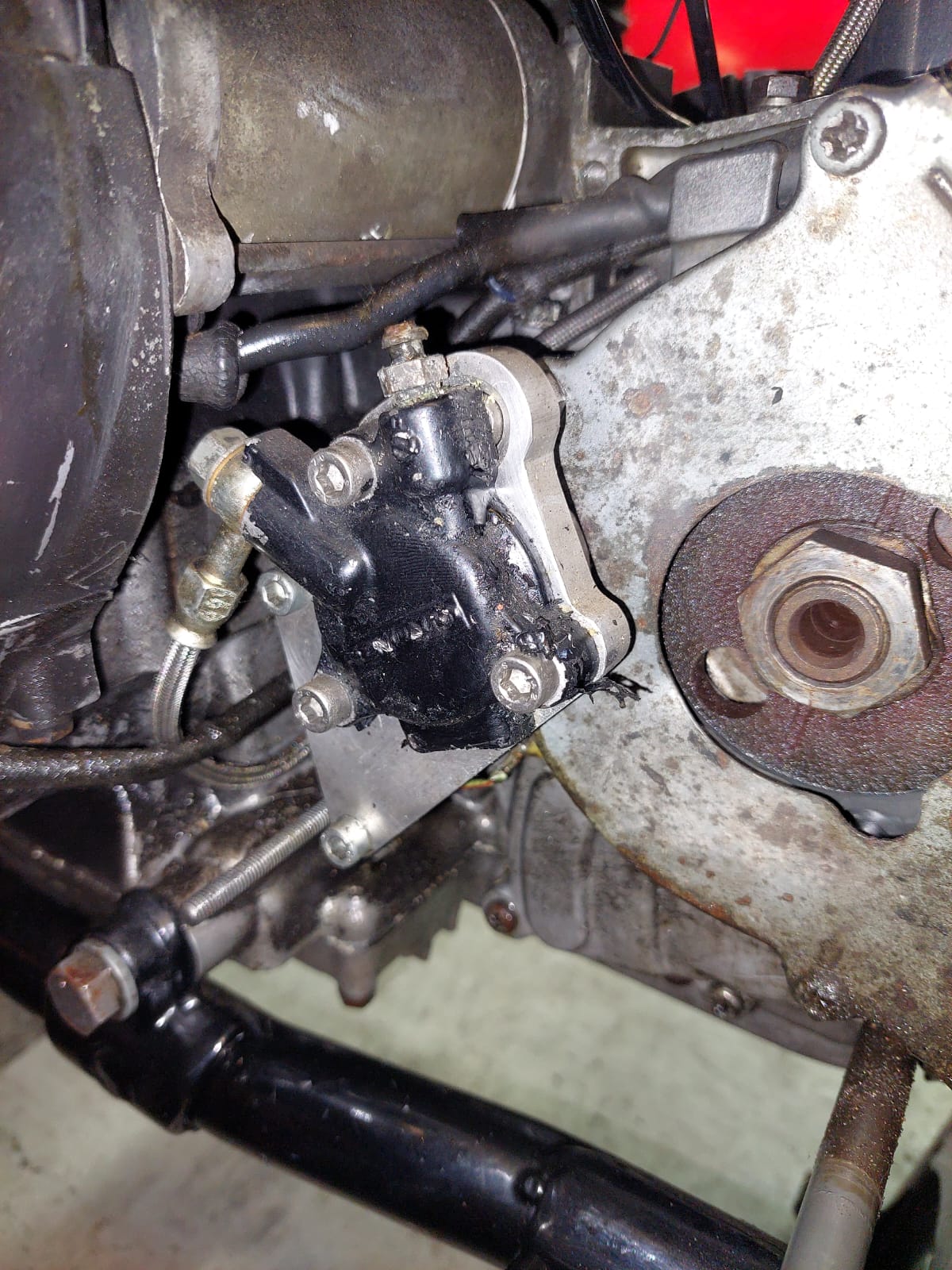

Help! Recently purchased a 75 Z1B that had all the mods we used to fit back in the day. Brembo twin discs/4 into 1 etc. It has an Hydraulic clutch and the slave cylinder has a failed seal. I can't work out the make or type to try find a replacement of seal kit. It looks very similar to a GSF1200
Can anyone out there assist in identification?

I've looked around and the Kawasaki ZX10 slave looks identical but still not sure.......... It's a three bolt fixing so yours looks like a 2 bolt
Thanks for the input Steady... Here's the Zed

The three bolt one is GPZ900R / GPZ1000RX/ ZRX1100-1200 / ZZR1100 / GTR1000 etc, etc, etc.

its a ZZR1100 D model slave cylinder

zed1015 wrote:The three bolt one is GPZ900R / GPZ1000RX/ ZRX1100-1200 / ZZR1100 / GTR1000 etc, etc, etc.
This is the correct answer. As I have a ZRX1200 one on my Zed.

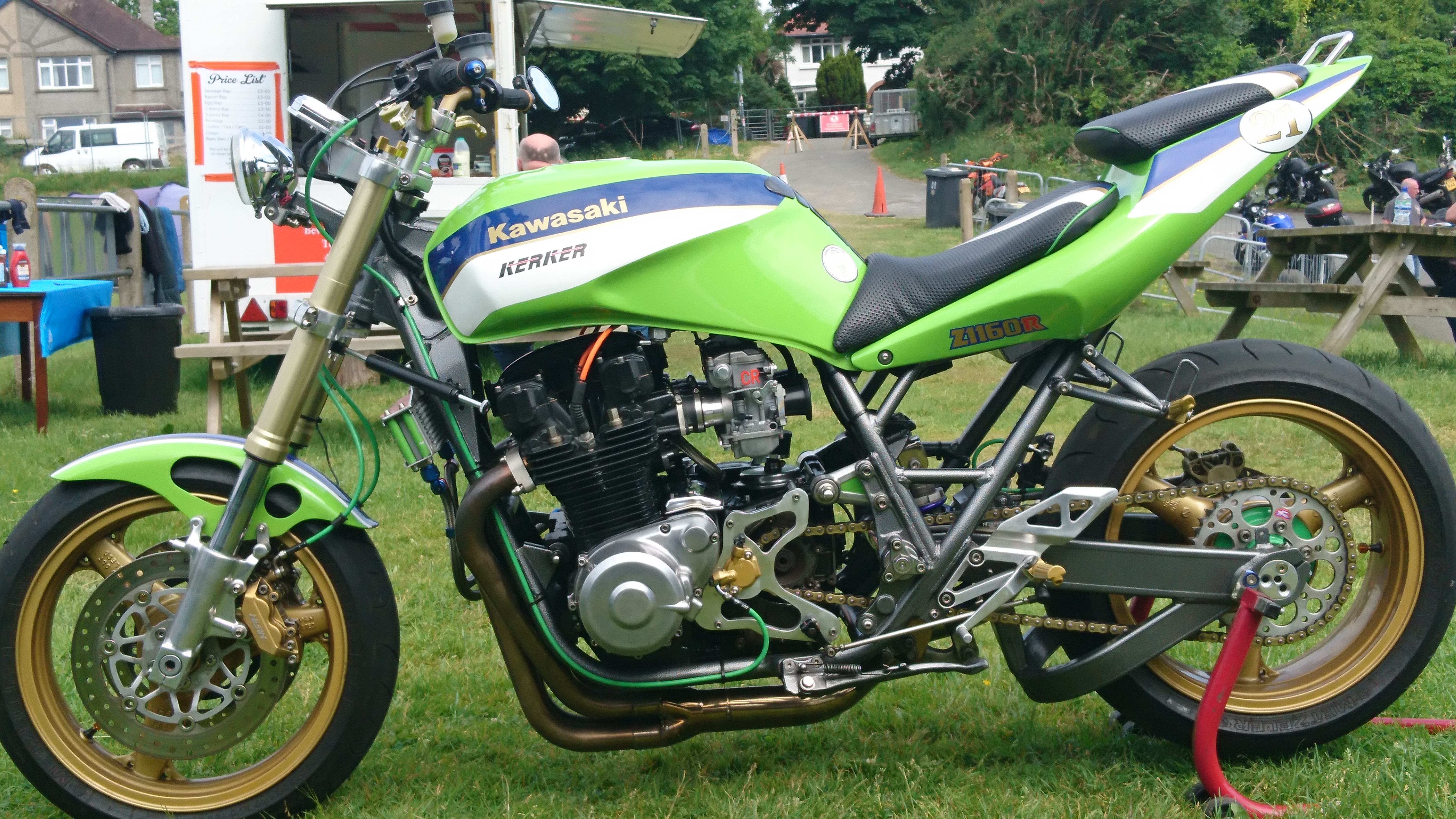

We fit these to the Z1300 as a modification.
As someone mentioned earlier, its the same as :-
