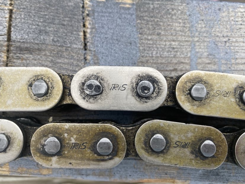

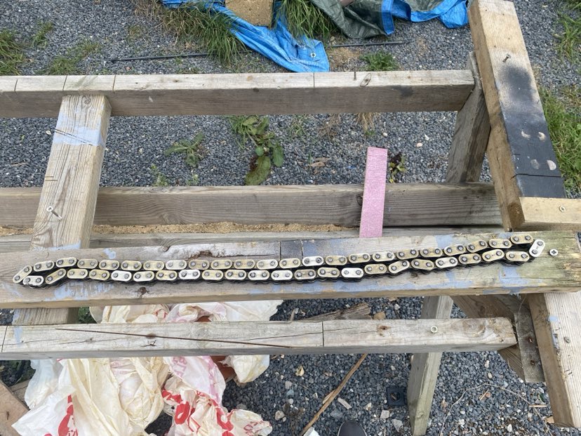

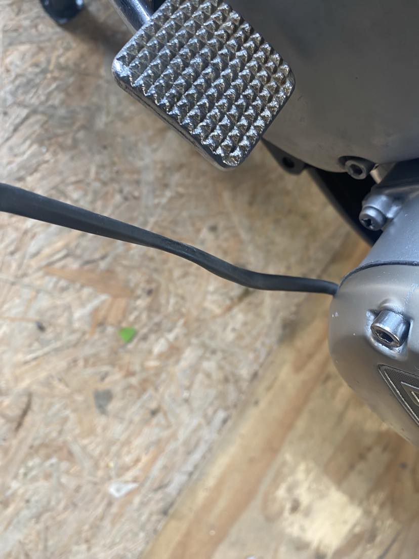

A couple of queries - first one is my chain, its an Iris chain in great condition and when I took the bike apart 8 or 9 years back I took it off. I am looking to put it back on again with much of the bike reassembled but there is no split link and circlip. Please see pictures - to fit it now I would need to remove the wheel and the swinging arm. After so many years I can't remember if it came off with the bike dismantled. So new chain or can I put a split link in or am I missing something please?

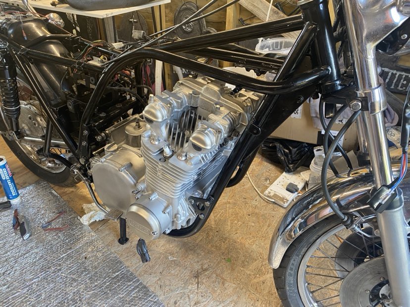

Next I spent a number of hours fitting the carbs and intake rubbers, what a job, no skin left on my knuckles, no wonder people put those external bell mouth air filters. That is done now but fitting the throttle cables to the carb is tough, the throttle open is ok but the return cable is really difficult as there is little room through the cable guide on the carb.

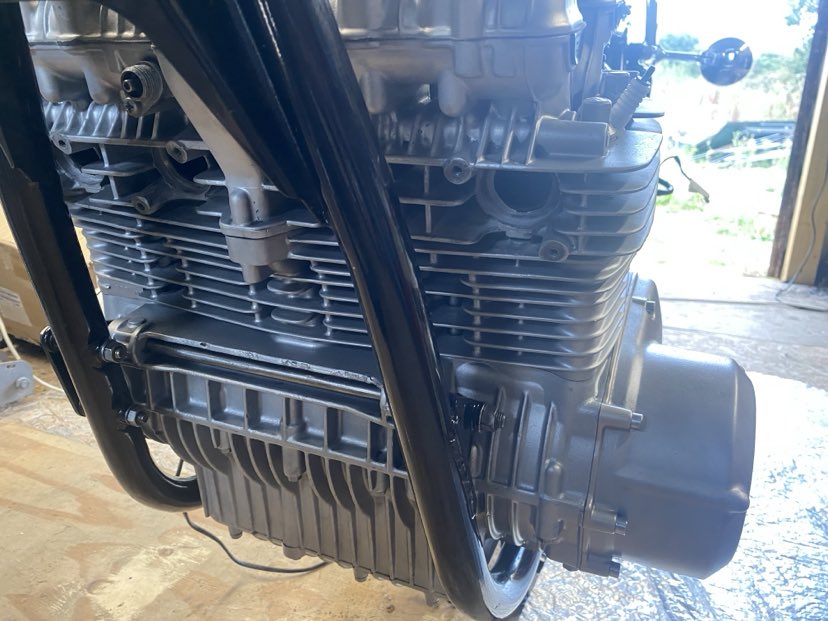

Next a few pics of my bike -

As regards the chain, rather than grind off the peened-over ends on the previous softlink, press out the pins of the softlink , fit the chain in place then re-fit a new softlink and peen the ends over correctly, it might be easier to remove the wheel, remove the swingarm then fit the chain over the swingarm and replace the swingarm in place, with the chain now in its right place. I know it sounds like a bigger job, but this way it costs nothing and its all stuff you've done before, and doesn't risk damaging the chain you have, by over tightening the new softlink .

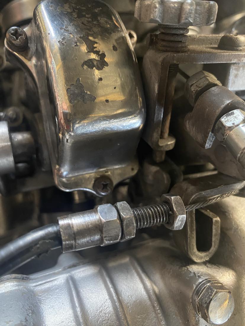

looking at your picture of throttle cables, on the upper cable you've got 2 locknuts both on the lower side of the cable bracket. There should be 1 above and 1 below - that might give you a little more slack to play with.
I find its easiest to run the locknut nearest the nipple completely off the threaded bit, that makes it easier to wiggle the nipple in, then fit the threaded bit into its slot in the bracket then slide the lower nut back up the cable onto the threaded bit.
Surgical forceps help to fit the nipple into the throttle quadrant , and I do the cable nearest the engine first.

Both points make perfect sense and thanks for your help with it, is the soft link the link with the two punch marks?

chain: remove the swing arm and put the chain over it, much better than removing the softlink .

throttle cables: start with the return cable and after that connect the opening cable, much easier than the way you did it.
make sure there's a nut on both sides of the guide .

yes the softlink is the one with the punch holes on it - they're there partly to mark it and partly to slightly weaken the tip of the pin so it can be peened over with a hammer once the chain side plate is on . The only bit that's "soft" is the tips of the pins, the rest of the chain link is hardened as usual. You can see that the ends of the pins have been peened over with a hammer in the past by the previous person to fit a chain to the bike. Softlinks are much better than split links - I had a friend with a GPZ1100 who used split links for a short period but got fed up with them pinging off under acceleration.

Nothing wrong with split links if they are fitted correctly. Never had one fail in over 45 years.

Also note that the previous peening was a bit overenthusiastic - the plate is such a tight fit over the pins that the pin ends only need to be peened slightly to make the plate secure. When/ If you come to do it yourself , use a small mole grip to clamp the side plates together from side to side ( just to hold it steady, not to crush it or the O rings) then light taps with the round head of a ball-pein hammer, at the same time having the side face of a heavier hammer pressed firmly against the other end of the pin, behind the sprocket. ( or use a special tool that does the job - they're not dear but can be cheap and a bit nasty so they break after a use or 2)

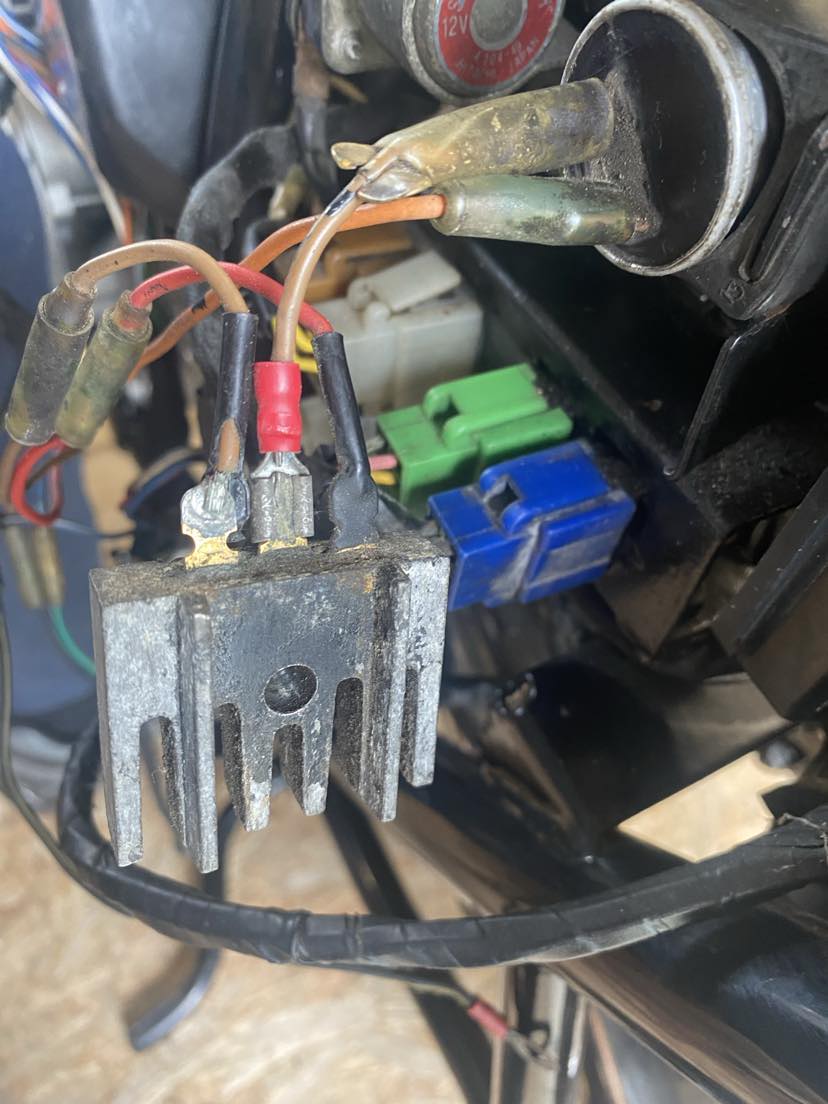

So am making slow progress, was alarmed to realise just how much wiring is packed into the headlight!!

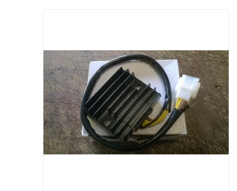

So am struggling with the regulator placement, I have a picture of one below.
have a couple more to post in and thanks for your help.
Re: Rebuild Queries and a couple of picks
Sparky63 wrote:Hi there,
It fastens to the bottom of the battery box where the original regulator is located.
You remove the rectifier which is mounted behind the LH sidepanel. The connect up as per diagram with the reg/rec.

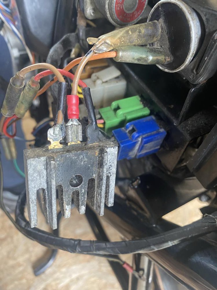

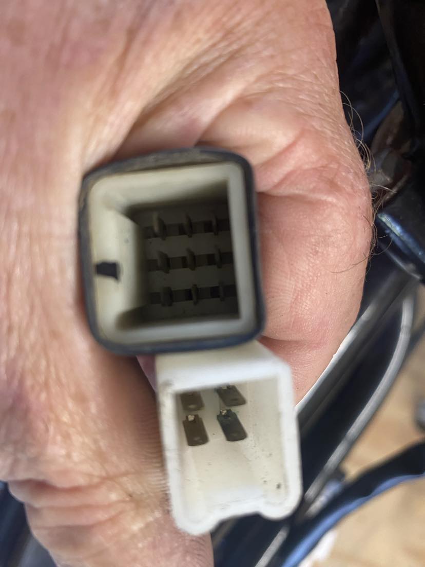

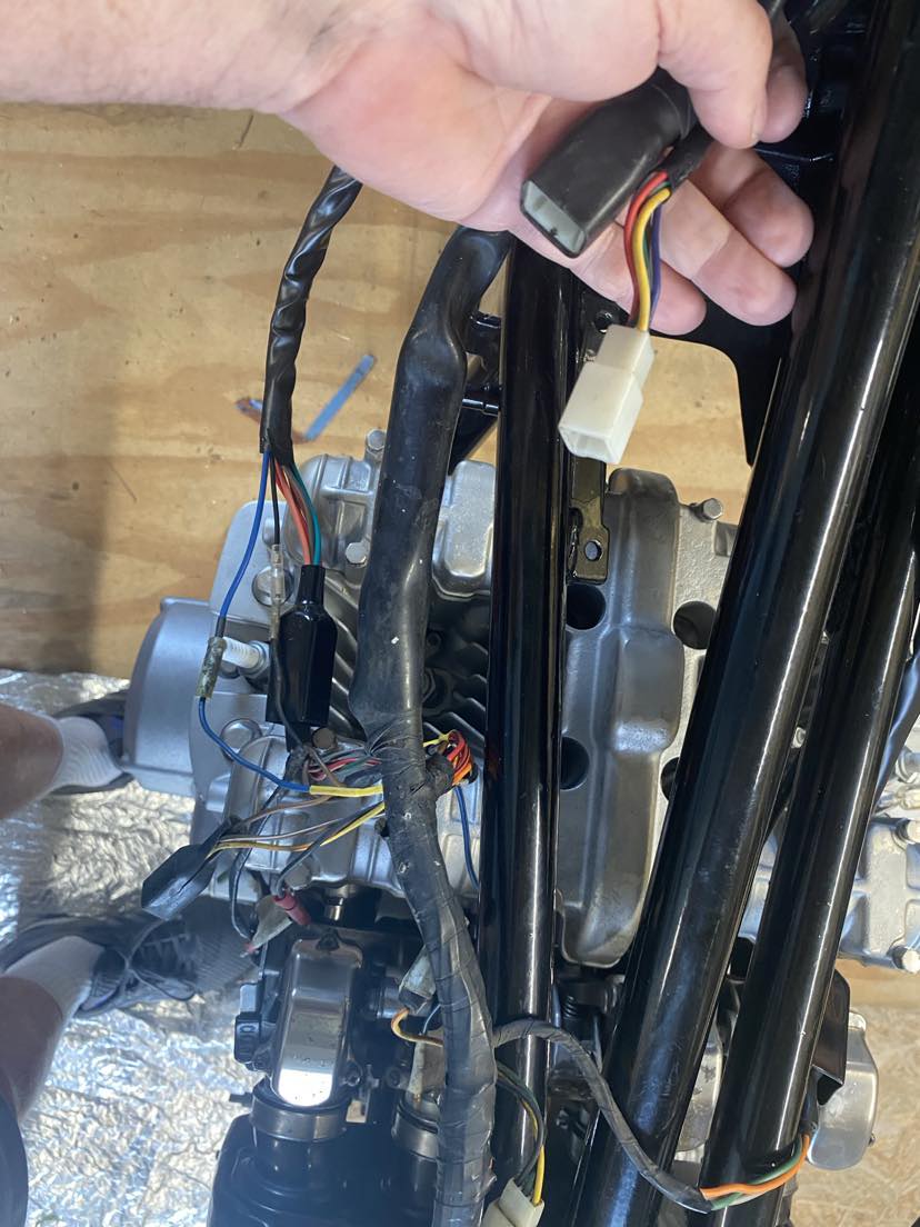

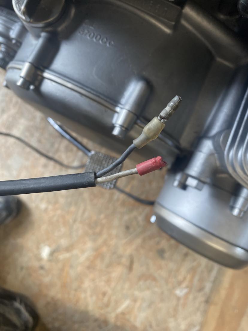

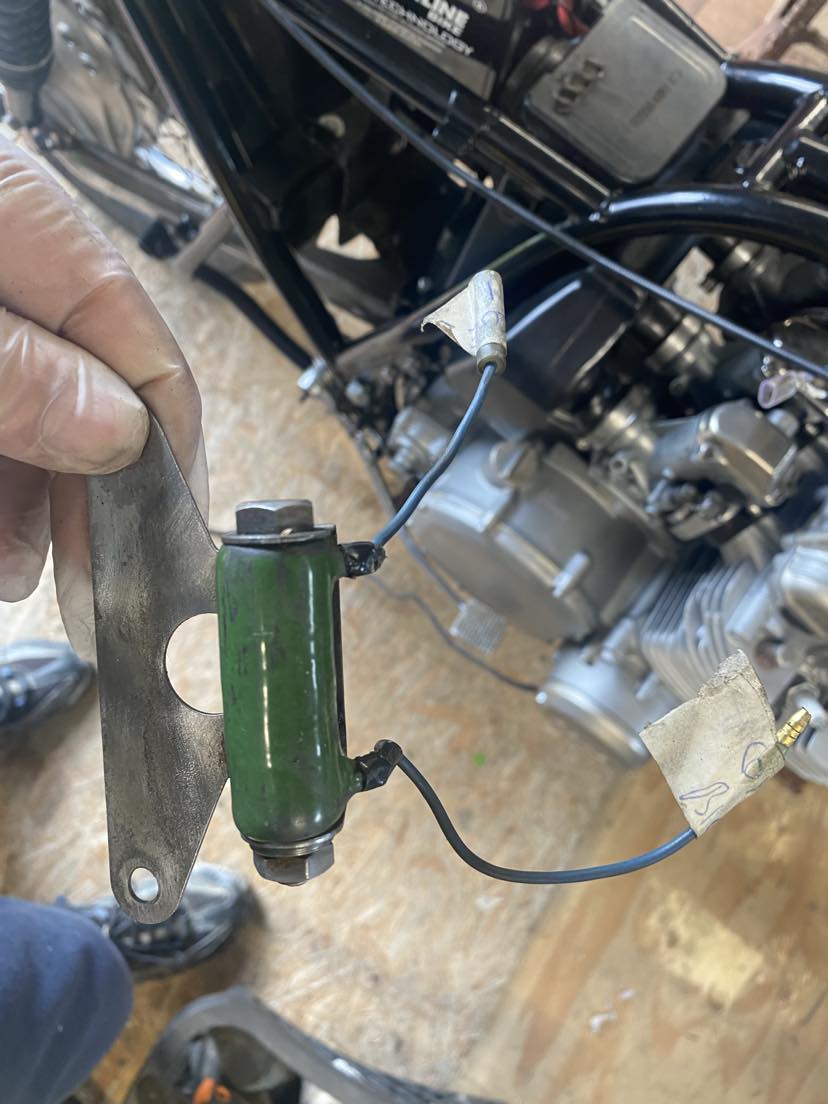

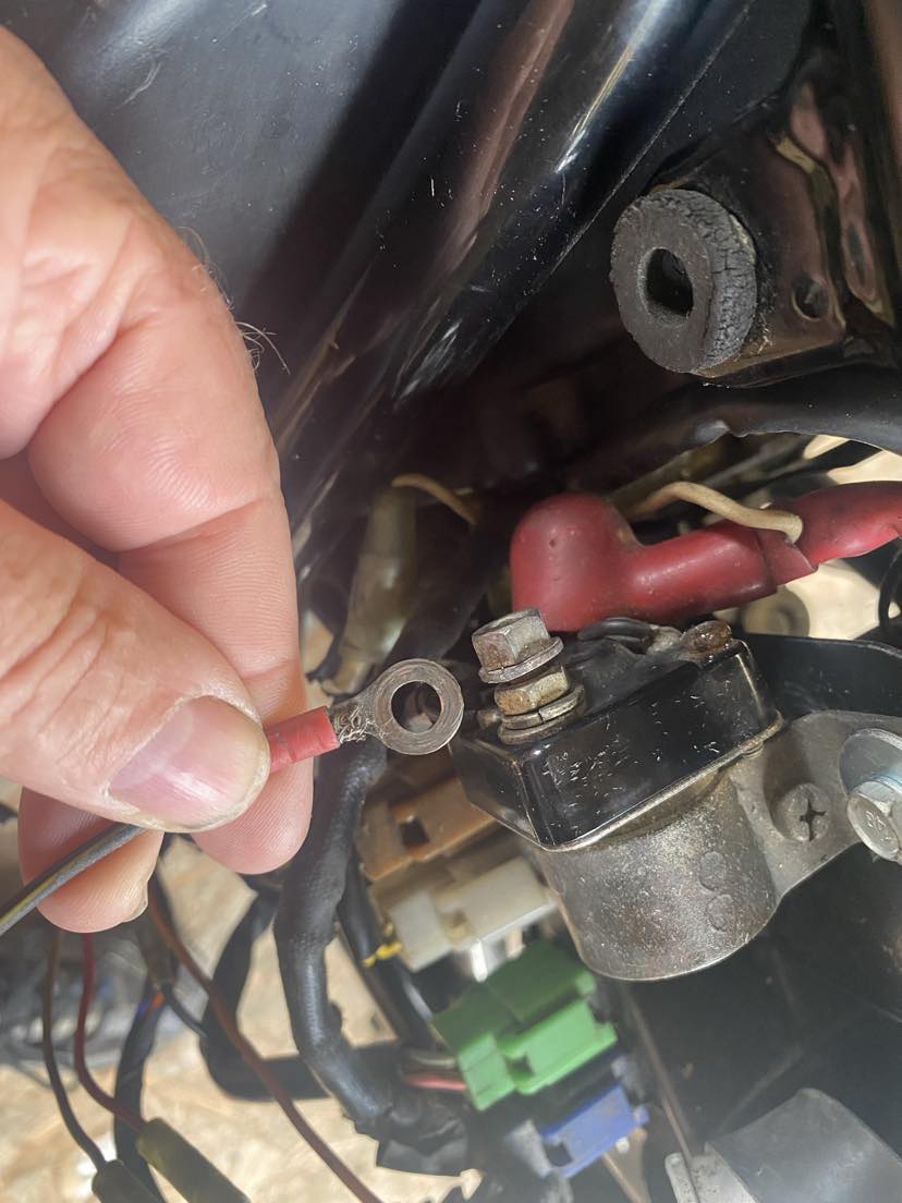

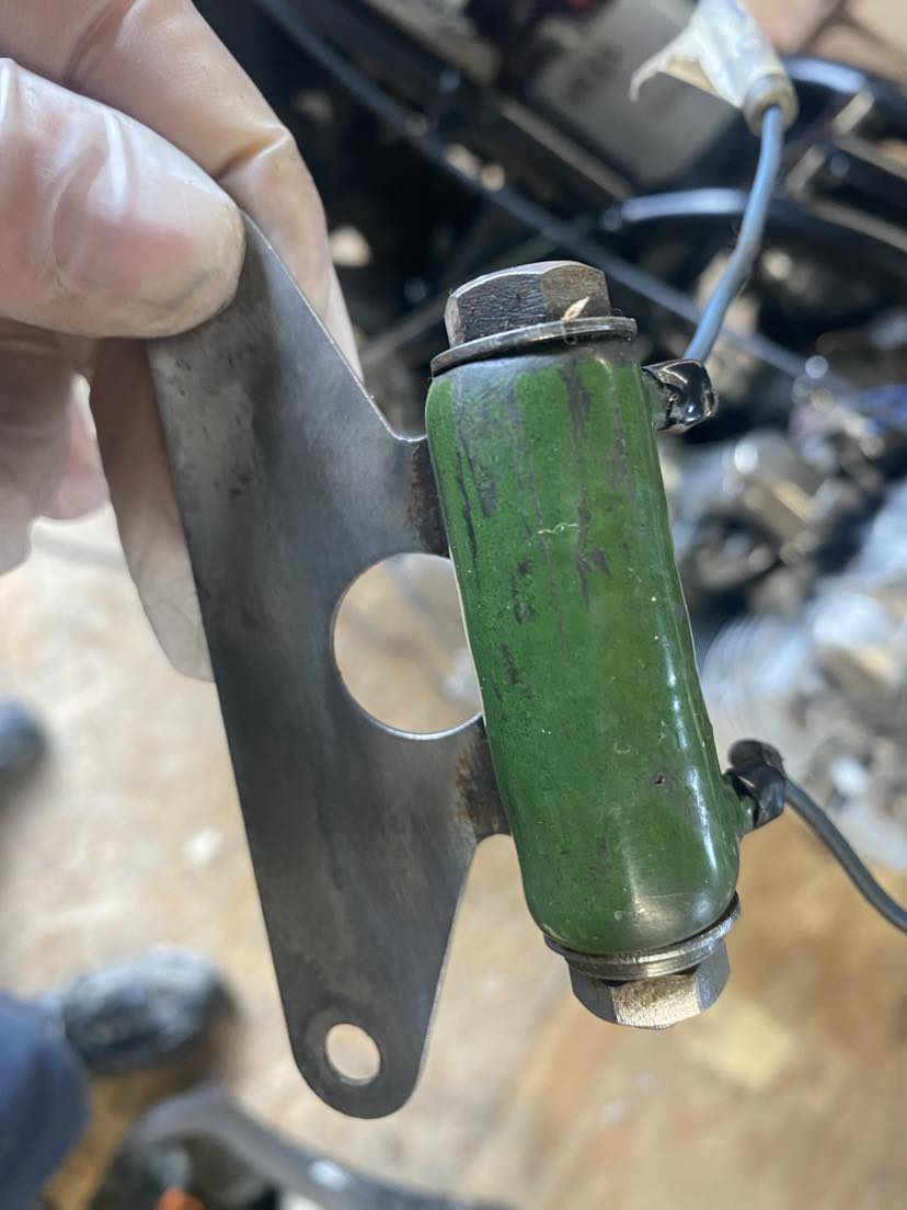

three more here - please
the correct suppressor placement with 2 blue wires
does this go here -
next one what does this connect to and the route please
thanks
does this go here -
thanks

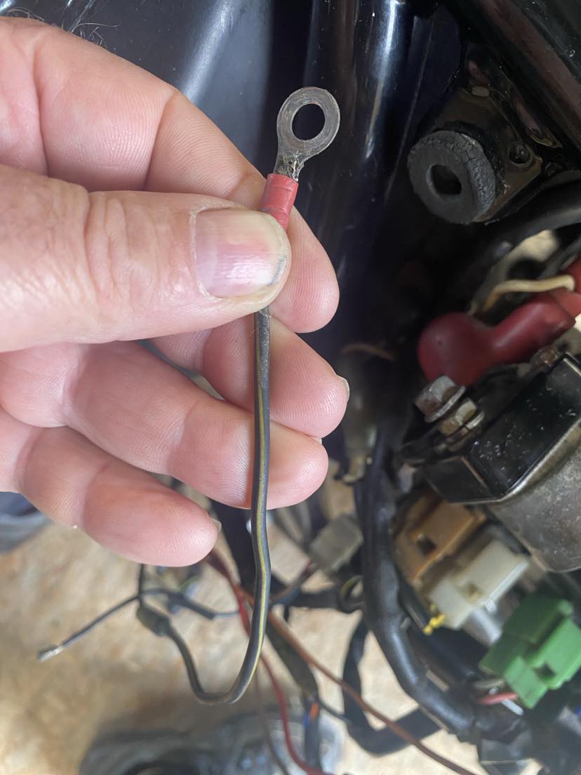

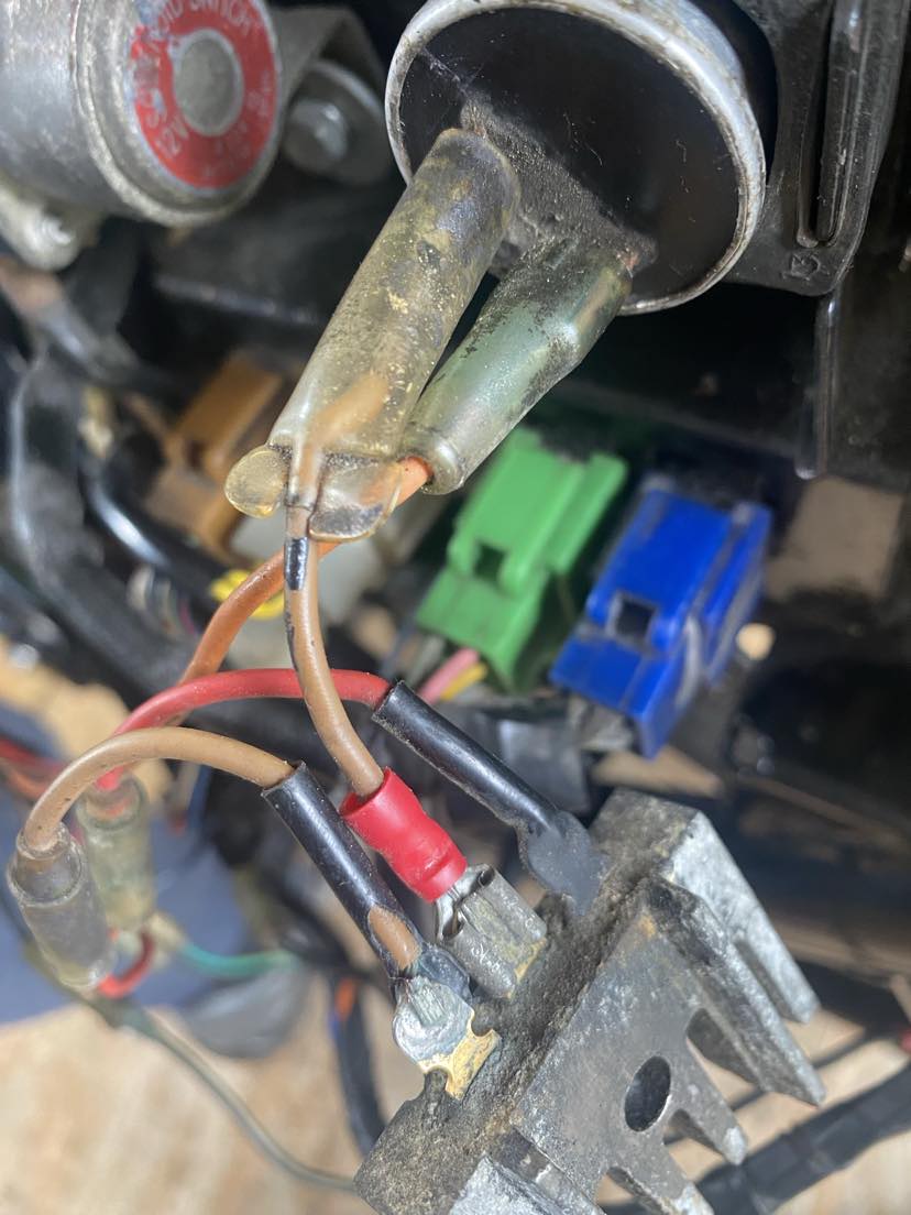

Thanks again for your time -
Is this another regulator it looks like it is attached to a flasher unit by wires but must be fixed by a bolt to the frame?
thank you for your expertise
Those are the hazard relay and Hazard regulator
