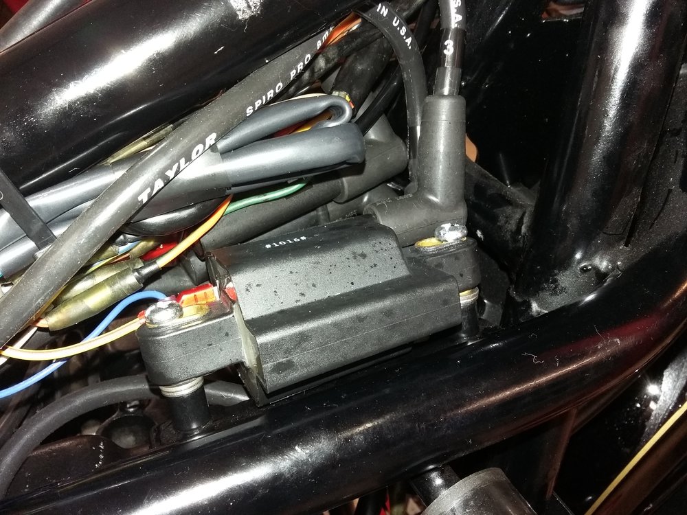

I've had excellent results with the Dyna "Mini" coils, fitting them to the last 5 Z1-R TC's I've built.
Mush easier to mount, no danger of arcing either, and they're also a little cheaper than the full size ones.
