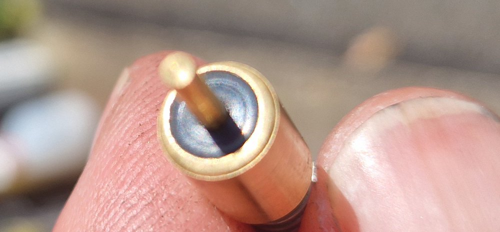

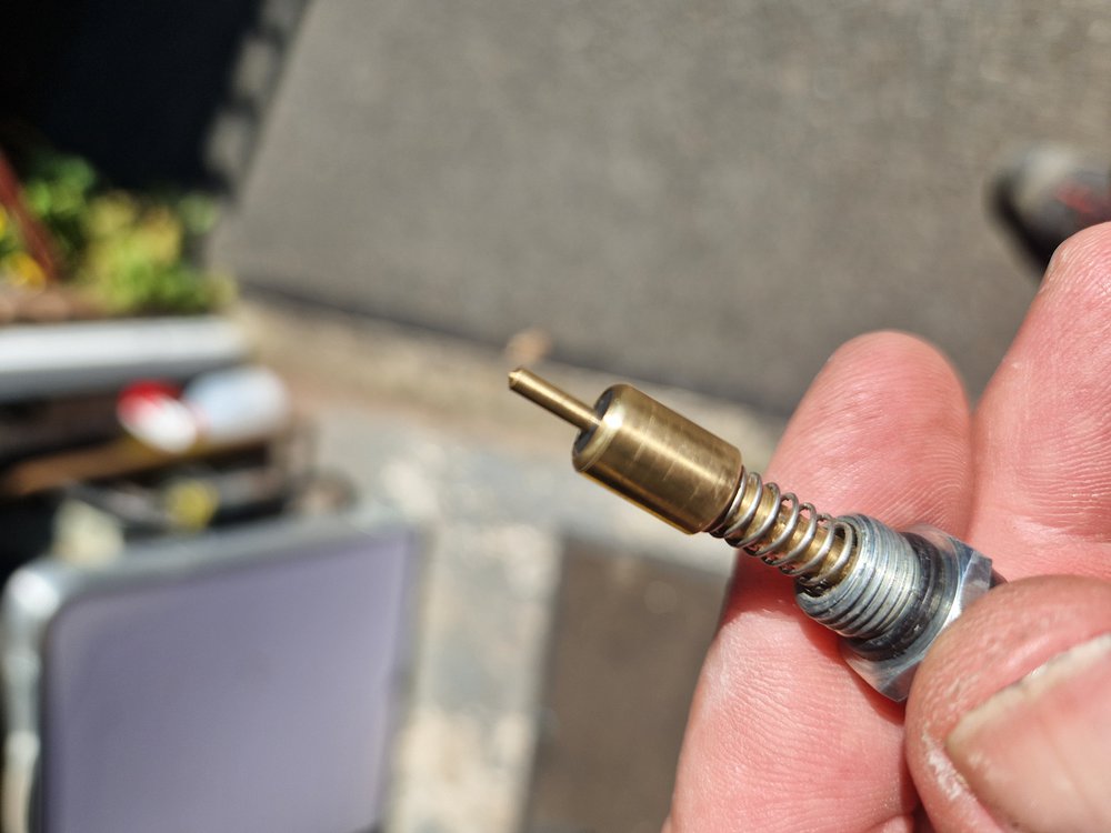

luckily I can remove no.4 choke in situ, new seal now looks like the one I replaced!
Re: Misfire no.4 cylinder
That looks fine to me - witness mark on the rubber surface suggests that it is sealing correctly

Did you change the o ring seals at the top of the plungers where they screw in. Critical to get a good seal there.

Yes, I sent the choke plungers away because I was convinced that was the problem. I'm losing the will to live taking these carbs on and off!

No not the plungers I mean the o ring where the plunger screws into the carb body.
An easy check on plungers and choke seals is to smear grease around the plungers before fitting. It'll seal the enricher circuit off from the running circuits. If the issue still persists its not a enricher issue. The grease seal won't last long as when you use the choke it'll gradually get washed off by the fuel cleaning it off.
